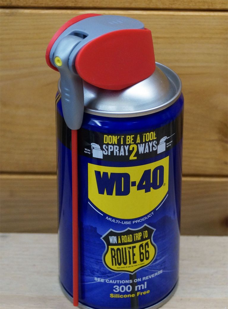

        Purchased a new can of WD40 yesterday with the new nozzle, quite impressed and an improvement on the old can. With the tube assy folded down it gives a wide spray through the yellow nozzle, pivot the tube to horizontal and it gives a finer spray through the tube.

          Can't say I'm a fan of those nozzles , had a few that leaked making the can pretty much useless. They have an o ring seal in where the nozzle swivels and once it fails it will leak lout from the swivel joint .

              I hope you got a good one ! The idea is good and it makes the can more versatile it's just that I have never had any luck with that style of nozzle – wasn't a wd40 can though but one of their offshoot companies like all in one or something .

                If you have a good top of this type on an empty can and take it off carefully it can be made to fit one of their "Trade Size" cans which are often a couple of quid cheaper with more in them than the fancy nozzle cans, quickly and firmly seating the top and depressing the button is the key, if you do it slow you get it everywhere

                        Those new ones are an improvement on the old ones where you lost the specially sized straw after first use – they were only held on by a rubber band(!). But I found the same old issue – the pressure only holds up for a while (6-12 months?), after which the contents are inaccessible without a tin opener.
