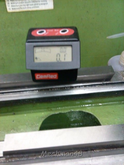

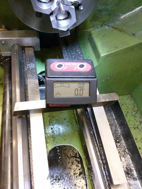

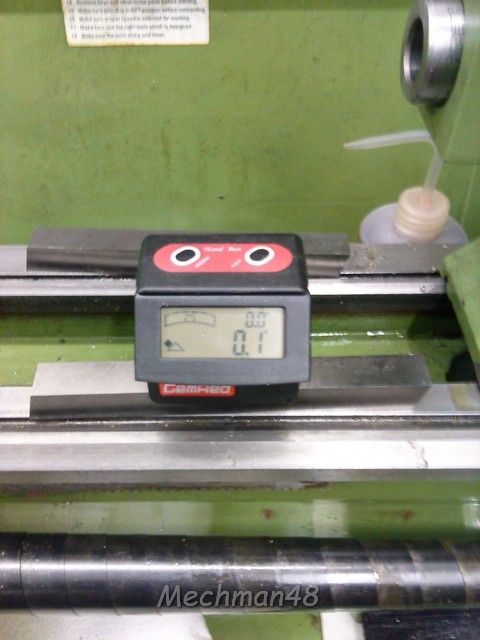

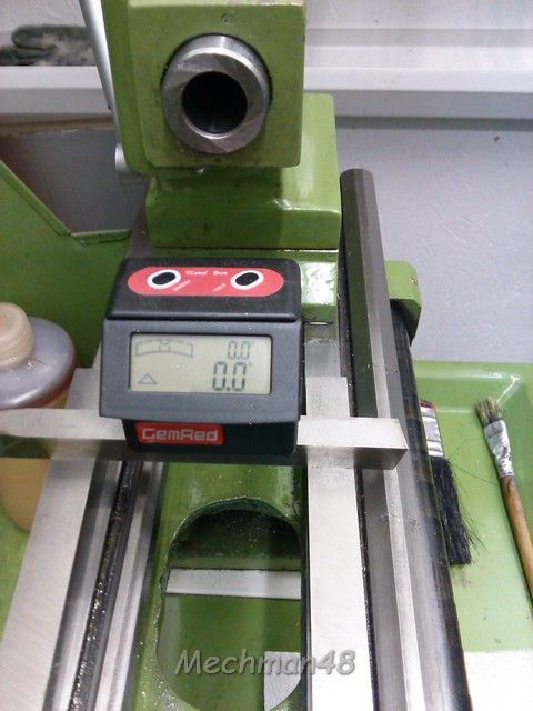

                Doesn't have to be 'level' in the sense you are thinking about, as long as there is no twist in the bed. Mine is set on the cupboards supplied when I ordered it plus sat on a couple of rubber mats on my garage floor & checked for level with a digi level, so far it hasn't given me any problems. I used a couple of HSS tool steel blanks to sit the digilevel onto front & back shears.
                Across shears at headstock end…

                ​…at tailstock end… no 'Twist'
                … Along front shear…
                …rear shear… lathe ' out of level ' by 0.1* along bed length
                ​Not overly concerned by 'out of level' by that minute amount… just happy that bed is not twisted.
