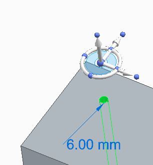

You can learn a lot from simple exercises, here is an easy one to introduce a few concepts in Solid Edge.
This exercise has introduced a number of the constraints available in Solid Edge.
The next post will create a 3D body using a single SE command.
Gordon

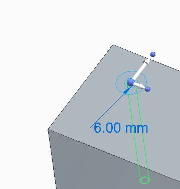

The above was used as an introduction to the creation of a 3D object and using some tools and constraints. Now to do the same thing in a sensible way
Continued on next post
Gordon
Continued from previous post
You will have seen “Steering Wheel” appear as each hole was created. This is an incredibly powerful part of the synchronous environment.
You are now started on the pathway to the creation of your compound steam engine cylinder block, and I'm off for a rest!

It works this time, and I now have a grey block floating through the datum plane. I observed the relationships signs appearing on the rectangle.
Nigel,
I have used the Sketching Tab to draw my shape and it gives the same results as using the Home Tab, Wlll have to adjourn until tomorrow. If you have some spare time, to make things easier, please could you repeat the excercise, opening a new Iso Metric part .,par while recording a Video. The video does not require any equipment or software, it is all done within SE. The instructions are below
I will PM you my email address tomorrow, if you send me a video of the screen while doing the excercises I'll be in touch in the afternoon
Gordon
B******, just seen your reply, glad it worked, shutting down now..
Edited By GordonH on 17/05/2022 00:03:47
Edited By GordonH on 17/05/2022 00:04:23
I'm following along too, and finding the exercise useful. Even though I'm well into learning SE, Gordon's approach highlights other ways and means I was aware of but not exploiting, probably because I'm unconsciously following a method learned on am early version of FreeCAD. Old habits are hard to break!
A few observations:
As mistakes are likely, useful to know that typing ctrl-z undoes previous steps, and ctrl-Y is redo. (These are standard Windows shortcuts.) Undo and Redo are also available in SE as buttons (curled blue arrows)
Gordon refers to the 'Steering Wheel' tool which happened to be semi-hidden on my screen:
It can be moved to show the whole by pulling on the centre blue ball with the mouse,
I'll leave it to Gordon to explain how the extremely useful steering wheel is used!
Lastly, moving the hole command didn't wake up the edge ends and centre as expected, and as shown in the Hole animation. Odd, because this is the only time they've not appeared. They do appear if I hover one of the draw commands, like line. Sod's Law strikes again.
Keep up the good work
