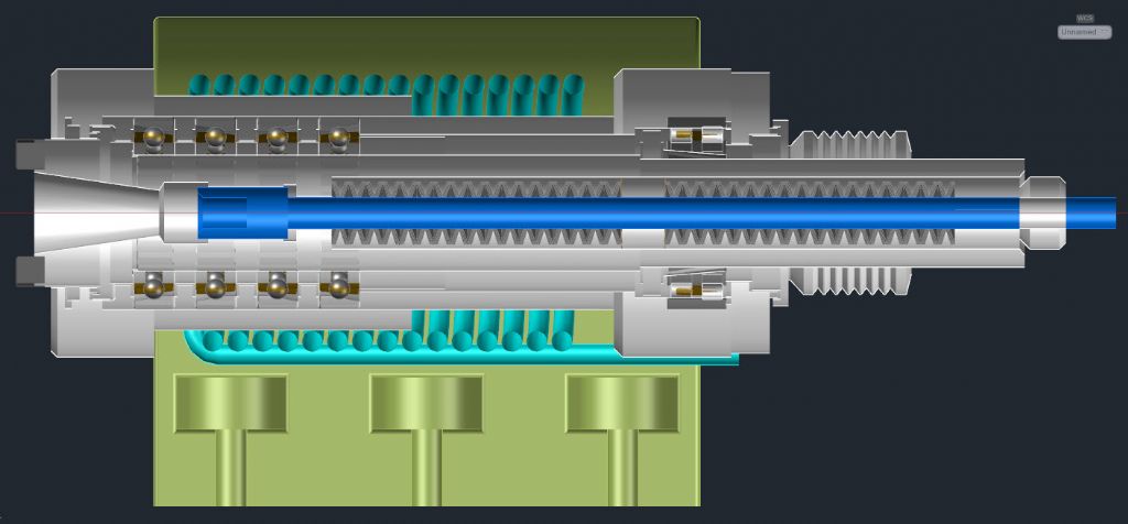

Spindle Design. Only a draft but 90% of the design work is completed.
BT30 ISO Machine taper quick change pull stud system (Air actuator cylinder not shown)
ISO 30 is the smallest of the commonly used machine tool spindles (HSK a newer system is becoming more popular but tooling is harder to get and more expensive)
Water cooled for higher speed operation (Very few commercial spindles have cooling) This is a Plus.
At least 12,000 RPM (With low cost commercial bearings) operation, other commercial spindles using 9009 size 45 x 75 x 15mm 15 DEG angular contact bearings 15,000 RPM using high accuracy bearings. The Rear bearing is a dual row tapered roller (Tapered bore also to set the clearance).
I have allowed for Grease lubrication only. pressurised oil mist lubrication could increase the speeds by maybe 30% but a lot of work to do and the oil mist has to be dealt with it is a health hazard. The water cooling makes Grease work at higher speeds It will be interesting what sort of temperature rise we get?
If same size steel race ceramic ball "Hybrid" bearings are substituted, over 20,000+ rpm should be possible. More expensive.
Spindle body can machined from heavy wall tube And a small amount of bar sliced for the ends or bar stock depending on what is available in a makers shop..
The lightweight steel spindle is wound with water cooling tube metal epoxied on first, it is then is cast into a steel reinforced mineral casting. Mineral castings have higher damping than cast Iron. The casting can be modified to attach to an individual makers requirements easily.
The spindle body can be machined in two parts To assist builders with smaller lathes.
Not shown is a turned between centres mandrel….. not fancy just a piece of scrap bar coated with automotive body filler then turned in one setting to locate the two steel body sections and keep their axis perfectly in line while they are being glued together, it will be discarded when the main casting has been poured around the spindle body.
Formwork for the casting can be made from available material MDF wrapped in polythene works well and it does not stick.
This is not an east job to make; a fair amount of lathe work and grinding if a machine is available, or hand Lapping, Slower but doable.
The spindle nose taper will be ground in position after the spindle is completed.
The drive system planned is a 3 KW 2800RPM motor with VFD I have only shown one pulley but two would be better Maybe 3.5:1 geared up and 3.5 to one gearing down.
allowing for a VFD motor combination that can work effectively between 25 Hz and 100 Hz should give a reasonable torque at the lower speeds and the higher speeds required for small end mills.
The readily available ER Manual hand tightened collet, Chinese high speed spindles loose power at lower speeds.
I already have a set of bearings and the epoxy I will have to hunt up some steel and the Belleville washers.
I will have to buy a length of pre hardened (machineable) steel bar for the spindle itself.
Its a pity I don't have a cylindrical grinder, that will keep me busy lapping it to size.
Its getting close to dirty hands time…..Always fun.
What do you think?

..watercooled…
Yep..Mazak machines do that…also “wrap” the spindle motor round the spindle….
Very very agile.
Just don't have a watercooled machine in an unheated workshop, I know of someone who had a watercooled router spindle that cracked in cold weather over the weekend
Water cooled in unheated workshop….
Mmm guess thats why mazak used antifreeze. ….now if you want to talk about water freezing in the air mains…then yes it can be a pain
As does the coolant…now thats a real chore to thaw out….

No coolant with the ceramic toolbit?? Amazing cutting and finish.
15000rpm sounds pretty fast. You will need to make sure the rotating parts are very well balanced, including the tooling – how do you plan to do that? The tool holders that are balanced for that sort of speed are pretty expensive. The speed suggests small cutters (in a large toolholder) and the relatively limited power (3kW) will limit the speed with bigger cutters.
I'm looking at the central pull shaft with its Belville washers and the words "whirling shafts" come to mind. There's very little defining the radial position of the thing at its middle and it's very long. Every shaft has a critical speed at which it will whip.
I made a similar ball and ramp quick release toolholder for my NMTB30 nose. Although there are many std pull studs out there, by the time you factor in the ball bearings and the closer, many of them are simply too big to fit in the space available so I ended up making my own (small) pull studs. You probably have more space than I did but even so it may be a challenge to find something that works.
BTW, there are insert grades that are designed for interrupted cuts. If you find you are suffering from damaged edges, it may be worth checking what grade you have and getting something better. You don't generally use coolant with inserts in our applications. The heat generated is key to the cutting effect so coolant would be counterproductive and can cause thermal shock effects. The exception would be parting off, where our machines lack the power and rigidity to run at "design" speeds.
Murray
I've never used a ceramic insert myself. They seem to be capable of "several orders of magnitude" reduction of machining time compared to carbide. I doubt any of us have machine tools in our sheds that are anywhere near capable of exploiting them but perhaps one day(!)….

Hi Muzzer
Yes it is fast and balance will be problem if vibration is an issue I will have to send the spindle out for professional balancing.
I have just finished machining the body parts and am almost finished the spindle rotor itself. The Bellville washers are supported by the pull stud and to resist whipping note the solid area in the middle of the washers I placed the support piece there to reduce the length of the slender pull stud, it is a sliding fit in the bore of the spindle and on the stud. If necessary I could use two dividing the shaft length into thirds, although I do not think that will be necessary.
I did not use the ceramic inserts for heavy cutting just finishing, the power requirements for finishing are smaller than you may think, at high speed the metal is so hot it is effectively wiped off. Coolant is not recommended due to heat stress on the tip.
