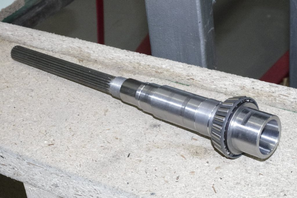

            When we got our first mill at the museum, a large drill mill with R8, the spindle had to come out to replace the lower taper roller bearing. Thic particular spindle had two screwed in pins and I kept them, not knowing any better. The mill still has them in the spindle. Some of the bought tooling was reluctant to fit, and I found that the cause was the milled slot was too narrow for the pin diameters. Only widening the slot slightly enabled the tooling to fit easily. When I did the Tom Senior light vertical MT2 TO R8 conversion, I did without the pins. The pins only use is to stop something like a collet from spinning when the drawbar is being tightened and after the taper is broken, but before the drawbar is finally unscrewed. Collets are the most likely to spin as there is nothing to get hold of. To minimise this problem, I have run a 7/16 UNF tap up the tooling and lubricated the threads with moly grease. If the drawbar is free running into the tooling, there is very little likelyhood of having problems with tooling.

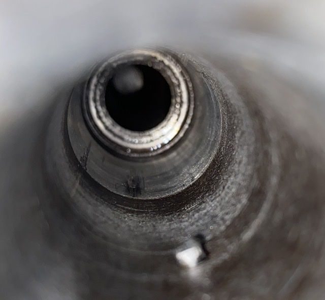

            #484133
            Jim Beagley
              @jimbeagley46363
              This this cold be it? Seems to be two big scores up the spindle.

                    You might just be able to reach the scores with your middle finger. How far up do the collets go before getting tight? Normally, when the arbor is almost right in, it should be possible to rotate it a tiny bit which proves the pin is not tight in the milled keyway. Removing the key should not be top of your list of priorities, but an option when you have got used to the mill. A needle file with a safe edge could be used to make the pin narrower, and a 3/4" stick, or bar with a bit of 400 paper stuck on the end with double sided tape could smooth any burrs inside the top of the spindle. Just a few strokes after carefully aligning it would do.

                    Jim Beagley
                      @jimbeagley46363
                      Thanks for all the advice. That pin sure does cause some argument on the web
                      For now I’m leaving my pin in.
                      Ive discovered that some of the (brand new) qty 8 collets supplied with the machine fit better than others, which can only be the collets I guess. Strange.
                      I have remedied the spindle bore with some careful honing, and now the collets do all pull up into place without having to use a scaff bar on the drawbar (not really).

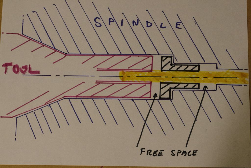

                            As I mentioned earlier, removing the pin should not be considered until you have had much more experiance with the mill. I also said that we have one mill at the museum that has two pins in the spindle bore, and I'm in ne rush to remove them. One advantage of not having pins is being able to use an ISO30 spindle wiper to clean the taper part of the spindle. I did notice the step between the drawbar hole and the upper part of the spindle bore in your mill. I took advantage of that and the space between the end of the tool shank and the step, to make a self extracting drawbar for the TS.
                            #484830
                            Jim Beagley
                              @jimbeagley46363
                              Hi old Mart.
                              thanks for taking the time to make the sketch.
                              i understand the parts but I’ll have to do some research to see how the self extracting system works.

                                The Tom Senior R8 conversion has room in the spindle bore to accept a self extracting drawbar, which works well, but when I was making the spindle, I put flats on the spindle to make using the drawbar easier. An advantage is not having to strike the loosened drawbar to break the taper.
