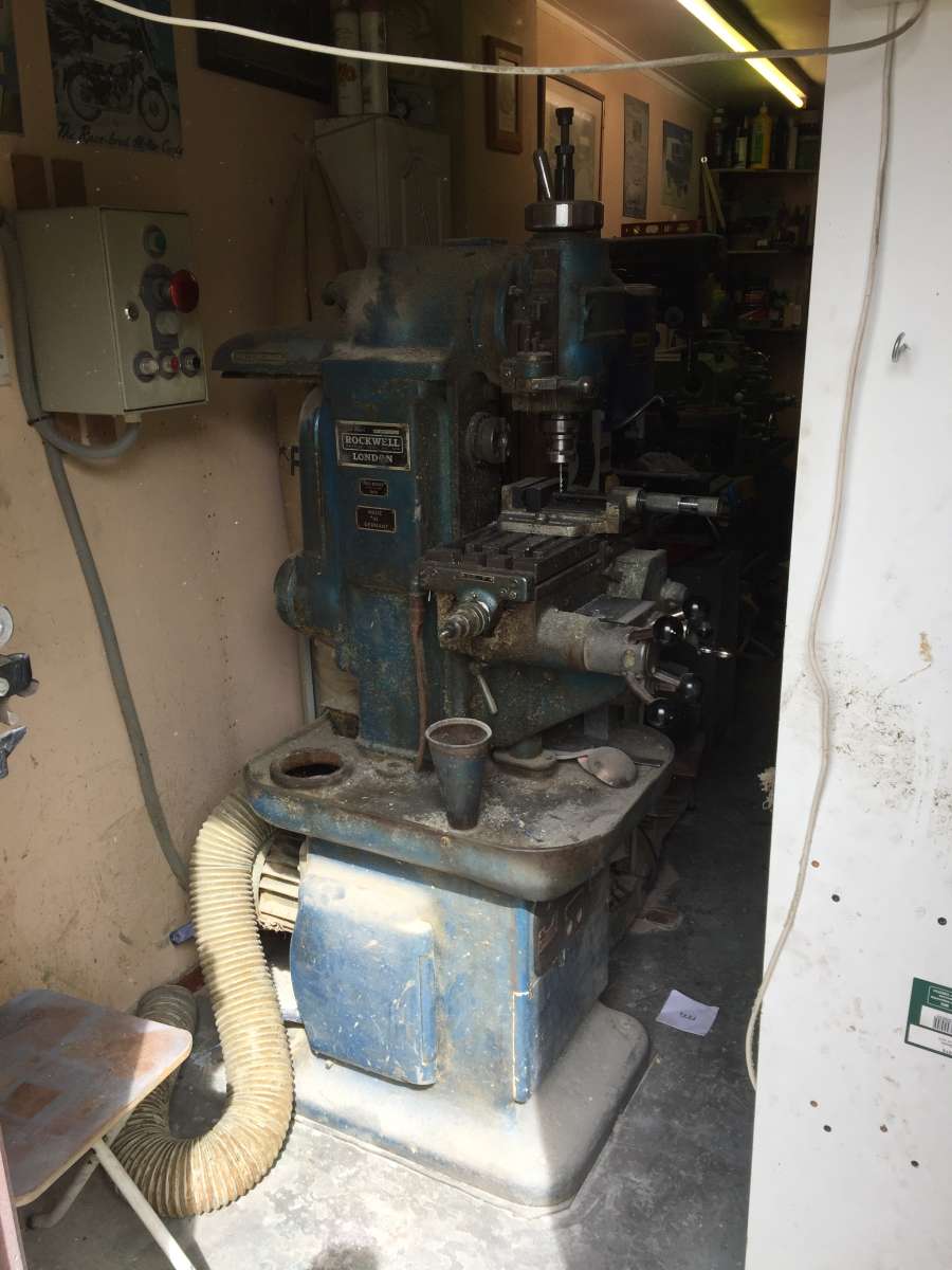

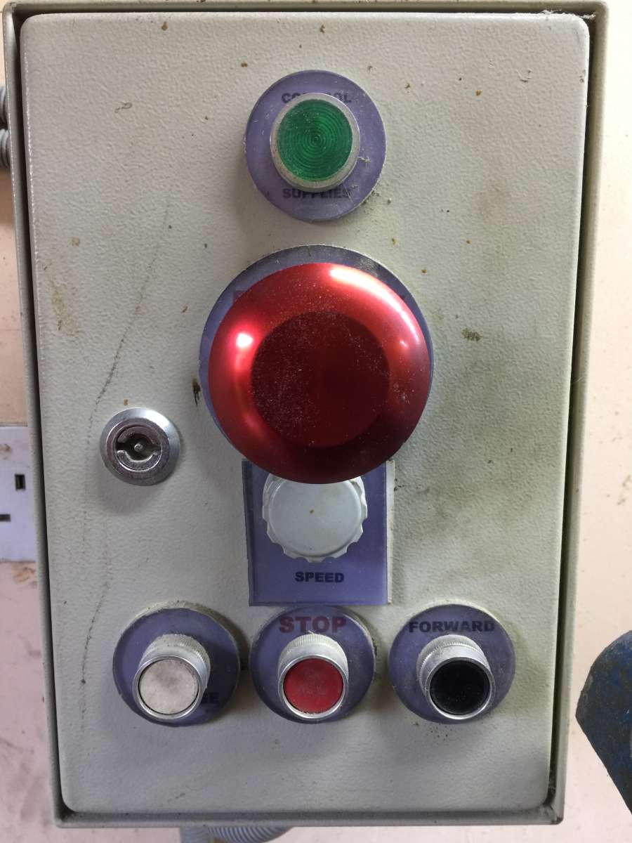

      Hello,
      I have had my old German Horizontal/vertical combo milling machine now for about 15 years and it has been perfect. But the other month I turned it on, it spooled up and then spooled down within 10 seconds. Since then it has been dead.
      The mill has a large three phase motor and two ginormous boxes full of electronics that I do not understand. My guess is something in one of the electronic boxes has failed (or tripped). However, I would also guess it would be cheaper to roll the dice and buy a new inverter or a whole new single phase motor/esc combo rather than pay somebody to come out and tell me they can’t fix it or do not understand it?
      The mill is a typical medium sized home workshop type machine in cast iron standing about 5tft tall with an 2ft IMG_3633long bed.
      Please could somebody advise me on what direction to go, new 3 phase inverter for my old motor (assuming my one is dead) or a new single phase motor/esc combo deal. I don’t mind swapping over the motor for a single phase and all the messing about that entails if that is the best way to go, but I would need to know what HP motor would be best for a machine of this size.
      I have tried to talk to ACDC Drivers UK, but once I showed them the pictures of the mill, they stopped talking to me and have refused to communicate since! So other sales outlets would be better for me.
      Many thanks for any help you could give.
      Rob.IMG_3635IMG_3634

                  Looks like a Centec 2B copy with the Mk3 head, about 1Hp. Is it variable speed ? Is it 220v or 415v 3Ph. There may be someone near you who could help, where are you ? Check the voltage, then the resistance phase to phase and phase to earth, ideally with an insulation tester at 5oov, otherwise with a multimeter. If this is good then the motor looks sound. The box on the wall ? what is it, old VFD or a static converter ? If a 220V VFD then get one to suit the motor power. 415v VFDs are available but more costly. Or change the motor for a single Phase 1450 rpm 4 pole motor, simple and little to go wrong for a while. Good Luck. Noel.

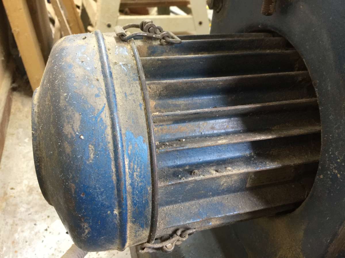

                              Hi Robert, The pictures do not show the motor, is it mounted in the base ? a picture will give clues as to what it is, ideally of the data plate. In changing the motor one has to find a new motor to fit the space, or make up new mounting plates Etc. and be able to align the pulley/belts. The vogue for changing a motor to VFD is not always as simple as one might hope ! You have not told us if your old unit has variable speed, though you talk of an ESC, you mention 2 huge boxes, it could be a static converter, or possibly a rotary converter. From what you have said, I would take the motor out and take it to may be a rewind specialist for testing, this will dictate your next move. If the motor is good then you will know what voltage Etc and a new VFD/ESC can be got. If dead then depending on its size Etc you know what your looking for, or if it’s an odd ball then rewinding can be an option and if it was Star wound this can be changed to Delta on rewind. Now Delta a new VFD is easy. The rewinder will be able to offer advice. I’m on the Norfolk coast or I could sort this for you. Good luck. Noel.

                                      DC31k
                                        @dc31k

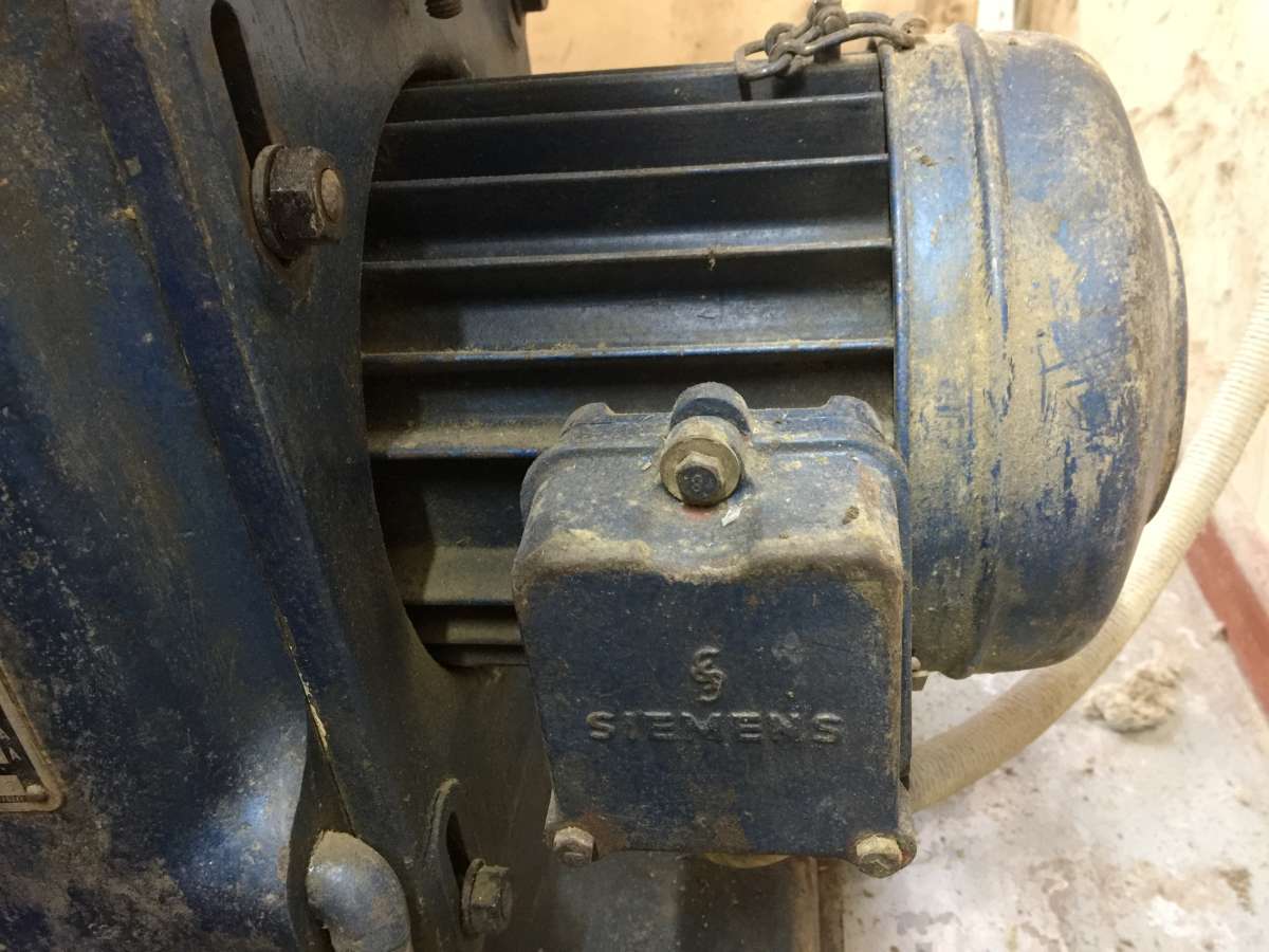

                                        On noel shelley Said:
                                        The pictures do not show the motor, is it mounted in the base?
                                        There is an extraction hose in the photo. It is resting on the motor.
                                        The advice to replace the motor is good in principle.
                                        The machine is shown on the lathes.co.uk (https://www.lathes.co.uk/fritz-werner-special-millers/), described as size 0 (zero) and labelled 5.160W in the photograph. There is a full colour version, where the motor is clearly visible and which explains the hole in the rear left of your cabinet. There is also a photo with the side of the cabinet open showing the pulley on the motor.
                                        You would do well to pull the machine forward, clean the back and motor and remove the motor.
                                        You can then photograph the data plate of the motor, which will tell us a great deal.

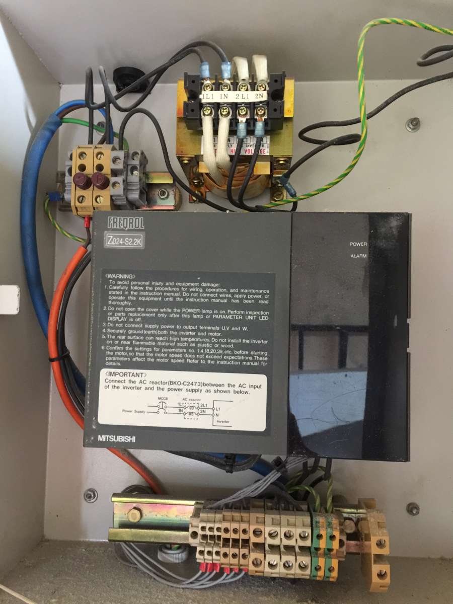

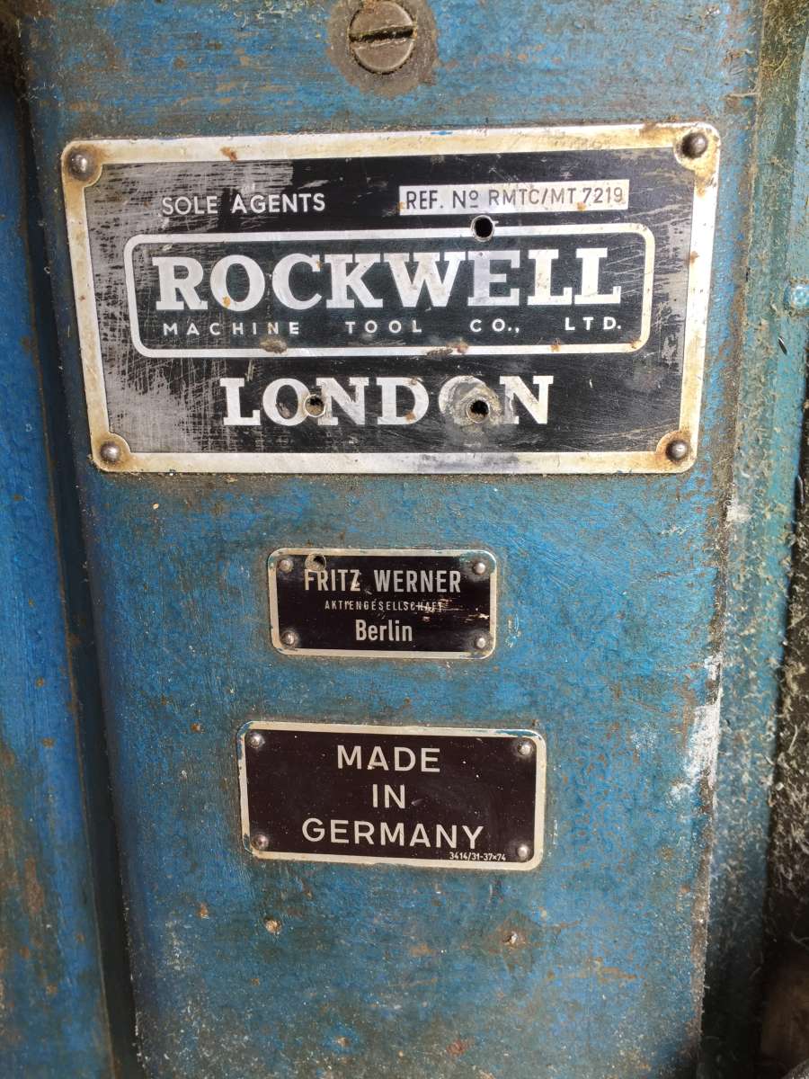

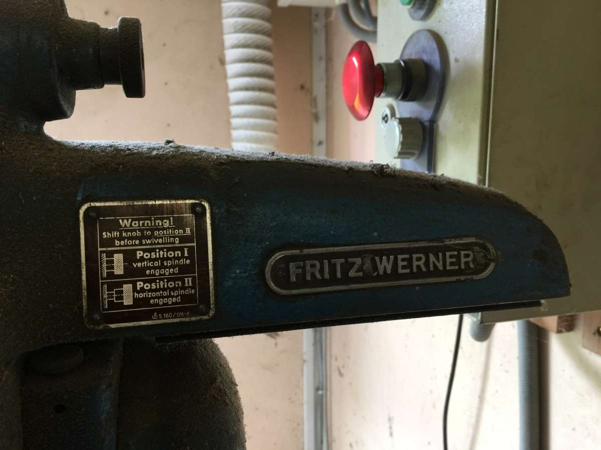

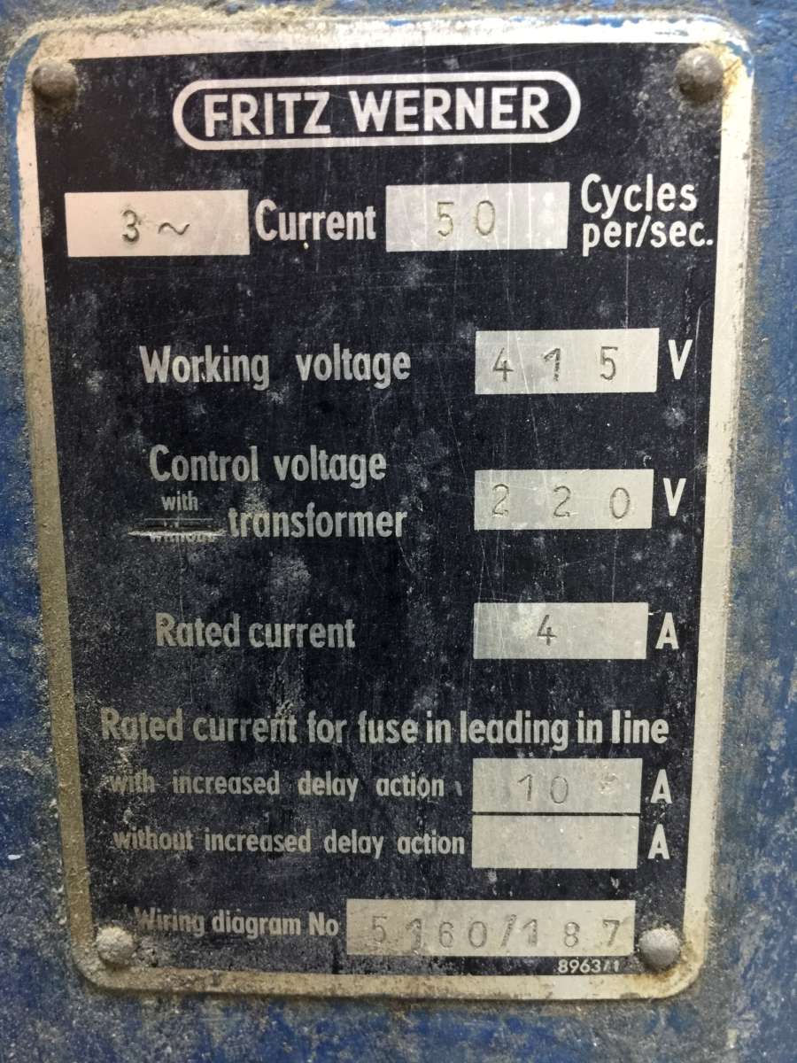

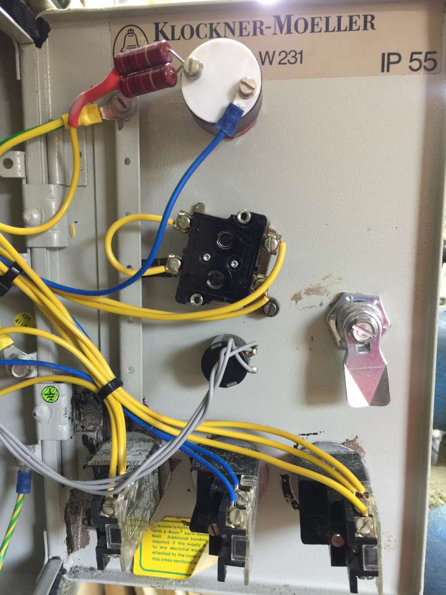

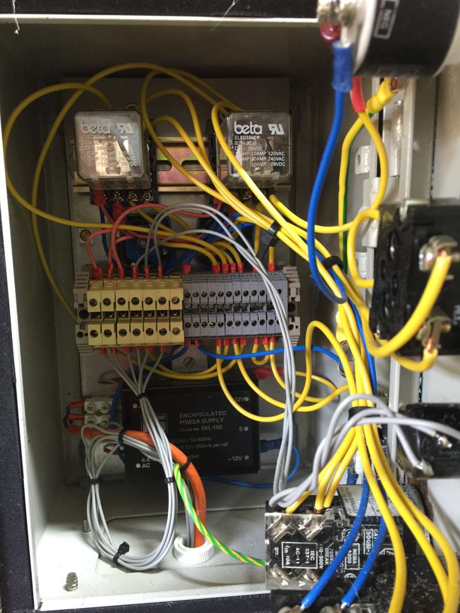

                                          I have no idea what is going on with my machine, but I cleared some space today to take some better pictures and I thought I just try and start it, and it started up just fine !!!!!
                                          The machine has been down for about 4 months and last week we had the Nation Grid outside my house as they had sent a letter out the week before saying we had low voltage in this street. I’d not tried to start the mill since they ‘fixed’ the voltage, but surly it couldn’t have been a low voltage issue that stopped my machine could it???
                                          Anyway, I think it would be a very good idea to try and work out what I have as I am sure that information will be useful at some point. So here are few better pics 🙂
                                          Thank you.IMG_8966IMG_8967IMG_8968IMG_8969IMG_8970IMG_8971IMG_8972IMG_8973

                                            I can offer no answer as to why your machine stopped working and then started working again but hopefully it will just carry on and be reliable.
                                            What you appear to have is a VFD that operates on 240VAC mains and spits out three phase 415VAC. Whilst that model of VFD is no longer manufactured even a secondhand replacement will be in the high hundreds of pounds (£700 upwards).

                                              Manual for the Mitsubishi inverter here:
                                              https://www.denfordata.com/bb/viewtopic.php?t=2437#p8779
                                              Please download and save locally (like put it on a USB stick and leave in the control cabinert) so you have it as a reference should something go wrong in the future.

                                                Hi Robert, yes it is possible that the voltage drop on start up, along with the local low supply voltage could have caused may be a relay or contactor to drop out. Ah well, all’s well Etc.
                                                An interesting arrangement that is Not now as it was built I think. Wired star at 415V with 220v control transformer down may be to 24v. It doesn’t show the speed, or power rating, strange. The 4th picture of inside the box has 2 relays with 24v coils and an RS mains to 24V power supply. The original wiring diagram might be interesting to see but I doubt it will tell you what you have now. This seems to be a Mitsubishi 240v input, 2.2Kw 3 Ph inverter (VFD ) and I guess the motor has been connected in Delta for 220v. If the cover over the terminal block is taken off it might be obvious which voltage is being used from the connections or you could just put a meter across the output terminal block in the inverter, though bear in mind it could be 415v, so be careful. The Mitsubishi manual for the inverter would be handy and explain the various circuits. Good luck Noel.
                                                #764307
                                                Robert Atkinson 2
                                                  @robertatkinson2
                                                  The problem was almost certainly caused by the low supply voltage. The inverter is, according to the manual kindly linked to by DC31k, is a 240V 3 phase input unit with a “permissive” lower voltage of 180V. It  has a low voltage protection function that stops it running if hte mains is low. See page 117 of manual
                                                  As virtually all VFDs / inverters just rectify and smooth the mains input a 3 phase unit will run on single phase but at lower maximum power. The combination of single phase input and low mains voltage would cause the inverter to not start the motor to protect it from excessive current (The inverter is a constant power device so will draw more current at low input voltage).
                                                  Robert.

                                                    So it may well have been the low voltage to the street that was fixed last week and nothing to do with my equipment, fingers crossed. I will take a pic of the motor with the cover off tomorrow, that may give another clue as to how the motor is wired? Considering the motor has run today, I think I can assume the motor is fine and I expect the VFD is also.
                                                    Thank you again for all your help.
