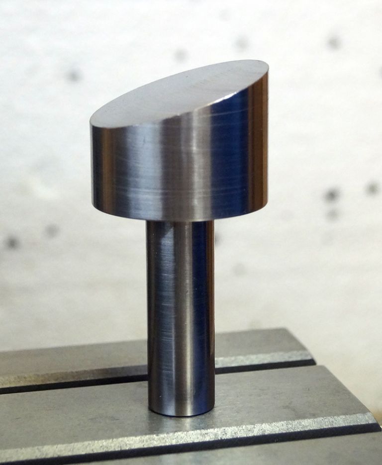

      I also got some time today on the flycutter I am making, despite having a sick lathe at the moment I did manage to turn the body. I then gave a bit of thought to the best way to produce the 20 degree angle for the tool mount. I was going to go with a 10mm end mill (the largest I have) but thought that across 40mm diameter that would be a lot of back and forth with each cut.
      So I decided to flycut it using the boring head, I set it up at 20 degrees in the vice and took 0.5mm cuts. It worked a treat and the bonus was that each pass of the cutter covered the full diameter. I dont know how they are normally set up and cut but that was my take on it.

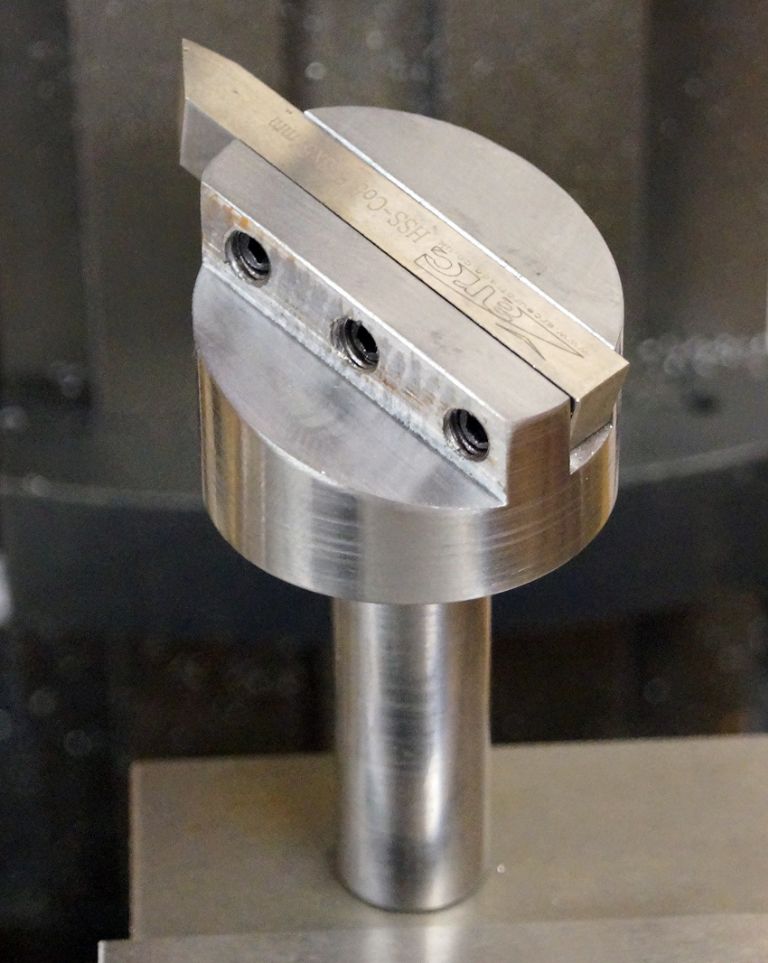

        A new weapon for the armoury, finished the flycutter, well apart from blacking it. Something very satisfying about making tooling.

          Looks Good Ron,
          Thanks for the plug with the tool bit logo. Just make sure to turn the logo bit side around so that it is inside… in contact with the grub screws in this particular case…. so that the correct side is facing out for the purpose of fly cutting.

            Posted by Ketan Swali on 09/12/2018 10:19:03:
            Looks Good Ron,
            Ketan at ARC
            Well spotted Ketan, picture below with tool in correct orientation, well it is Sunday morning..smiley

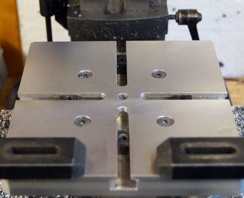

                First job of 2019, managed to get the T slots cut in the rotary table plate. It started out well enough but at the end of the 2nd – start of the 3rd slot the tool started to lose its edge. I have not used a T slot cutter before and it was a new HSS one but I could feel it just wasnt cutting as well. The 4th slot was quite hard work and I almost stalled the mill but just managed to avoid it. Anyway they are now cut and time to move on to making some fittings for the plate centre.

                    Nice looking sub-table, but there's summat wrong with a new tool that struggles after 4 short T-slots. Are you sure it was HSS and not cheesium? smile
                    Andrew
                    #388705
                    Ron Laden
                      @ronladen17547
                      Posted by Andrew Johnston on 01/01/2019 16:39:38:
                      Andrew
                      I thought that too and it isnt an Ebay cheapie, bought it from where I buy all of my mill tools so a bit disappointed really.
                      Ron

                        But don't you usually buy the "premium" range?
                        Edited By JasonB on 01/01/2019 16:53:22
                        #388710
                        Ron Laden
                          @ronladen17547
                          Posted by JasonB on 01/01/2019 16:53:06:
                          I do, but I dont think they do T slot cutters in Premium or do they, cant see them in the catalogue or on the website.

                            Is the sub-table steel or aluminium?
                            Andrew
                            #388713
                              No they only do the ones you have.
                              #388714
                              Ron Laden
                                @ronladen17547
                                Posted by Andrew Johnston on 01/01/2019 17:06:27:
                                Andrew
                                6082 Andrew

                                  Since you have left it square, a good decision, you could put some tapped holes in the corners for clamping big bits. They do say one of the biggest problems with rotary tables is that they are never big enough for the clamps.
                                  #388725
                                  Ron Laden
                                    @ronladen17547
                                    Posted by Bazyle on 01/01/2019 17:17:50:
                                    Thanks Bazyle, I was going to make it circular but then thought of just putting a radius on the corners, then that seemed a waste of usable space, in the end I just knocked the corners off. It does of course reduce the rearward travel towards the column but it is not that much.
                                    Ron

                                      It would seem that T slot cutters are a real mixed bag, the one I have is HSS and maybe I was just unlucky. Having had a bit of a search I see HSS cutters similar size to mine at £50-£60 each mine was £13 so either some suppliers are racking up the prices or there is a real difference in quality..?
                                      I have a job coming up in the future where I will need a dovetail cutter, the job is in steel and at the moment I am thinking carbide providing it wont break the bank. I would have thought HSS would be fine but how much do you need to pay for a good one, seems a bit of a gamble.
                                      Ron
                                      Edited By Ron Laden on 02/01/2019 08:26:28

                                        The poor performance of the cutter could have been of my own making of course. The material was 6082 and the cutter 8mm deep and 16mm diameter. I ran it at 500 rpm, was that too fast..? Problem was, I couldnt run it any slower as the mill hesitated at 400 rpm and even at 500 I almost stalled the mill at one point. I did try it a bit faster but that just didnt feel right and made no difference. I used WD40 and kept clearing the build up of swarf but as the job progressed the cutter certainly felt as if it had lost its edge.
                                        #388814
                                          Ron, how deep did you go with the initial 8mm slot, you can reduce the load on the cutter if you mill that first all the way to the bottom of the slot or even a little beyond. Book speed for ali would be about 1500rpm but that would be on a big rigid machine.
                                          They do need a bit of welly behind them, think what it would be like using a 16mm dia cutter to make an 8mm deep pass, that's quite a lot for a small machine.
                                            Thanks Jason, thats probably where I went wrong, I only went 6mm deep with the 8mm slot. Stupid me, from what you say I can now see that had I gone full depth the T cutter would have only had to take out the sides, I was asking it to cut out a 8mm x 16mm slot in one pass.

                                              Another trick is to cut the initial slot, maybe a little deeper than the final dovetail depth; then use a hacksaw guided by the bottom of the slot to cut to the full depth of the dovetail so that the sharp corners of the tool don't have to work so hard (or at all). That reduces the power required and also minimises the wear on the teeth tips.

                                                Oh dear, there's still a lot to learn! Still, the cutter shouldn't have gone blunt working in 6082. Look at an industrial mill and, as John says, the central slot will be slightly deeper than the T-slot. One, it relieves the centre of the T-slot cutter and two, it provides clearance if a clamping stud sticks out slightly from the bottom of a T-nut.

                                                    There is still a lot to learn Andrew, just annoyed with myself when I dont think things through, I would like to think that I usually do but I obviously didnt in this case.

                                                      I will do a test with the same tool, I have just looked at it and it maybe ok, I was just asking too much of it.
