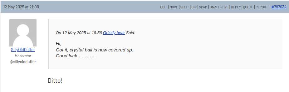

                                                  On Oldiron Said:
                                                  On Nicholas Farr Said:
                                                  Hi Larry, both those replies are not very helpful at all, and could very well put a newcomer off.
                                                  Regards Nick.
                                                  I agree with you Nick.   Sorry to see such stupid comments from long established members.
                                                  Even more surprising from a moderator.
                                                  There were no ‘stupid comments’.  It’s a misunderstanding, probably caused by a forum bug.    If OldIron can’t see my post  #804903 , then he’s been bitten too!  No-one did anything wrong.
                                                  Unless they’ve been jumping to conclusions!  Here’s the post OldIron finds ‘surprising from a moderator‘.  I don’t understand why he’s upset by it.  Members can make their own minds up:
                                                  modpost
                                                  Storm in a tea-cup, I think.
