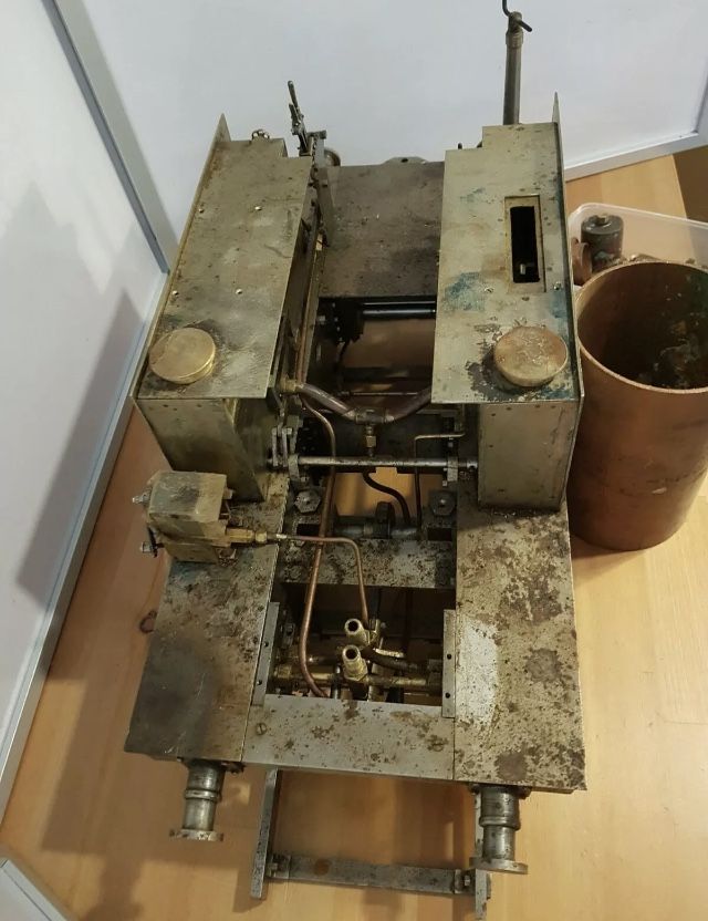

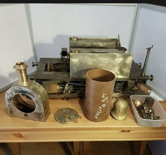

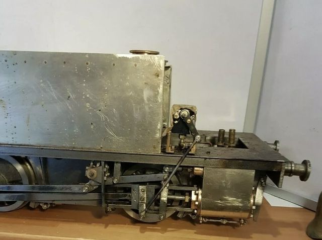

      Hello everyone, I purchased this project and I am completely lost in working our what locomotive it is based on. The rumour is it’s a Don Young RM1 but there seems to be inconsistencies when compared to such a loco.
      If anyone can point me in the right direction I will be eternally grateful.
      Jim

          Looks like a Don Young Railmotor No.3, based upon the S14 class, but with alterations, and the boiler barrel diameter should be 4 3/4" not 4 3/8".

            Agree with Julian that it is a Rail Motor.

              I did receive a 4 3/4 boiler barrel and a reeves 040 boiler kit with the loco too but it is missing some parts.
              The next stage is to decide on making the boiler or getting it made.
