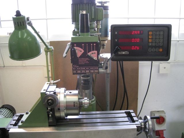

                          Well, I am not sure why folk are saying that a 20mm endmill is a no-go on the FB-2? I have 3 of the FB-2 machines ( yes, I collect them! When I see one going, I buy it!)
                          I use the ER25/MT2 collet chuck that EMCO supplied with the mill, and then standard 10mm drawbar MT-2 end mills, up to 26mm. I can take a 0.5mm cut across the full 26mm endmill, in aluminium, with lube/coolant, at a gentle feedrate , with no complaints from the FB-2, and a great finish. I also use the 40mm shell-endmill on aluminium when 'hogging' to size and going gently all works fine.
                          One of my FB-2's is fitted with a 3 phase VFD, directly coupled 1KW motor, while the spindle is still a 10mm drawbar MT-2. I can take a 1mm cut in aluminium with the 40mm shell endmill, and I use a 50mm 4 carbide insert shell endmill to take a 0.5mm cut in mild steel…
                          I do like the FB-2..
                          On the far left is one standard, fitted with DRO and the EMCO X axis power feed, with a DIY Z power feed.
                          Center of image is an FB-2 converted fully to CNC.
                          DRO FB-2, Bandsaw, CNC Emco FB-2 and Larger CNC Router
                          The DRO FB-2-
                          Marking Handwheels of Mini-T&C Grinder
                          And here is the one fitted with the Jones and Shipman direct coupled motor/spindle.
                          FB-2 Mill With J&S Spindle
                          Joe
