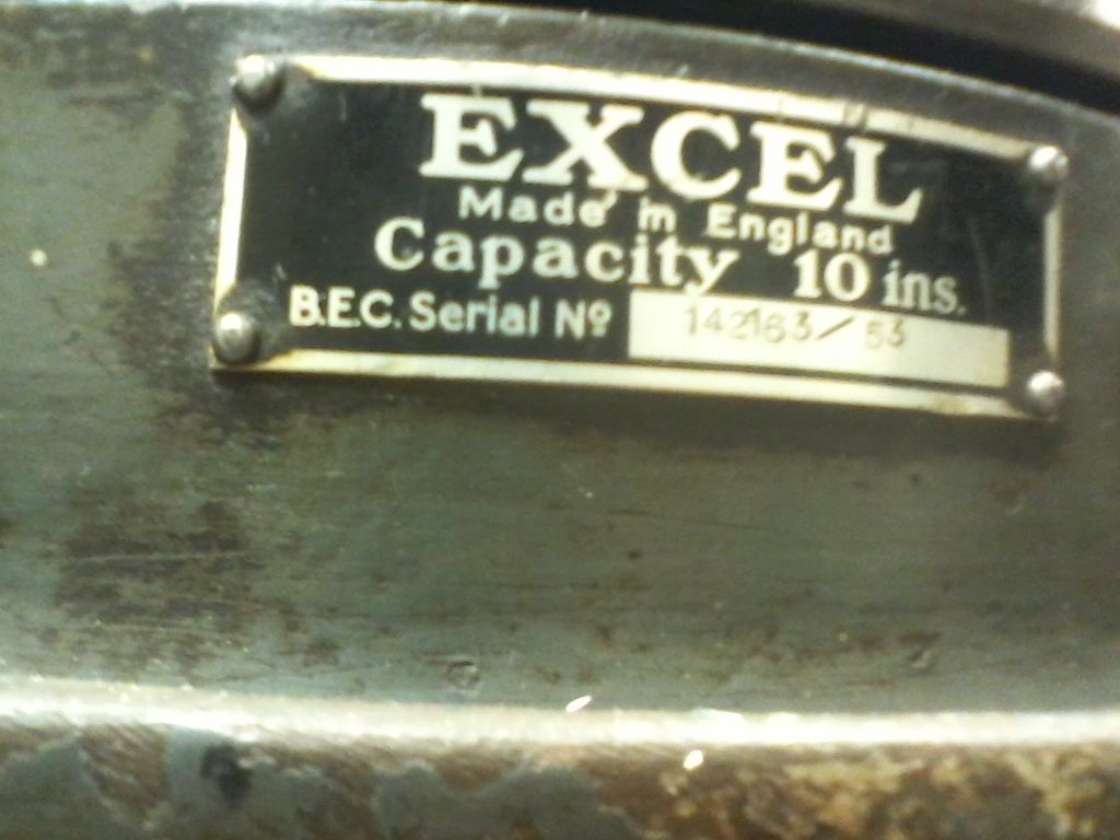

      I have a 10" Excel rotary table and need a chart for it. It is 10", 90 to 1 turn, and 40 division dial. No dividing plates with this model.0320181257-00.jpg

                  I made a very big tactical error. The dial has 48 divisions instead of 40. My bad.surpriseface 8
                  #349135
                    Posted by mark costello 1 on 07/04/2018 03:27:54:
                    Then … Assuming that it does really have a wormwheel ratio of 1:90
                    90 x 48 = 4320
                    4320 ÷ 360 = 12
                    so 12 divisions on the dial gives 1° of table rotation.
                    Which seems fairly practical.

                                      To be honest, Mark … you could do a lot without any plates.
                                      The combination of a 90 gear and 48 graduations on the dial will give you a wide choice of divisions [excepting those that involve the awkward prime numbers like 7, 11, 13, etc.]
                                      Pick a few numbers you might want to use, and I will try to demonstrate.
                                      P.S. Adding a stepper motor to your table might actually be simpler than mounting plates.

                                        Eurika, I see says the blind man. I did the maths and was getting 4 graduations on the dial was .333. Getting 4 divisions to a degree makes every graduation worth 1/4 degree,makes sense now.
