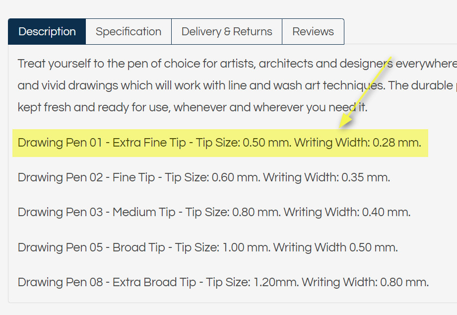

            > This is a quick freehand drawn line on photo copy paper using a 0.1mm Pilot DR pen.
            JasonB, when you say "0.1mm"… I am assuming that you mean Pilot's "Drawing Pen 01" (which has a "Tip Size: 0.5mm", and a "Writing Width: 0.28mm", yes? Or do you means their "Drawing Pen 05" which has an actual "Tip Size" of "1.00mm"?
            Source: **LINK**
            https://drpen.co.uk/products/pilot-drawing-pen?_pos=1&_sid=937715b6f&_ss=r&variant=34775728193
            [See how confusing all this is!]

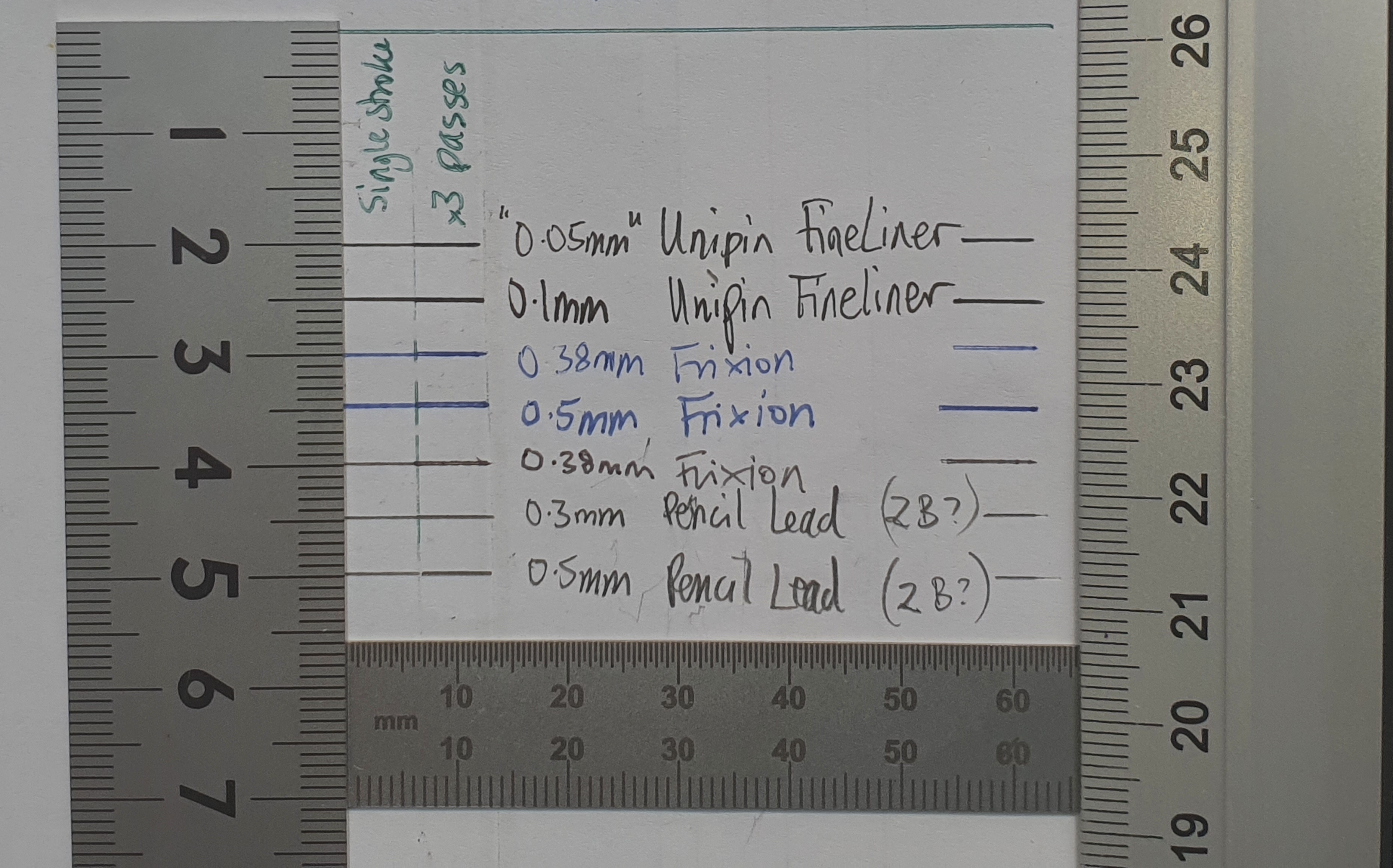

            OK, I don't want to spend too much more time on this. I have now ordered a (reassuringly expensive) fine liner / fibre-tipped pen ("Copic Multiliner SP-0.03mm"  ) which has a "0.03mm" nib. I suspect that they really mean 0.3mm, but time will tell!
            Meanwhile here is a photo of my lines drawn by my current pens (on a reasonable quality injet paper which I use to do CAD printout paper – Avery "Papier 90 Art 2563" )
            Note that the start of each line (i.e. at the left) I have done, a single pass… and the next few mm is a triple pass which is much darker but is also significantly fatter.
            I don't know how obvious this will be from the photo, but my ruler lines are thinner than that of any my pens.
            Did I mention that, yes I already use a CAD system?
            And that my printer can very get much finer lines when I do my CAD printouts than any of my pens?
            And that one of the things that I am wanting to do is annotate my CAD printouts?
            [sigh]
            OK I'll let you folks know how I get on with the "0.03mm" Copic Multiliner SP when it comes.

            #594979
              dont know
              Your supposedly 0.05mm Unipin does look a bit of a joke.
              … Is that a new one, or “well-used” ?

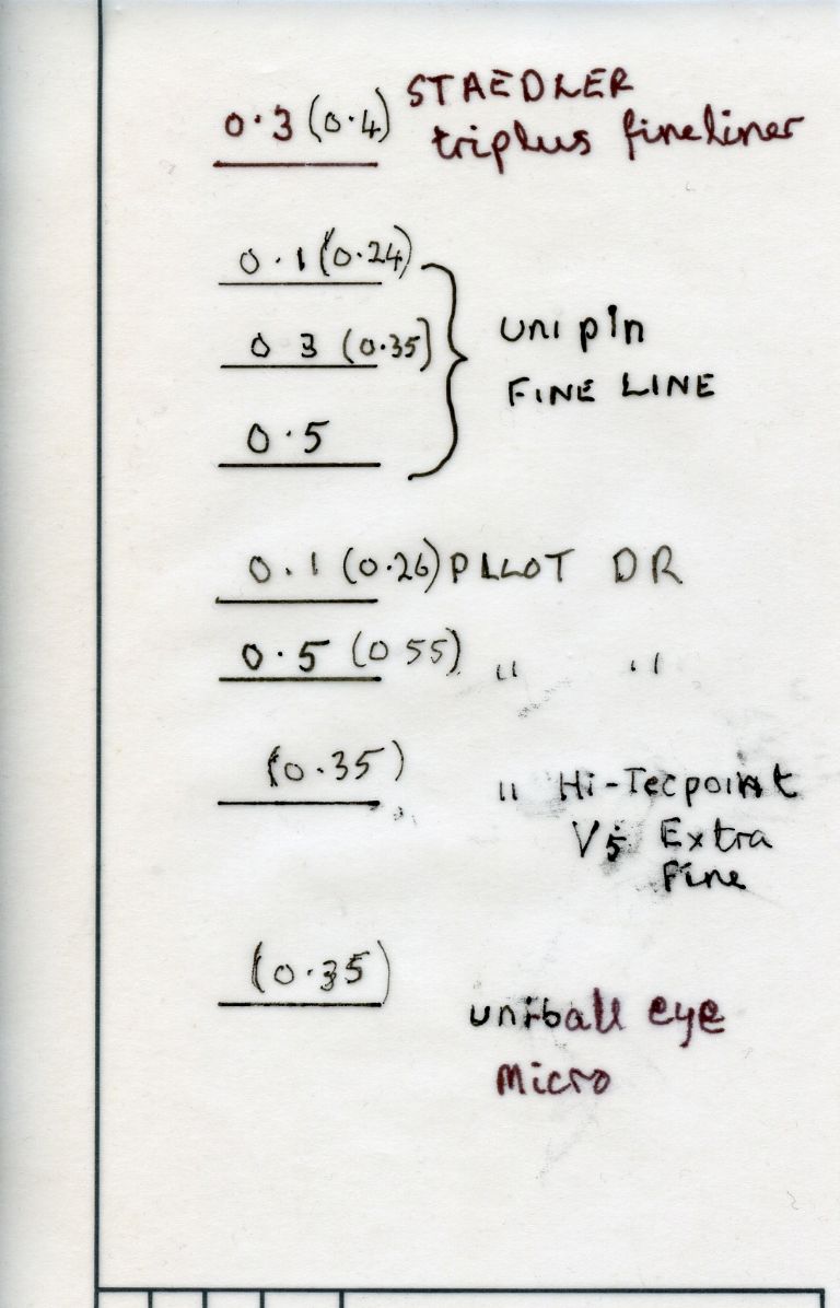

                Hi, I probably can't measure these lines as good as MichaelG can, but the measurements in brackets are what I achieved and are no smaller, but the uni-pin 0.5 seems to be spot on and the Pilot 05 comes a close second, there are no sizes given for the Pilot Hi-Tecpoint or the uni-ball eye. I measured them with my small digital calipers while viewing with an eye magnifying viewer and with the lines being backlit, the paper is a piece that the company that I worked for, used in their drawing office, which looks like tracing paper that all the master drawings were done on. All the pens have had use, but the Pilot Hi-Tecpoint and the uni-ball eye didn't like the paper.
                Regards Nick.
                Edited By Nicholas Farr on 18/04/2022 13:30:13

                      Good question. Well, I have three of them. They are about 6 months old but the one I drew with is barely used. It is possible that they may all be fractionally dry on ink, I'm not sure.
                      UPDATE:
                      Feather-weight use of Fineliners
                      What I have noticed that if one doesn't mind a line being a bit faint, it is possible to get a very much finer line with a Fineliner pen if when it is absolutely new if you only ever use the lightest possible weight (i.e. barely more than the weight of the pen itself!)
