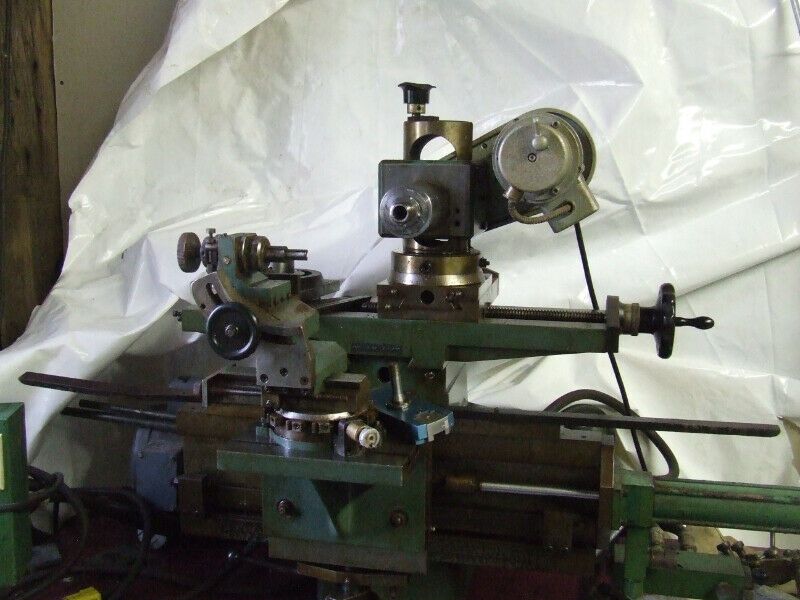

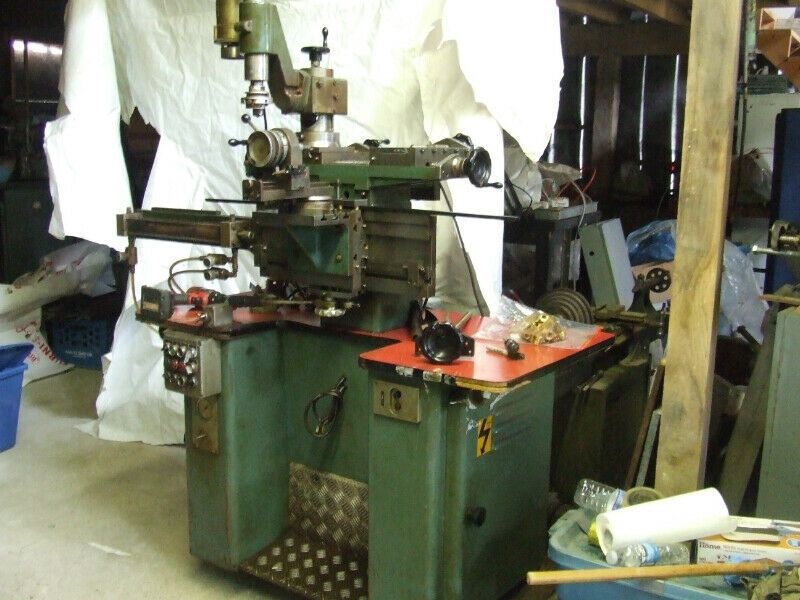

      Hello all
      I recently saw these two machines for sale near Hamilton, Ontario. The seller describes them as Vertical and Horizontal universal Milling Machines, made by Tourdiamants of Switzerland.
      Looking at the pics, I can't identify how they work or what they are designed to do! Lathes.co.uk has nothing on this manufacturer, and a web search brings up nothing, so does anyone have any ideas what they actually are?
      The seller also has Hauser and Sip no.3 jig borers and a Kneller lathe for sale, so he is clearly a specialist toolmaker.

          I would guess they are from the watchmaking industry.

            They both have a certain Aciera / Deckel air about them with the workpiece mounting system overhung off a vertical dovetail.
            I'd guess both are set up to generate offset curves of a range of radii on smaller workpieces. The top one in particular with two rotary devices and a plethora of slides looks immensely capable if you have the imagination and visualisation skills to make the right movements.
            I'd have serious comments about the intellect, personal habits and ancestry of the engineer who designed something that actually needed to extensively exploit the capabilities of such machinery.
            Such work is very much a CNC thing nowadays.

              I agree with Clive, that has a feeling of Aciera about it. An F2 (ish) with modifications perhaps?

                Have a browse through this lot, Robert: **LINK**
                Swiss machine tool literature library
                You should soon get a general understanding
                Edit: I've just found the advert … looks like a very good price if they are complete and undamaged.
                [quote]
                1 horizontal and 1 vertical universal milling machine for sale,all swiss precision. Models are T2E They have drawbar SHAUBLIN W12 collet spindles .Make is Tourdiamants,Swiss. Same quality as Aciera and Schaublin machines Vertical is $1250 and horizontal is $850 .They are a steel at these prices Both machines have both screw feed and hydraulic feed to the longitudinal travel.
                [/quote]
                … I presume he means 'steal'

                  That's the one Michael! I did a bit of digging, and the seller is an horologist called Edmund Zygowski. He has a business called Motion Workshops.
                  I had a look at the Motionworkshops Facebook page, and he looks like an incredibly skilled guy.
                  Oh, and yes…. whenever I want to dream, I go onto the Anglo-Swiss website and drool at the Astoba UW1. The last one I saw for sale was £18,000, so I think I will keep dreaming.
