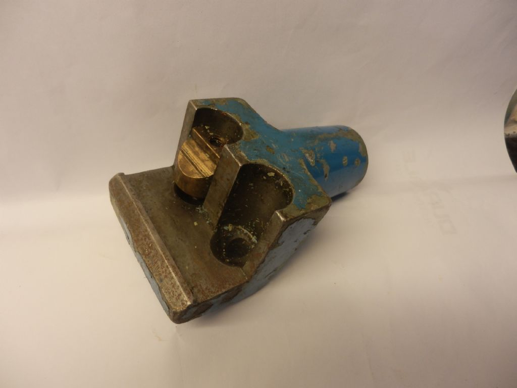

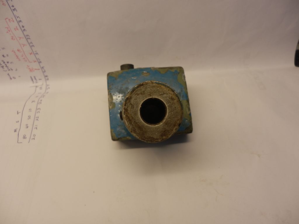

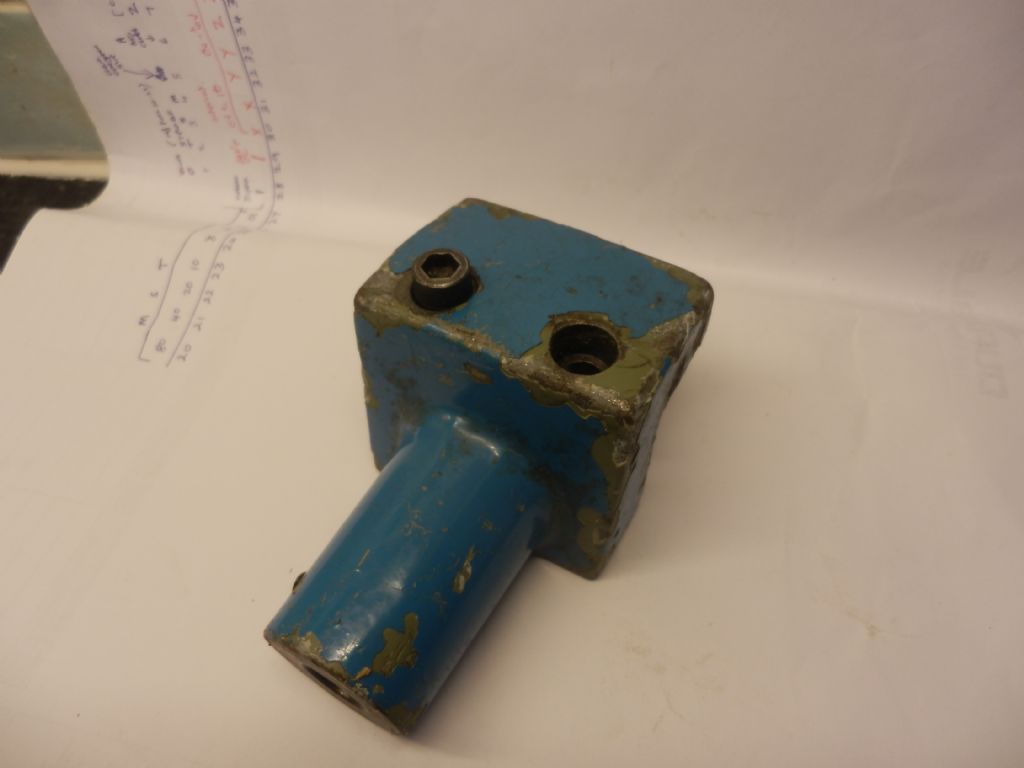

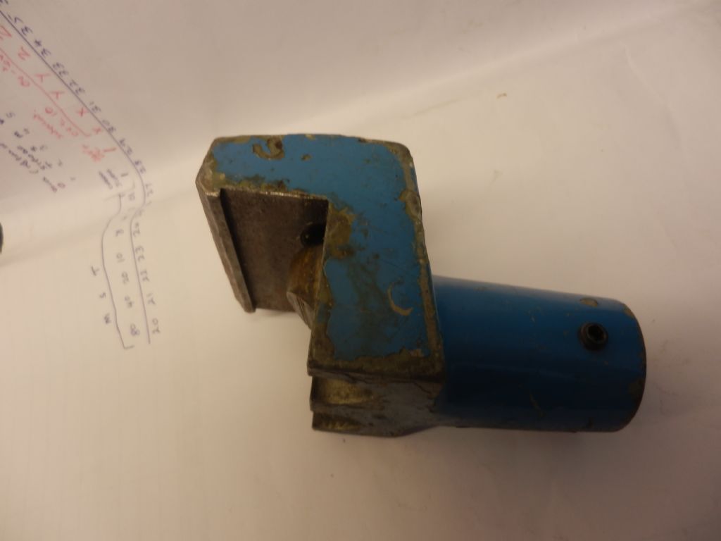

      p7190005.jpgp7190004.jpgHello
      I have a couple of lathe fittings, which I think are from a Colchester lathe.
      they look as if they attach to the bed somehow, and slide along it.
      The tapered shaft is bored but not all the way through – so I guess it is for a handle rather than to lock it in place.
      Any help would be greatly appreciated. I hope the pics help.
      Many thanks

        #486675
        larry phelan 1
          @larryphelan1
          A stop to clamp along the bed ?
          #486676
          Ian Parkin
            @ianparkin39383
            It looks like the fitting for attaching the arm for the taper turning attachment on a Colchester lathe
            #486678
            not done it yet
              @notdoneityet
              Taper or copy turning attachment? A pure guess…
              #486691
              Swarf Maker
                @swarfmaker85383
                It is the bed anchor for the Colchester style taper turning attachment. I don't know if different models of Colchester lathes used a different part but it would appear to be identical to the ones that I have on my Master 2500 lathes.
                #486693
                Stuart Bridger
                  @stuartbridger82290
                  Very different to the bracket on my Chipmaster TT attachment, which secures to the back of the bed. But as said above the system may vary between models, so I am not disagreeing.
                  #486701
                  Manofkent
                    @manofkent

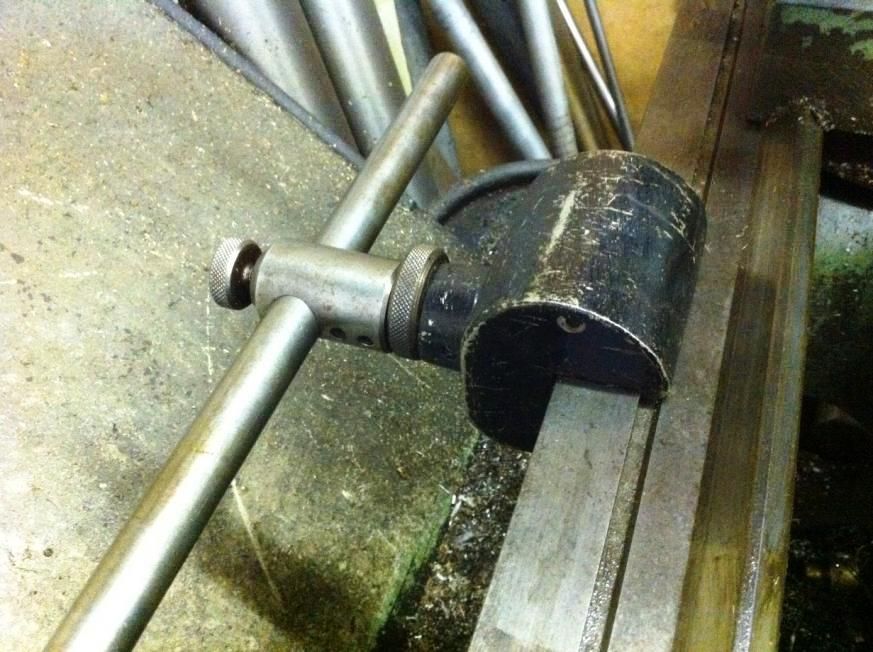

                    Thanks all.
                    Looks like a taper turning anchor as you say. They were probably used in pairs whivh is why I have two of them.
                    Pity I don't have the rest of it!
                    here is a pic I found on google that looks very similar.
