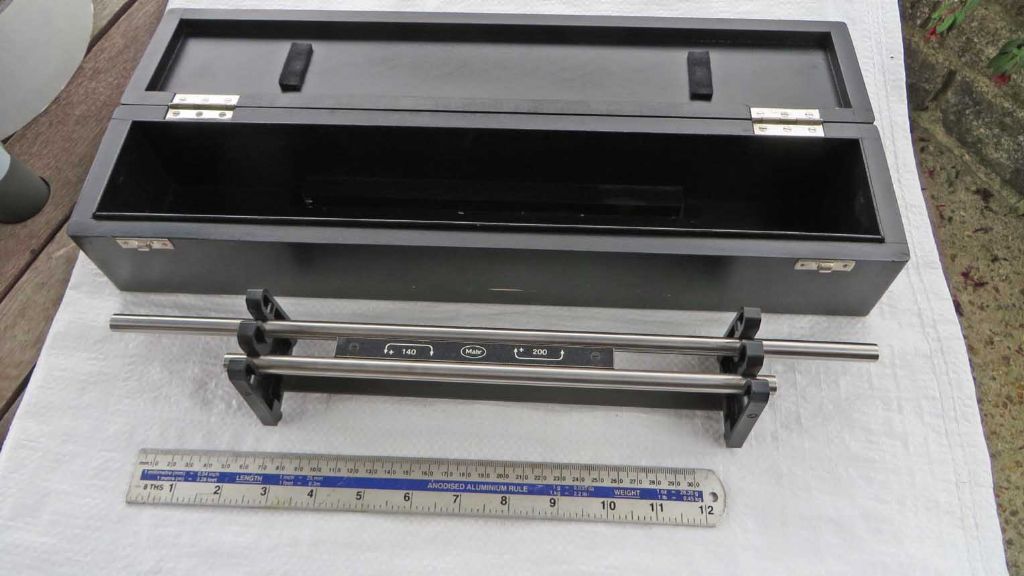

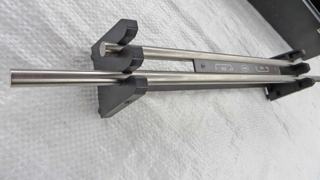

        Hi all,
        This is part of an auction lot of inspection instruments and tooling from last week. I know that Carl Mahr make precision micrometers etc but have no idea what this might be? Is it some sort of Go/No Go gauge perhaps? If so, probably of no use to me apart from the steel!
        The two parts seem to be fixed together in the frame?

          Somebody else has one anyway
          https://www.ebay.co.uk/itm/Carl-Mahr-Pin-Gauge-400-280mm-140-200-Case-4134-/223494083511
          (seller has quite a few for sale. The numbers appear to be half their length).

              Hi Martin they look like micromiter setting pieces.
              David

                Posted by David George 1 on 15/08/2020 23:07:59:
                Used for very small woodworking joints then?
                The pieces differ in length by 120mm. I would be interested to see a micrometer that has this range of motion as the usual ones operate over 25mm or 1".
                The head off one would be good for a lathe carriage stop or a milling machine length or depth stop.
