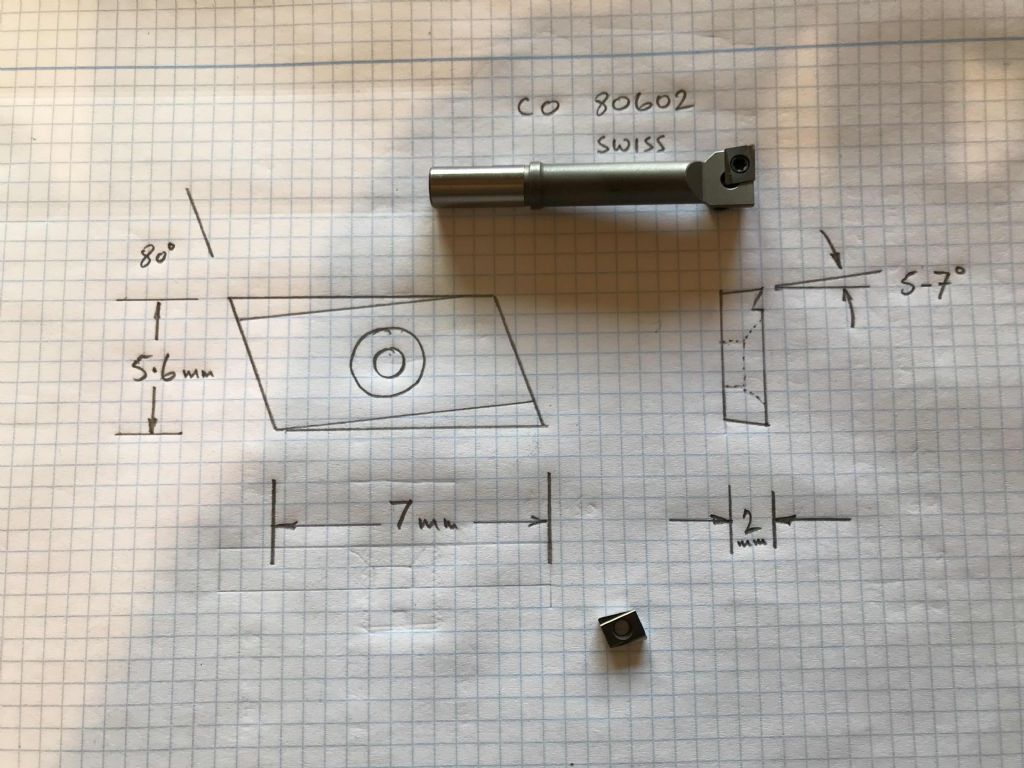

      No matter how much I search the web, these inserts escape me. Can anyone help me identify them?Insert for boring tool.jpg

        Swiss jig boring tool

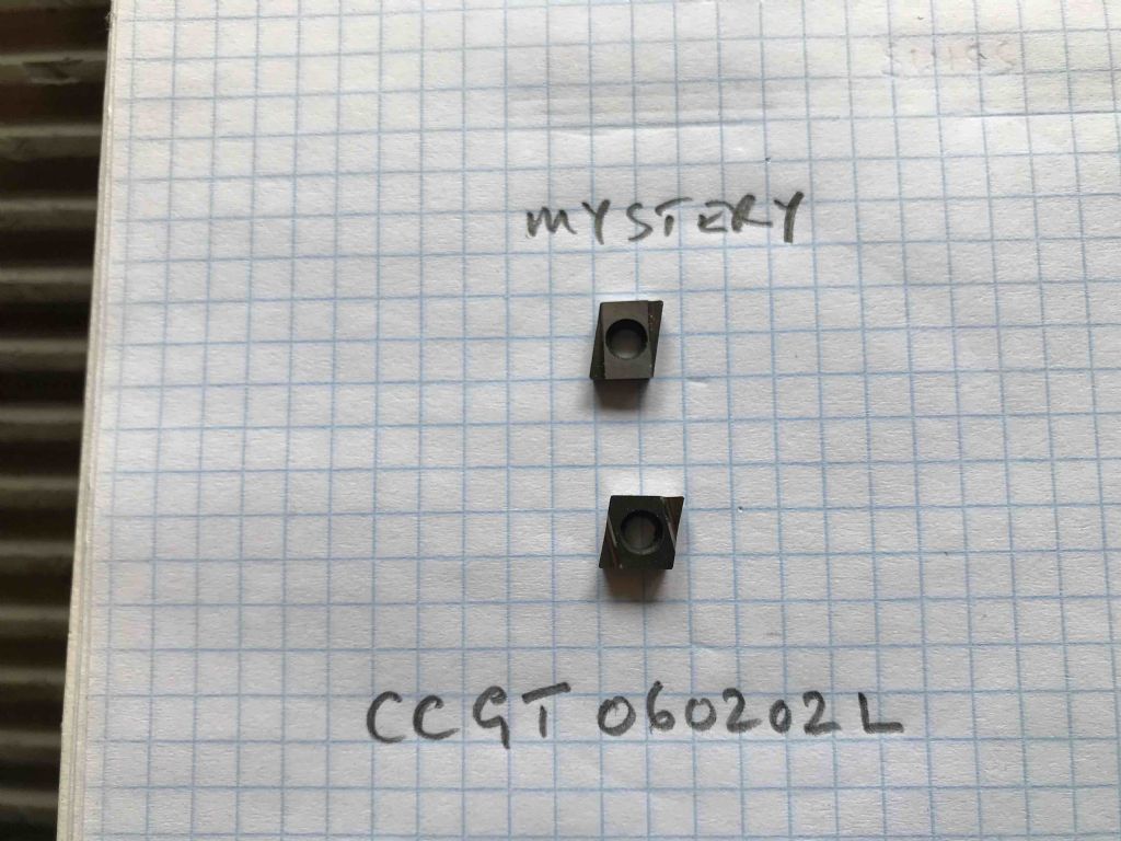

          Try CCGT060202

              Are you certain of the 80 deg angle as "B" covers a parallelogram insert with an 82deg angle. see chart

                With my eyesight, i guess it could be 82 (a good excuse for me to buy a vernier protractor, let's see if I can't sneak that past the financial director/wife). It is certainly nearer 80 than 75 and as I move the insert away from 80 degrees towards 82, I can start to see light from a torch behind, not entirely accurate I confess. I could do with a shadowgraph or even a toolmakers microscope.

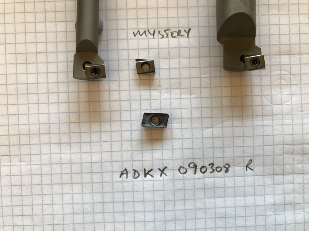

                    Could it be a smaller APKT, or APMT insert, similar to but smaller than those used in inserted tooth Shell Mills?

                      I thought about those and have a Stellram tool that uses ADKX inserts and it looks close but…(I admit this is a RH insert)adkx milling insert.jpg

                        What is the purpose of the tool? It looks to me like a boring bar that goes in a Wohlhaupter-type head.
                        Do you know the manufacturer? It is possible that it is a non-ISO insert, so determining the maker of the tool would seem like your first step on the road to success.

                          Yes, you're exactly right, it was one of two tools (boring bars) which accompanied a Kaiser Piccolo 400 boring and facing head. The tools shown were not made by Kaiser however, the smaller one has CO stamped on it with the word "swiss" and the part number 80602, it has a finely ground 8mm shank and fits snugly in a 10-8mm reduction sleeve supplied with the Kaiser Head. I suspect these boring bars were made by SIP but I've yet to find any confirmation of that.
                          A quick glance at fleabay shows a few CO Swiss boring bars for sale but none with carbide inserts.

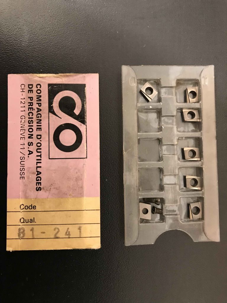

                                                  Just thought I'd conclude this thread as I have found some of the unique inserts, from Ricardo.ch which is I suppose, a Swiss version of ebay. Thanks to all who helped me along. Are these the last of their kind…

                                                    Now you have a stock of them, keep the blunt ones as they look like they could be resharpened easily with a diamond lap.
