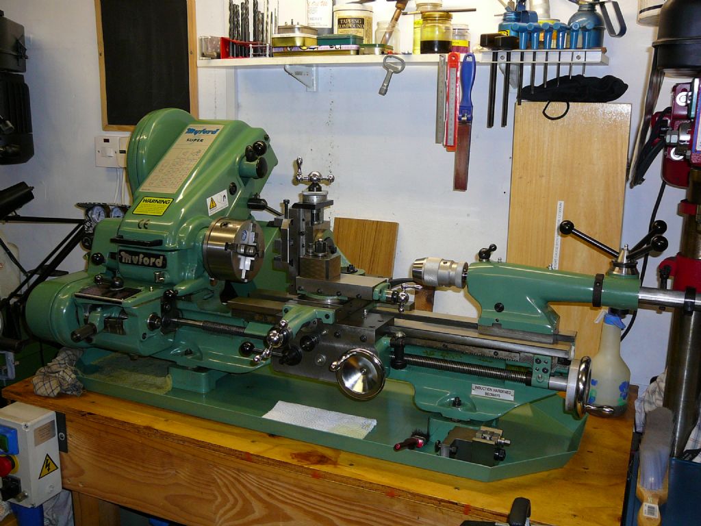

        Well at last third time lucky!
        Finally managed to fit the rack feed, seems to be the thread on the body of the feed isn’t quite square to the face so a little shimming was needed (easy fix but took ages to achieve).
        Very pleased with the result, drilling, reaming and especially tapping is now so much easier.
        Paul

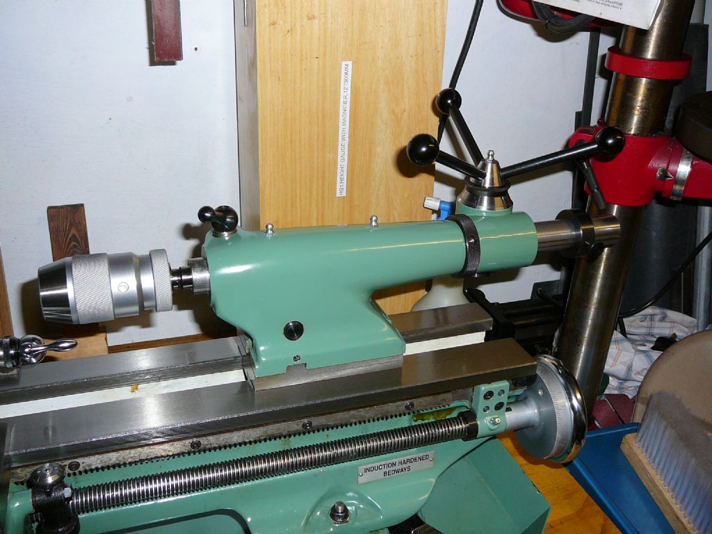

          The photo’s not up to much so here’s (hopefully) a better one;
          Paul

              Hi there, can you tell me more about the dial please, I just bought one from the new Myford (RGD) and I have mm on the barrel but 0-1-2 on the dial with each divided into 16 (must ne inches and 1/16s) It looks like your dial is in 40-50-60 thus in mm?
              Where did you fit the shim, mine is rather tight?
              Thanks
              #162044
              HasBean
                @hasbean
                Hi Martin,
                Mine doesn't have any markings on the barrel but the dial is in mm.
                I had to fit the shim between the locking collar and the rear of the tailstock. What was happening was when the collar was tightened the body of the rackfeed was twisting slightly to the rear and causing the barrel to bind, the shim stopped this and left the barrel free to slide.
                Paul
