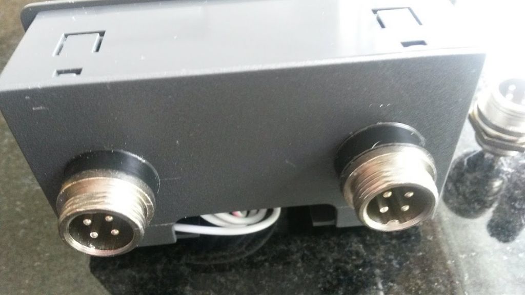

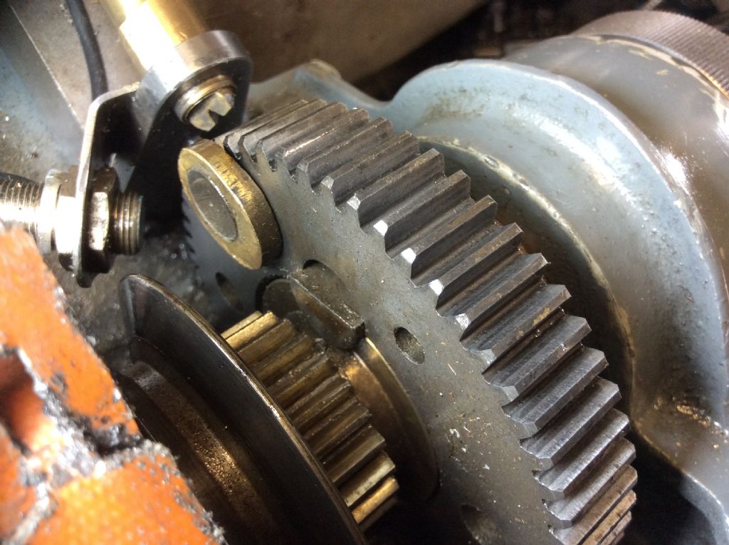

      About time, I've had the bits for over 6 months and just needed to make a sensor bracket and bracket mount and wire the thing up! tachofitted.jpg
      Connections –
      Display Connector – Socket 1 – Socket 2
      1 ———————— 1 ———— 1
      2 ———————— 2 ———— 2
      3 ———————— 3 ———— 3
      5 ———————— 4 ———— 4
      Power plug and sensor plug are wired appropriately and it doesn't matter which socket they connect to.
      Sensor siting –
      It's a non-standard Super 7 but a cylindrical magnet through one of the holes in the front gear wheel and a bracket taking the sensor to the rear of the gear works fine for a standard Super 7, the sensor will pickup a magnet at 90 degrees just passing the front edge of the sensor.

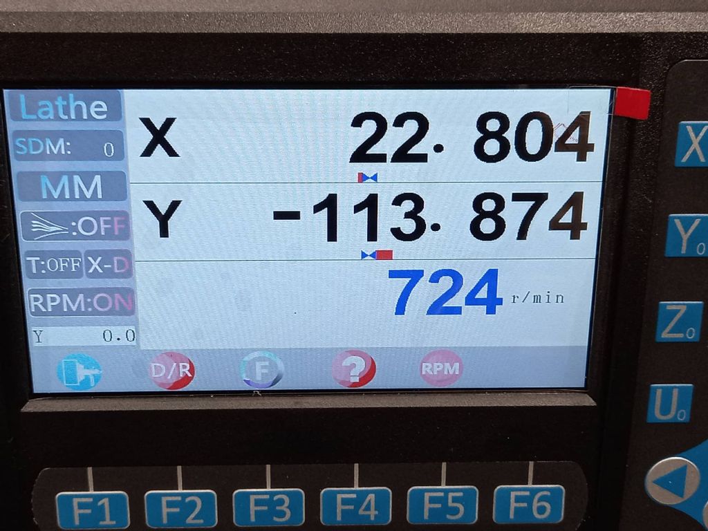

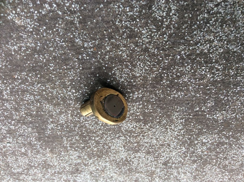

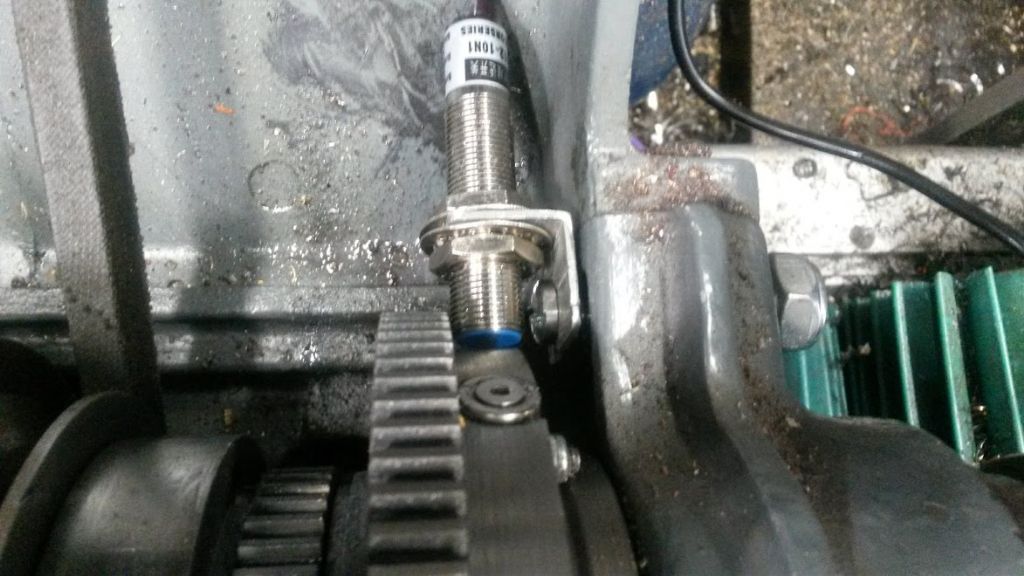

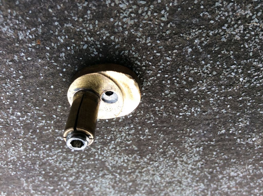

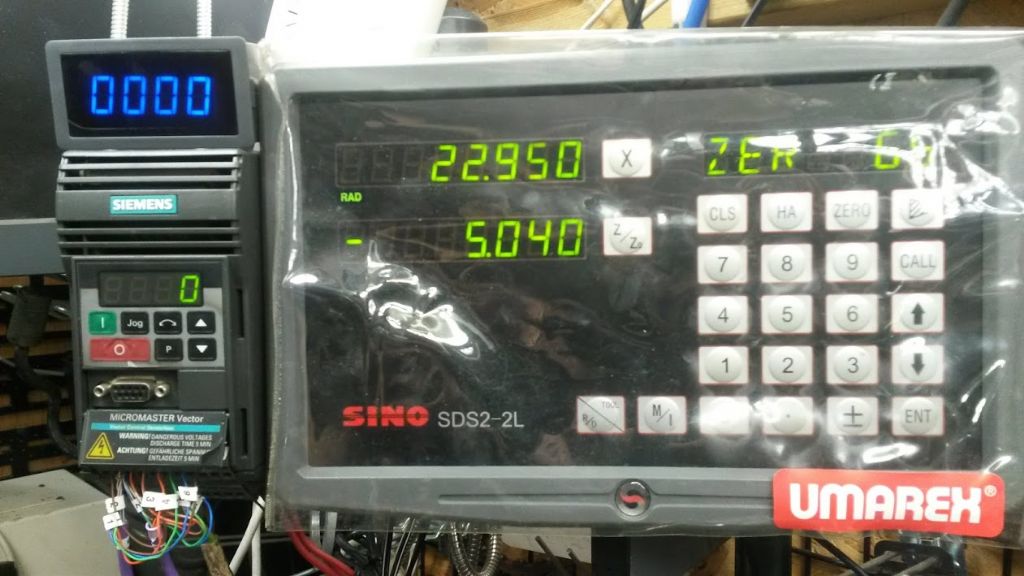

                        I have fitted a hall effect sensor to my S7. I found a neodymium magnet that nicely fitted into one of the holes in the front gear. It is super glued in place with about 1.5mm sticking out. The bracket is mounted where the worn rubber bump stops were placed. I drilled the holes deeper with a 7mm drill until it just broke into the casting. Tapped M8 as deep as possible finishing with a plug tap. Vacuumed out the swarf from everywhere. I also noticed the variations in the casting, so trimmed the height of the screws to be about the same as original the original bump stops. New rubber will be placed inside the 5mm hex remaining, as well as painting the bracket. The hole centres on my lathe was 111.3 for the M8 holes. It started from 1.8mm thick ali angle extrusion. 2, 3mm screws attach the bent bracket piece that holds the hall effect sensor. It needed to be closer for stand along box to work compared to the Ditron DRO box. The sensor is connected to a DB9 connector, It is wired Blue wire (Signal Earth) to pin #2, Black wire (Signal)to pin #6, Brown(+5v) wire to pin #7.
                        Installation
                        Working-RPM display box only
                        Working- Ditron DRO box, with RPM display
                        Now to tidy up all the installation,

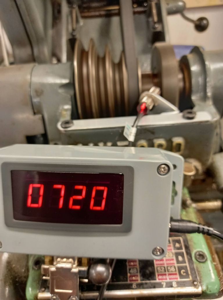

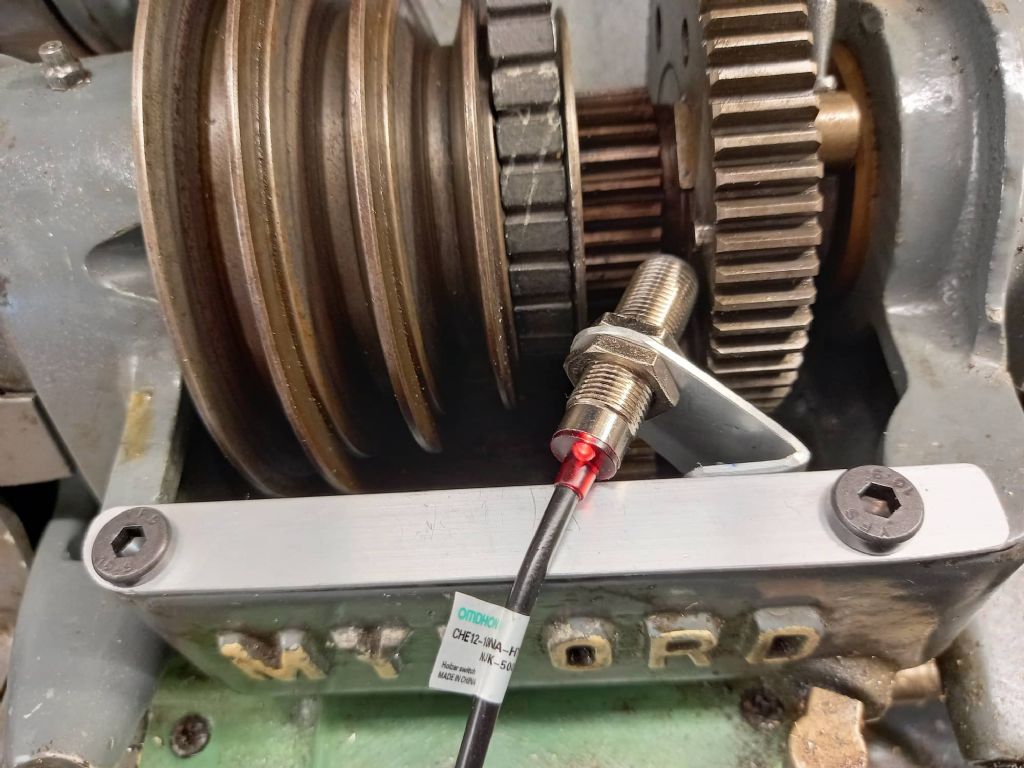

                              bd2723bf-dc27-47e0-b1e2-f2cd5a509c32.jpeg7a0892cb-7f94-4d5a-a34c-8620e266ee81.jpegFitted mine similar to Nick and has not missed a beat in 6 years (touch wood)ac9613d4-8418-41ed-9933-ad6155b51fe5.jpeg
