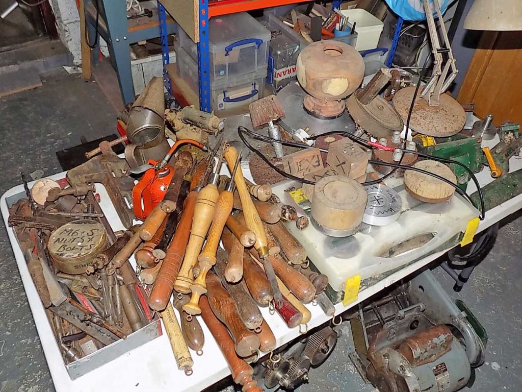

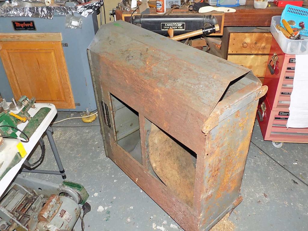

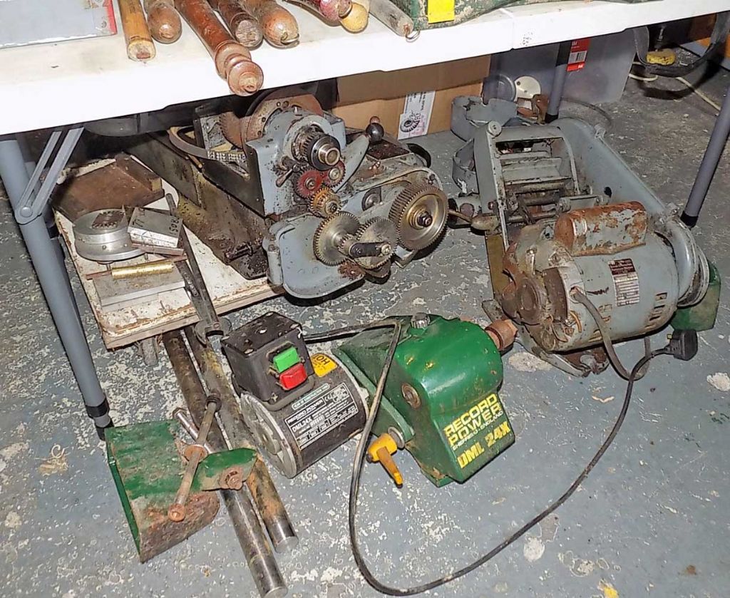

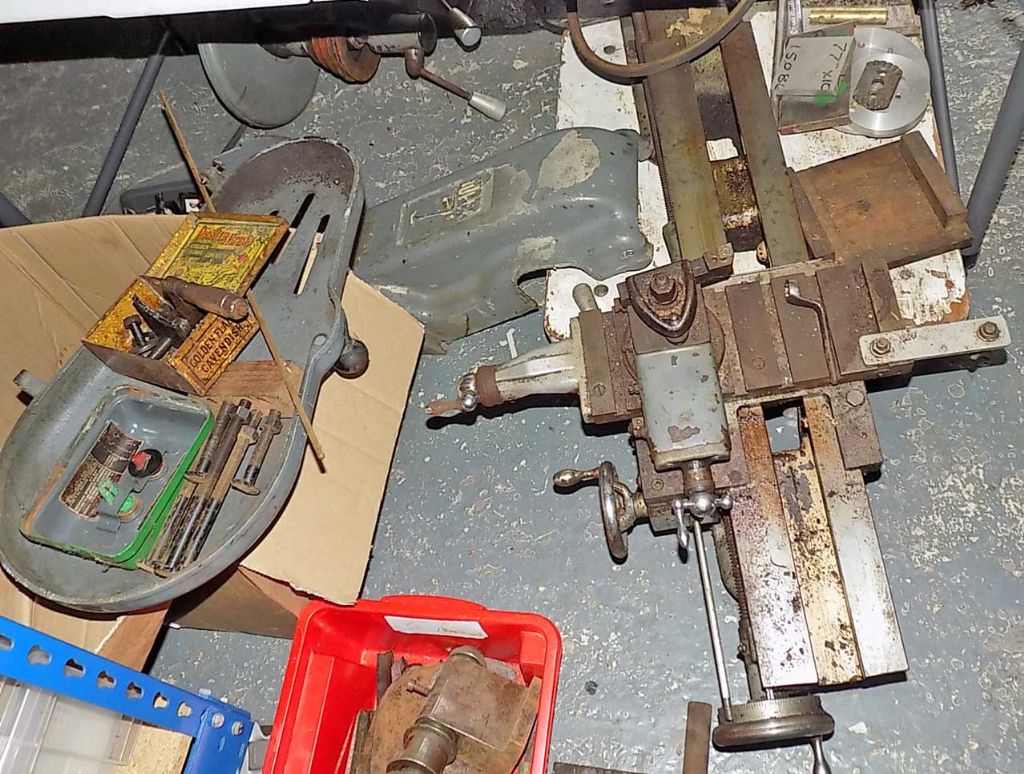

                          Hi All,
                          First off, many thanks to the kind people who have sent me pdf and other info here which will prove invaluable when I get this all cleaned up ready to go back together.
                          As you will see from the pics no small task but better than it all ending up in a skip!
                          I am going to sort the Record Turning lathe first as that is easy and will give me a bit of space, cannot believe how heavy those stainless bars are!
                          I have refinished the cabinet tray using my favourite method of quick rotary sanding, heavy wipe down with lots of acetone, then a liberal coat of KURUST, followed by 2 coats of MYFORD Grey mixed up to RAL 7011 at my local paint shop, (WAY cheaper than from Myford!), about £11 a litre which usually lasts me forever but possibly not on this job!
                          Cheers, Martin

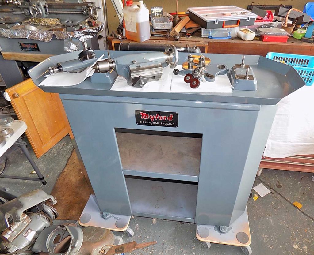

                            Hi All,

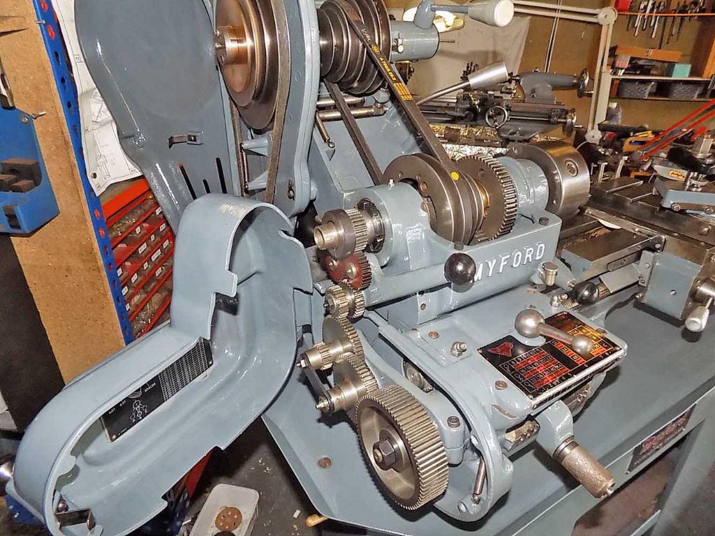

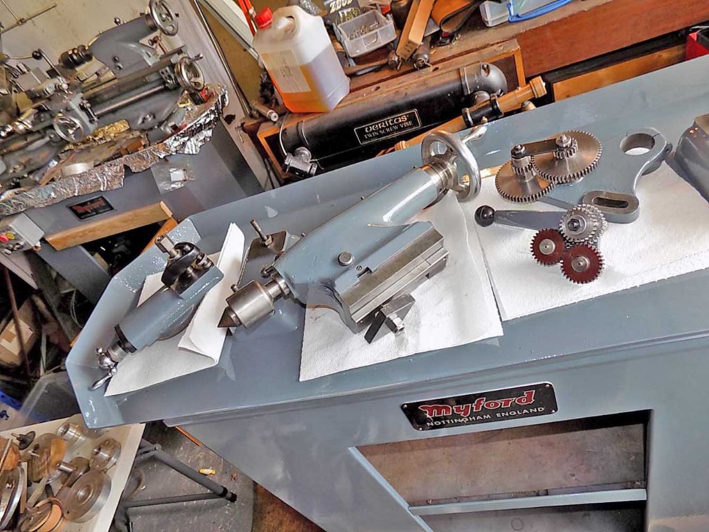

                            The project proceeds apace, quite slowly as we have other stuff to get on with at the same tiem so am doing a bit here and there, finshing some of the smaller components and getting ready to deal with the gearbox and power x feed. Many thanks to Brian Wood for letting me have the gearbox manual and some sound advice!
                            Not looking forward to cleaning up all those alloy castings, some are not so good..!
                            Cheers,Martin

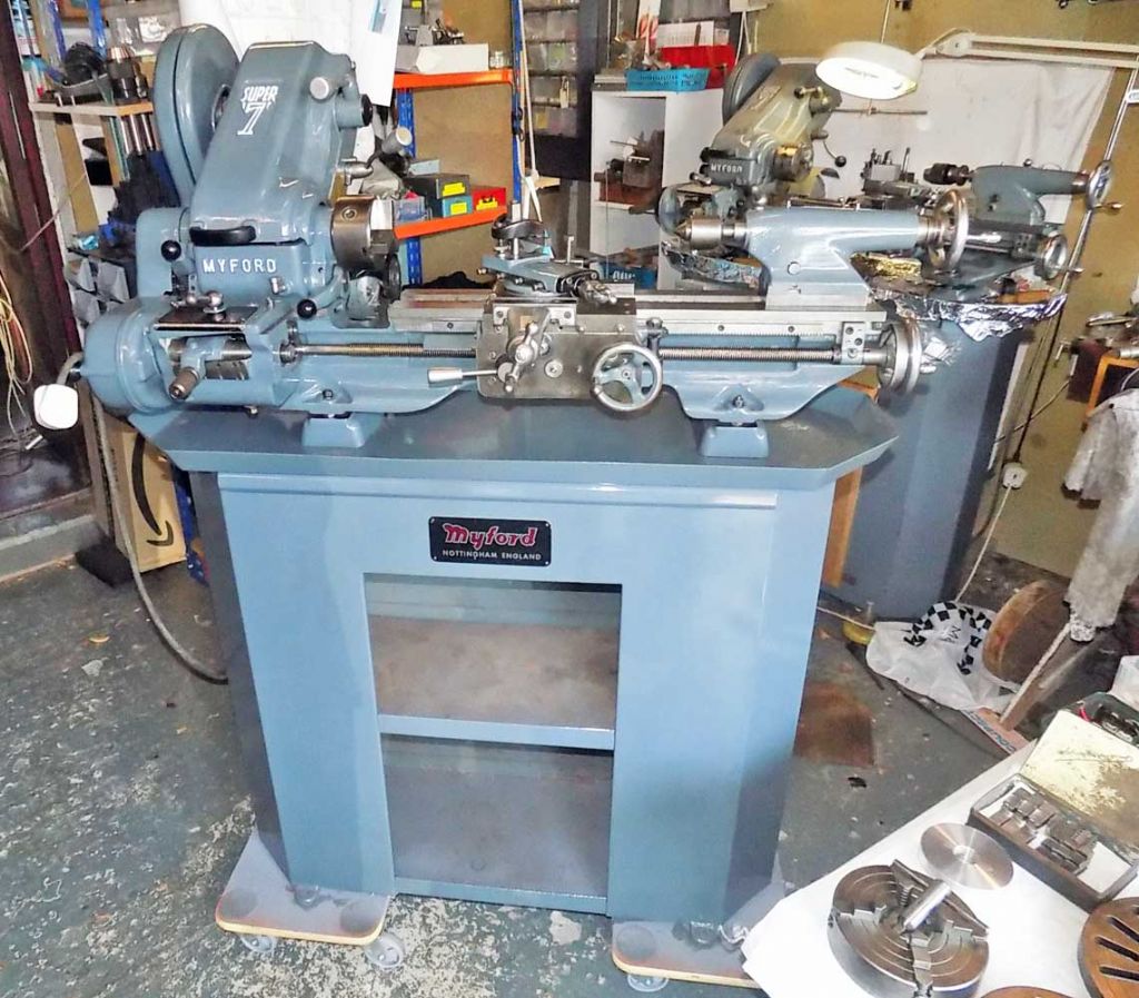

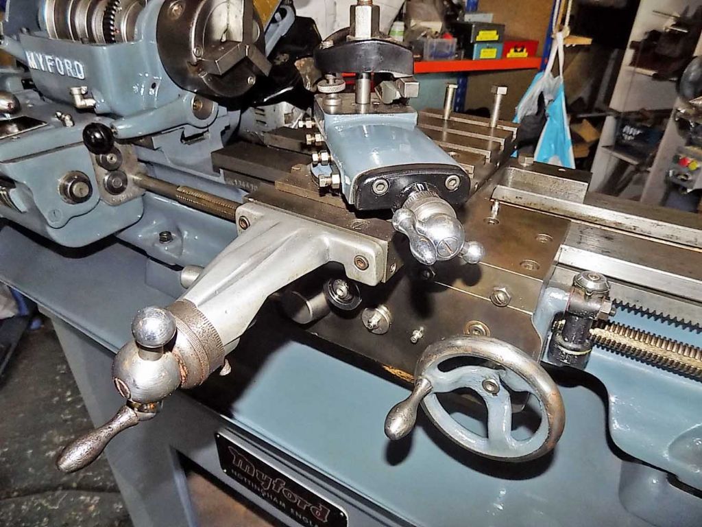

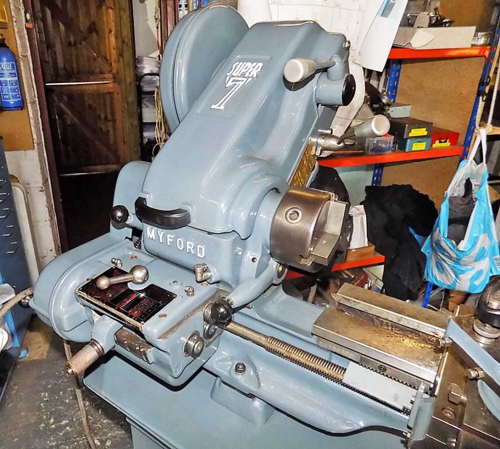

                              Hi All,
                              Finally finished the S7 Rebuild, came up OK in the end but a LOT of work!
                              I learnt an awful lot during this process and really enjoyed doing it except for the stripping and cleaning of the castings! Hopefully it will now find a new home!
                              Cheers, Martin
