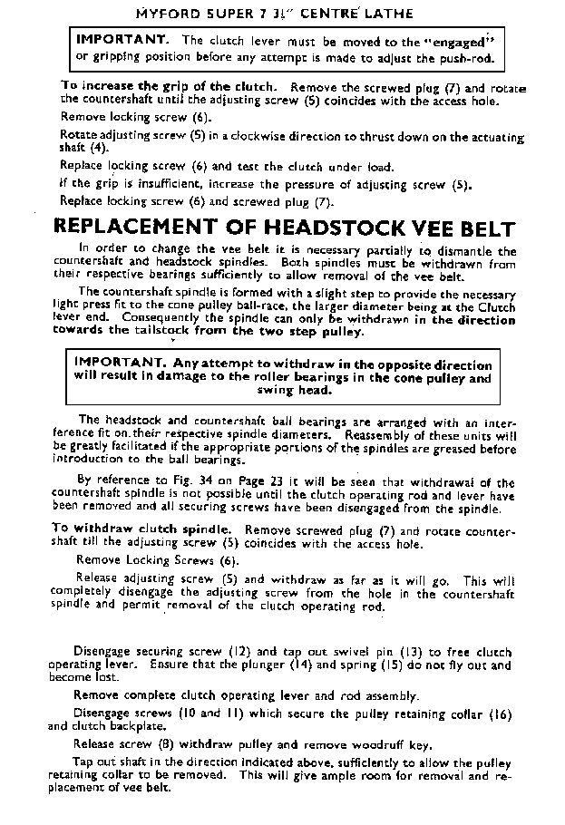

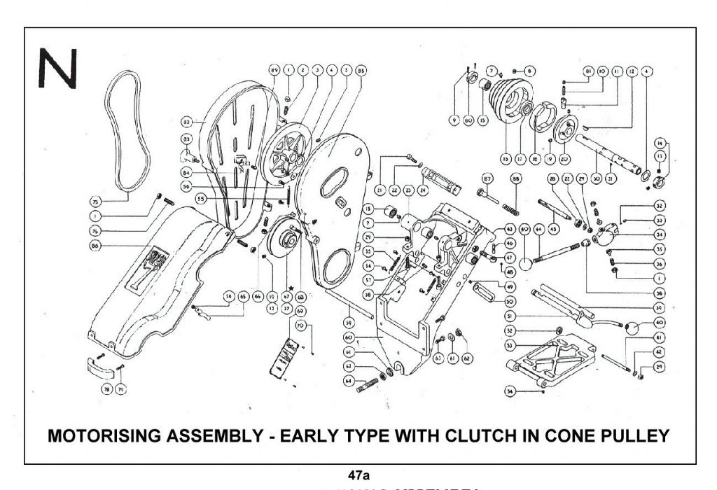

      I have an early Super7 with the expanding clutch piece inside the pulley cluster. However the grub screws, adjuster nuts and parts that locate the handle onto the shaft end bearing are missing. Is there a diagram and parts description available. I can probably make the parts if a drawing or spec is available. Clutch otherwise seems ok if you manually move the rod to lock the clutch.

          Hello Roger,
          I have the Myford drawings which I would be happy to send you by email.
          Some pesky compatability problem prevents me from posting this material on here
          PM me with your email address please so that I can send it to you
          Regards Brian

            Roger.
            Here is some information.
