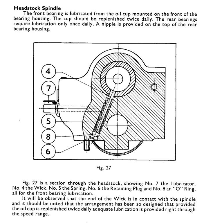

      I have been a "silent" member of the forum for some time, but the time has come to poke my head above the parapet. I have owned my Super 7 for about 30 years, during which time it has seen several moves and the occasional spell in storage. The lathe is now back in use BUT the lubrication of the headstock has been worying me. The Myford instruction booklet requires the headstock front bearing to be lubricated twice a day. On my lathe, the oil level in the cup does not drop and I have not topped it up for years.
      This seems to be wrong: does anybody have any suggestions for the lack of oil use? The headstock does not appear to run hot or sqeal. Should I strip the headstock to investigate, or leave well alone?

                @njh
                Hi Dave
                That does tend to suggest that you have a problem with the wick. As a first action I think i would replace it. I understand that the lubrication is a " total loss" system ( ie the oil you add to the front bearing is "lost" once lubrication via the wick has taken place) If your oil cup remains full that suggests that it is "bunged up" somewhere.
                Here is a diagram
                Regards
                Norman

                  Hi Dave my super7 shows a very slight ring of oil around the mandrel and nose bearing, which is as it should be. Take a look at the above drawing and note that the wick has to be in contact with the spindle / mandrel. It would not do any harm if you decide to drop the spring / wick out and inspect it, I think new wicks are available from Myford's.

                      Unscrew the headstock oil cup to check if there is no blockage and oil can reach the wick, if that is OK but still no oil becomes visible around the mandrel as written above, then you have to check the wick it self by taking out the spindle. Niko.

                          IIRC, when removing the spindle you have to restrain the wick from moving upwards by sticking a bit of wire or similar through from the side.

                            OK I've not done this but why is it necessary to remove the spindle to check and replace the wick? Surely by removing the plug the wick and spring can be removed from the bottom of the headstock casting and a new wick inserted?

                              In order to get to the plug you have to take the headstock from the lathe bed, for that you have to take half the lathe apart, it is much easier to remove the spindle. Do mark the position of the split collar on the spindle and make reassemble a little easier. Niko.

                                Two steps forward! I have just removed the oil cup: no blockages, but very little oil in the passage. Checking the Myford manual, I should be using Esso Nuto H32. I am actually using Castrol Magne BD68 (as called up for my little Emco mill). It looks like it is far to thick to flow throught the Myford headstock. Read the blasted manual.
                                I will update you all when I get my hands on the right oil… Time to invest in one of those Reilang oil cans, too?

                                  I was concerned that the oil consumption of the front headstock bearing of my lathe was negligible and certainly would not require topping up twice per day however much I used the lathe. I removed the spindle and took out the felt wick which was in perfect condition when compared with the new one I had purchased. The spindle was also in perfect condition and the bronze bearing still had most of the original scraping marks present. Absolutely miniscule wear (if any) after many years of use.
                                  I put the new wick in (after soaking it in oil for a few hours) pushed it down and secured it temporarily with a large dress making pin to ensure the spindle cleared the end of the wick whilst assembling it. I carefully assembled the spindle and set up the bearing s as described in the Myford hand book – twice as I am ashamed to say the first time I forgot to put the belt back!
                                  The bearing still only uses a minimal quantity of oil which I guess is correct as the compressed felt that the wick is made from clearly does not transmit oil readily. This is probably why Myford chose this method of lubrication control as opposed to the uncontrolled total loss system of the old ML7.
