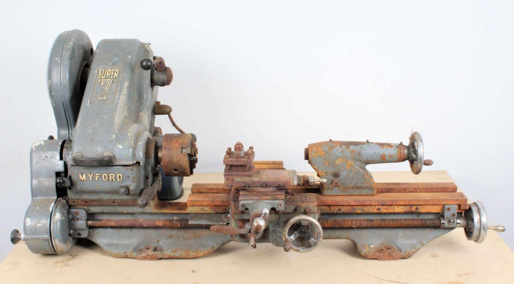

                    Hooray its sold- and not to me! I can abandon my devious schemes for smuggling it into the workshop unseen. and pretending I found it in the canal.
                    Hope the new owner restores it, even better if they posted a log here.
                    #578465
                    Bazyle
                      @bazyle
                      Sad that it got into that state. Once it was the pride and joy of one of our brothers, possibly traceable from the serial number. Imagine him saving for it, placing the order and opening the box once delivered. Perhaps eh made some engines that are already with someone else, then he became ill and couldn't get into the shed to play with it, then maybe the roof leaked and neither he nor his family noticed.
                      #578480
                      Bob Mc
                        @bobmc91481
                        I have to own up….I BOUGHT IT…!
                        When I looked at the original listing on SRS it confirmed br's post and said they were amazed when started up it ran quite well, inside the covers for gearing & headstock it looks quite good, the rest of it is seized up … at present…but it won't be for long..!
                        I should think the rust is likely not at bad as it looks but as to whether there are any problems with the bed .. time will tell, I have been looking for something like this for quite some time as my own lathe which has served me very well and is a joy to use is an Atlas 10F, unfortunately they have had a bad press but I believe the Myfords were based on these lathes, when set up properly it does accurate work.
                        The work I have done on the Atlas has given me the confidence to have a go at this Myford and I have just about re-made the Atlas over the years I have had it… I bought it from an old Mill in Stockport some 30 years ago for the princely sum of £25, it had been used solely for repairing the overhead power belting pulleys and I was told the mechanic who operated it asked to buy it when the company shut down, he was refused and took the tailstock as a memento.
                        If there is any interest I will post a log of how I am doing with it, and will probably be asking for advice somewhere along the line.

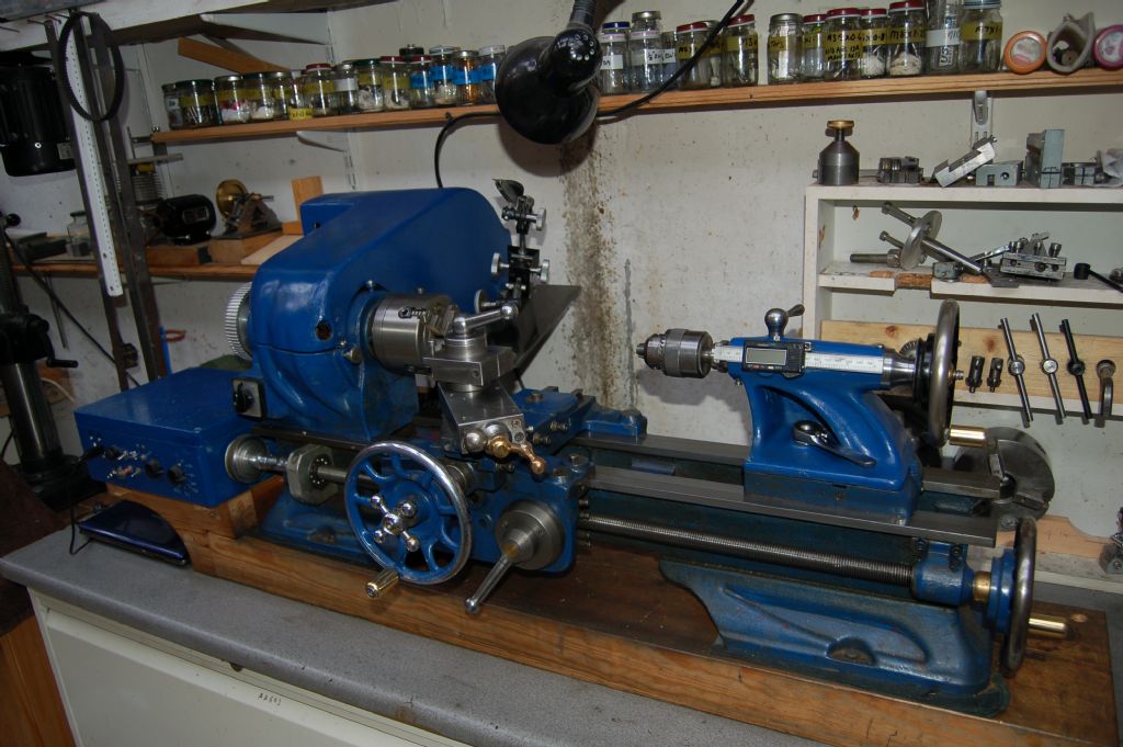

                                    nb.. picture of my old Atlas at the moment, which, if all goes well will be retired.

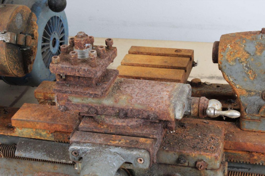

                                      Have been restoring the lathe over the past few months and I was thinking of writing a series of articles for MEW but have now decided to just put the log on the forum.
                                      For those who remember the picture below shows what it was like the day I got it delivered, I asked a certain editor what he thought of it, to which he replied that it looked like a badgers bottom..! Cheeky b****r
                                      The whole point of having a restoration project as this is to do as much as I could using the tools and methods that I have at hand and as economically as possible, otherwise I might as well go an buy a new one, so I make no apologies if some of these methods are not exactly industry standards, however I have used these same methods to restore an older lathe which has been quite remarkably accurate and is now a joy to work with.
                                      It has certainly been interesting and educating, and most enjoyable to bring something back to life.
                                      The saddle & cross-slide looked particularly nasty..below, totally locked up with rust.
                                      The clutch & pulleys being covered up were not so bad ..
                                      The main thing with this big lump is that it is quite heavy, I used a wheeled hydraulic motorcycle lifter so that I could move it around, the plan is to completely dismantle and start off cleaning the bed up.
                                      The bedways when cleaned up showed that there was ~ 5 thou" wear at the headstock end, there were other dings and dangs but I was pleased that it was not too bad and was something I could take on as a scraping project. I have a large-ish surface plate which I used to check flatness, the main problem being that without lifting gear I would not be able to put the plate on the bedways, the only way I could tackle this problem was to lift the bed up on the hydraulic lifter to the same height as the plate and gingerly roll in on the plate.
