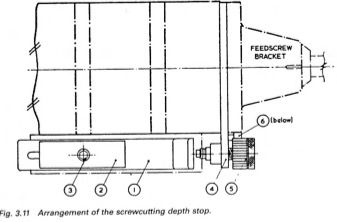

      A brain picking exercise. I have to make approximately 100 identical components. I have a form tool to create the external profile and have arranged the tooling for the tailstock turret to machine the internal features. Regrettably the material diameter is too large to pass through the headstock and prevents the use off my cut off slide as I will be chasing the material toward the headstock repositioning the cross slide and tailstock each time.
      I therefore need to create a positive stop for the cross slide to ensure consistent daimeter. I have a copy of the design published in MEW (a reprint from ME?) but this will not work due to the need to reposition the stop after each component with resultant lack of repeatability without resetting..

                  Robert
                  Tubal Cain described a screw cutting depth stop that might adaptable to your needs.
                  Basically it comprises a slide bar fitted to the top of the saddle using a hole provided for the travelling steady and a a fine adjustment screw carried in a suitably stiff plate trapped between the cross slide and the feed screw bracket.
                  As described the slide bar is about 6 3/4" inches long with a near 2" slot for adjustment. The bar is 3/4" x 3/16" material with a piece 1/2" equal angle brazed to the outside end for the adjustment screw to contact. A second piece of 3/16" sheet 15/16" wide is used for the plate that is trapped between the cross slide and feed screw bracket to carry the fine setting screw. The fine setting screw is 1/4" x 40 TPI (ME thread) running in a boss almost 3/4" long brazed to the carrier plate. Tubal Cain uses a grooved head on the adjusting screw with a flat spring steel "click" device fixed to a 4 BA screw.
                  My reference is Simple Workshop device published by Argus, also available as No 28 in Workshop Practice series, but no doubt it can also be found in Model Engineer and elsewhere.

                          Posted by Clive Foster on 24/04/2023 18:59:42:
                          Robert
                          Clive
                          Edited By Clive Foster on 24/04/2023 19:00:04
                          Clive thank you. I must be losing the plot, I have WP 28, looked it out and found a page marker showing TC's device which of course I had promptly forgotten all about!! This looks promising.
                          Any other suggestions however gratefully received.
