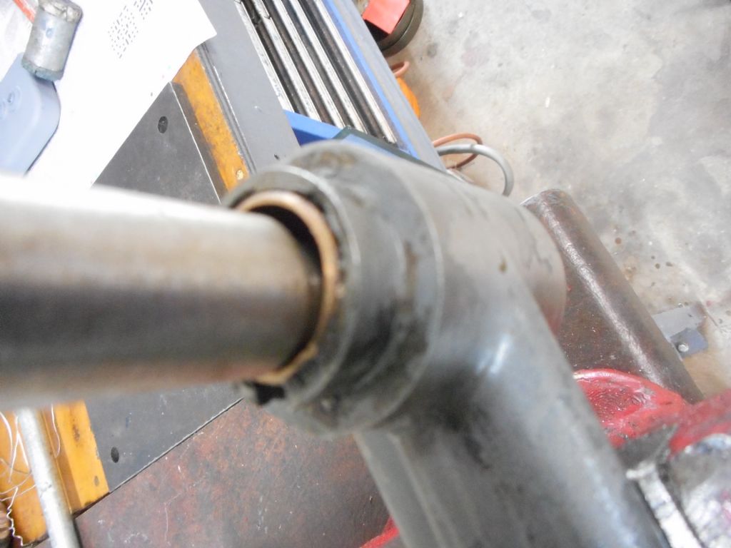

                  Thank you for the feedback. The bush continued to get warm within a couple of minutes without any distressing noises, so more investigation….
                  The bush was getting oil, but via a passage from the oil cup that passed through the bush directly onto the spindle. The smaller bush at the clutch lever end was fed in the same way. I thought that oil was to be passed through the Oilite bushes to the shaft?
                  I removed the countershaft today and found both bushes to be acceptable, whilst the countershaft was in excellent shape. Critically the small bush and the portion of the shaft in the bush showed enough oil to be well lubricated, whilst the large bush and its portion of shaft lacked evidence of much oil, even though I had pumped 32 hydraulic oil though the passageway.
                  I had also slackened the drive belt tension from that recommended by Fenner.
                  Measuring the countershaft showed its diameter to be 0,8750". The front bush was 0,8775". Is that the correct clearance?

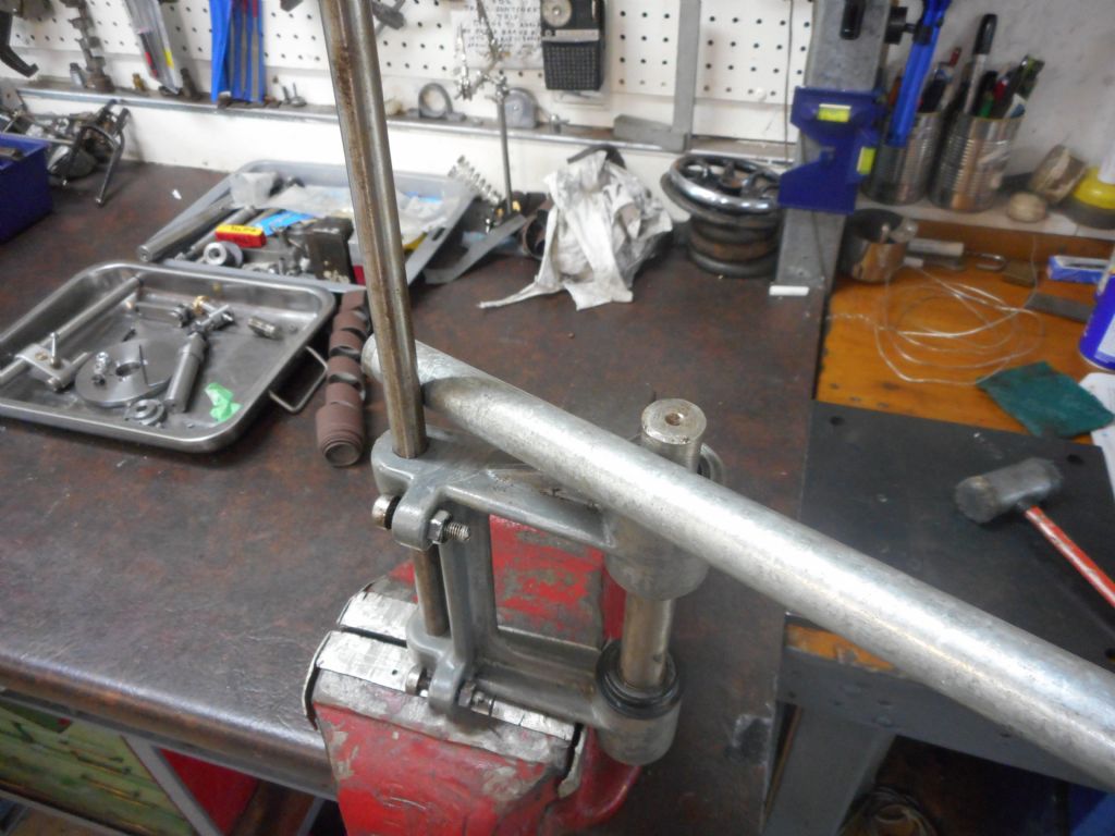

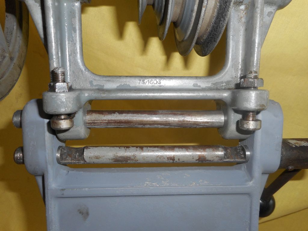

                            One thing to check is that the pivoting H frame that holds the countershaft could be bent out of alignment. This often happens on Myfords because of the use of that cheesy Mazak zinc alloy for the casting. (Rolls Royce of lathes my derriere.)
                            But also because users tend to use the adjusting screw at the right hand end to increase belt tension while leaving the hard-to-access one at the left unadjusted. This – along with belt tension – eventually puts a twist in the H frame, making the bushing out of alignment with the shaft (as in pic below) and shaft running on the edges of the bushing. This would make it run hot. Tell tale is one adjusting screw sticking out further than the other. See pic below.
                            Cure is easy enough. You can see the twist by eye, or by laying frame on flat bench. So hold the H frame in a good solid vice, or clamp it to the bench, and put a long piece of bar through the bushings where the counter shaft would normally sit and pull on the end of the bar to twist the cheese metal H frame back straight again. Or a longer bar between two pieces of bar through the H frame, as in the pic shown below.
                            With new bushings in place, you should be able to slide the countershaft, or a longer piece of rod same diam. (It's just a piece of 5/8" bright mild steel bar IIRC) in through one bush and it should enter and slide through the other bush without needed force, If not, pull on the far end of the long bar until the business end is properly lined up with the second bushing and it slides right in.

                                  I have a good length of 7/8" bar which I used to check alignment when I was doing the countershaft test yesterday. The 2 bushes were perfectly aligned.
                                  My S7 was in very good condition when I bought it in 1991. But your comments are a good warning to buyers.

                                          The symptoms suggest a damaged bearing, perhaps to the point it is indeed acting as an eccentric pump!
                                          In good condition the bush and shaft are both highly polished. When spinning there should be no metal to metal contact at all. Instead the bush and shaft are separated by a thin layer of oil at high pressure, several tons per square inch, over which the shaft floats. The pressure is created by the turning shaft, in effect slowly pumping oil in on one side, and out on the other. When working correctly the flow of oil is relatively slow.
                                          A big problem with this type of bearing is that when the lathe is stopped, there is nothing to maintain the oil pressure and shaft and bush come into direct contact. The two metal surfaces rub badly until the rpm is high enough for an oil film to form. Most wear occurs as the bearing is first spun up to speed and when the shaft grinds into the bush as it slows down. The collisions cause metal particles mix with the oil and have a scouring effect. Eventually the resulting scratches and pits get bad enough to stop the oil film forming properly, and metal rubs on metal more or less continually. When that happens the bearing gets hot, thinning the oil, and progressively causing yet more surface damage. Time for a new bush!
                                          Scoring happens very quickly when the bearing is run dry for any length of time due to a blocked oil feed, wick trouble , or empty reservoir. Even if it doesn't seize, the bearing is soon ruined. Maintenance is important!
                                          Provided it's lightly loaded and kept flooded with oil, a slightly damaged bush/shaft combination might last for many years. However, although most of the resulting wear concentrates on the softer bush, there's a distinct risk that the more expensive shaft will have to be replaced too. I think a persistently over-heating bearing should be changed as soon as possible.

                                              I changed the bushes on my early S7 some time ago. As you press them in, they get smaller. After some conflicting advice on this forum, I established that you may ream them as long as the reamer is really sharp, so that it does not rub. This was the advice from "Oilite" themselves on their web site. I bought a new expanding reamer, (cheaper than a solid one) and carefully brought the bushed back to size. Been no trouble since, and neither of them get warm, even with prolonged use.
