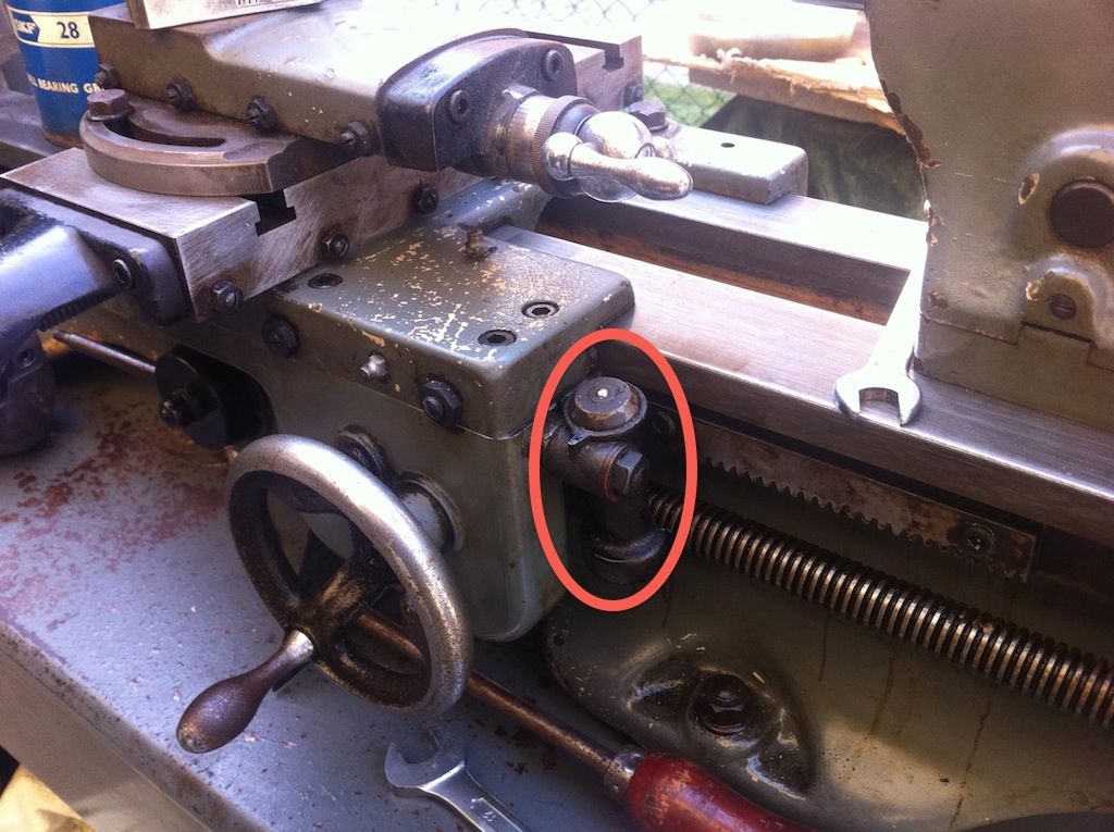

      Goodmorning everyone. I have a Myford S7 lathe. I am looking for a set to thread this screw. I measured 1 / 4X26 but I don't know if it's the right size because I can't find the tool to make the thread. You can help me?

          1/4 – 26 is 1/4 BSF

                Do you mean the screws which hold the saddle to the apron? If so, note that they have an over-size head to allow for front-to-back adjustment.
                I understand that difficulty in obtaining these in BSF caused Myfords to use metric fastenings here on later lathes.

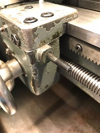

                    Thanks for your help, unfortunately I was unable to post a photo. Now I try to create an album again and see if I can load it
                    #576218
                    Franco Convertini
                      @francoconvertini28916
                      Evviva, ci sono riuscito. Ecco le foto con screw. Ho in mente di realizzare un stop carriage come questo. hemingway site

                            You need a 1/4 BSF nut and 1/4 washer to retain that Thread Indicator Dial.
                            Howard

                              And some sort of friction washer is desirable so that the TDI can be engaged and disengaged without the need for a spanner

                                I think Franco is making a new bolt to work with the Hemingway multi-position carriage stop.

                                      Surely a carriage stop held by that screw would be on the wrong side of the saddle

                                        It pulls a rod carrying a detented disc with multiple ?rod or ?screw stops up against a kind of 'arrestor-block' , I think..
