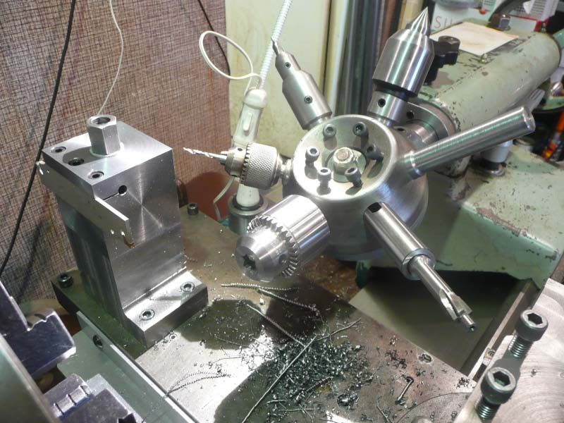

                                    ega
                                      @ega
                                      Clive Foster:
                                      "I'm convinced that the permanent fitting is a major reason for the success of rear mounted parting off tools."
                                      That's a very interesting and persuasive argument in the debate about rear-mounted parting tools and one which I have not previously seen mentioned.
                                      My first of these was the GHT design which, following Duplex, has an indexing and rotating two-tool turret. The merit of this is that the tool can be tailored to the job. This approach also allows the use of other tooling such as boring and knurling tools at the rear but requires a two-piece design – block plus turret – which may lose some rigidity.
                                      I've made two other toolposts for the larger lathe, the current version being equipped with an ISCAR tangential tool:
                                      I may mill a slot in the other side of the turret for another tool. Turret is non-indexing at the moment and when I need to set the tool I refer it to a straight edge against the chuck, etc.
