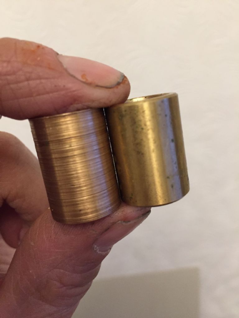

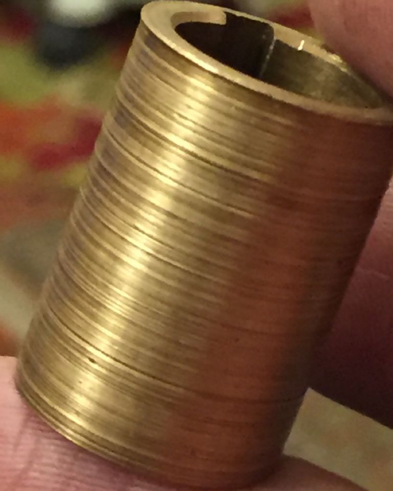

  • #344885
    C J
      @cj88518
      Bush from the right of the box.

        #344888
        KWIL
          @kwil
          Looks worn out, identify from Myford Parts List?

          #344925
          David George 1
            @davidgeorge1
            Looks like wrong material it looks like brass not phosphor bronze.

            #344936
            Neil Lickfold
              @neillickfold44316
              That can happen if the box does not have oil in it.
              #345395
              C J
                @cj88518
                I've now bought a replacement and the worn bush on the left is definitely a different colour to the Myford bush on the right?
                What might have some bearing on the wear (no pun intended) is that when I got the lathe home I noticed the lead screw was going tight and loose when rotated, and when I undid the bracket near the tailstock the lead screw sprung down about 5mm and became free rotating, and I think this misalignment was caused by the quadrant which sticks out underneath the end of the quick change gearbox getting a nudge upwards at some time.
                How long it has been like that I don't know but I think the misalignment could have been a factor in the wear on the bush.
