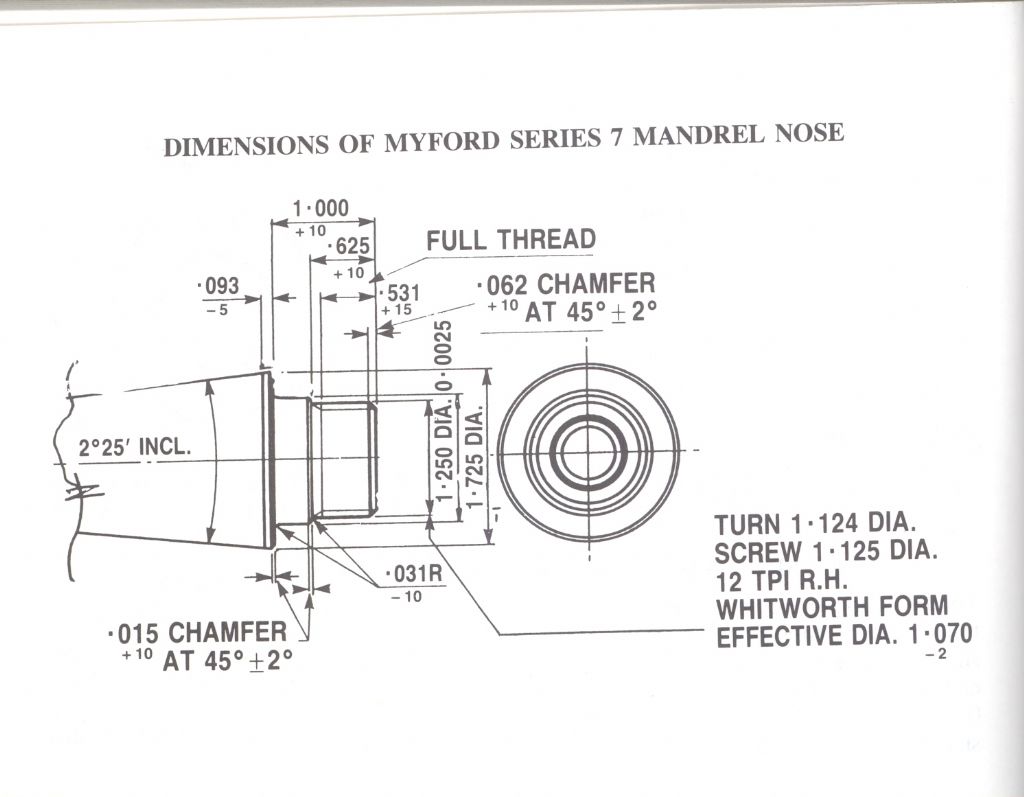

      I am cutting a thread for a myford 12tpi and I am asking if anyone can give me the diameter of the thread root as I want to cut a witness for the depth before I start.

          Look here for 1 1/8 Whitworth spec, you need the core diameter

            Whitworth thread depth is .6403 x pitch.
            But lathe spindle nose threads are often machined a tad undersize so that all location is on the registar collar and not on the thread. Best to machine up a threaded ring that is a nice fit on your spindle nose, then machine your spindle nose thread to match that.

              1.036 inches will give you a nice run out for the thread.

                Bricky, my error forgot to say in the tables you need to look at the thread depth for 12 tip and deduct depth x 2 from the O/D thus 1.125 – 0.054= 1.071 make a small allowance for clearance so I would make the undercut 1.060 + 0 – 5

                    On my S7 the nose thread is not a true Whitworth form with rounded crests, the thread form is pretty sharp.
                    Normally the OD of a BSW thread is rather less than the nominal thread size because the rounding of the thread crests and roots occurs within the theoretical 55 degree triangle of the thread form.
                    If the Myford nose were a true Whitworth form then the measured OD would be 2 x H/6 less than 1.125" but my nose is exactly 1.125". In light of this you might want to consider cutting your thread to the depth of triangular height H rather than for the depth of thread h. For 12 tpi the relevant dimensions are H= 0.083, h=0.053. (Illustration and figures from Machinery's Handbook 25)

                          The follow on page of Machinery's Handbook gives the OD of Whitworth as being the decimal of the nominal size. 1 1/8" dia is 1.125" before the assembly allowance is applied. The truncation amount x 2 isn't taken off the nominal outside diameter. Likewise the same on Unified and ISO Metric. which start at that nominal OD after truncation from the sharp V, in that case H/8. The effective diameter is the all important thing then so if the effective dia of BSW form is say 0.010" under then we would expect the OD to be a similar undersize to keep the full radius on the crest………………. bit we can't get that easily with a single point tool unless a good die is run over it at the finish.

                            Here it is, courtesy of Tubal Cain. Model Engineer's Handbook

                                  "Here it is, courtesy of Tubal Cain. Model Engineer's Handbook"
                                  Treat this drawing with great caution because it is riddled with errors. Just to point out a couple, both the thread diameter and the register diameter are incorrect. The taper on the bearing is also shown as 2.25 degree, instead of the correct 12.25 degree.

                                    I have in my hand a BRAND NEW S7 spindle.
                                    Dimensions as follows:-
                                    Register Diameter 1.250"
                                    Thread diameter 1.124" (over crests)
                                    End of Front Cone 1.725"
                                    The Front Cone Bearing taper angle may be incorrect, I have not measured it though.

                                      Apologies- l misread which dimension related to which arrowed lines on the thread and register diameters. Bearing taper is definitely a typo however.

                                        OK, looks like I got my reasoning wrong, so thanks guys for the correction. I still think though that if the OP cuts his thread to the theoretical depth for 12 tpi that there is a pretty fair chance that it will not screw on to the Myford nose – that has been my experience anyway.
