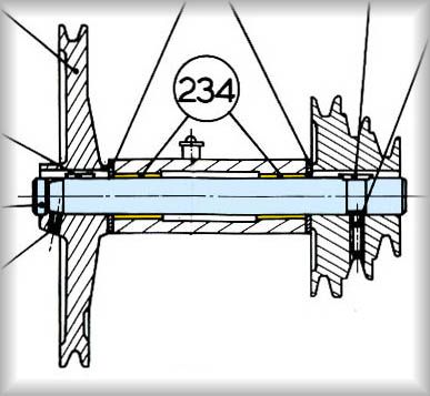

      My ML10 has way too much play in the countershaft. Guess I’m going to have to fix it. (* sigh! *)
      Myford no longer sells replacement parts of the countershaft. This shouldn’t be a problem, since Oilite bushings can be sourced elsewhere. Also, the countershaft is not an overly complicated part and should be within my admittedly modest machining capabilities if it comes to that. Nevertheless, I do have some questions…
      1) Does anyone already have the dimensions of the ML10 Oilite bushings? Length, outer diameter, inner diameter?
      2) The same question goes for the steel countershaft. Does anyone have the measurements of same? Or even (gasp!) measured drawings?

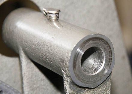

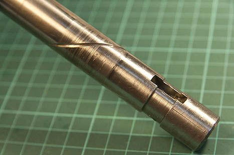

                      I bit the bullet and disassembled the countershaft assembly to inspect for wear and/or damage. I was surprised to find that it does not match the technical drawing in the Myford ML10 manual.
                      This is obviously an earlier version of the countershaft unit in which no bronze bushings were used. Instead, the cast iron was bored out, with the steel countershaft running within it, somewhat akin to the way the lathe spindle of the ML10 is carried in the cast iron of the headstock. The difference being that the steel of the countershaft is not hardened. Also, the countershaft sports two grooves at the lathe end to help distribute the oil.
                      The photos of the journals of the casting and the ends of the countershaft show wear as well as an amount of galling. This unit was evidently run dry at some point, much to its detriment.
                      The wear is not evenly distributed. The journals in the cast iron measure as large as 0.753” at the motor end, and up to 0.755” at the lathe end. The steel of countershaft seems to have taken the bulk of the wear, measuring 0.7233” at the motor end and 0.7235” at the lathe end.
                      All of this translates into a fair bit of runout – as much as 0.0297” = slightly more than 0.75mm (ouch!). No wonder this joint has been weeping oil.
                      My assumption is that the steel of the countershaft started life as a true 0.75” and that the journals were bored very slightly larger. Perhaps someone would know what an acceptable beginning tolerance would have been.

                      If I simply repair the shaft to bring it back to a true 0.75” – either by bronze brazing or else a complete re-machine – I will have cut the total runout to something like 0.005” which is already way better than what I’ve got. But this begs the question. Will the galling in the cast iron journals just start nibbling away at my new shaft? I’m thinking that the galling will have been worn down a bit over time, but this is only surmise (or wishful thinking).
                      I have no machine at my disposal to bore out or hone the cast iron journals… excepting if I tried to sort of use the ML10 as a hand-turned device to do the work with the cast iron countershaft unit somehow clamped to the carriage. Scary!
                      Another thought was maybe to run a hand reamer through the countershaft journals to clean them up. That would be either an adjustable reamer, or else a carefully-chosen, oversize reamer. Naturally, I would have to slightly oversize the bearing surfaces of my steel countershaft to suit.
                      What would be my chances of success with this approach?

                              The quick and easy way to repair would be to use a length of 3/4" diameter bright mild steel bar to make a new shaft and run it in the bearings as they are, or maybe after a very light hone or ream to knock any roughness off. Yes there will be a few thou of slack but not enough to stop proceedings.
                              If you want perfection, hand ream the holes until they are cleaned up and both teh same size, and in alignment, then machine a custom shaft down from a piece of 7/8" or 1" bright mild steel bar to suit the diameter of the bearings, with a one thou clearance for oil. Then fit some small drip oilers (available cheep cheep on the net from China) to keep the lube up to the bearings.
                              If you want modernization, buy a used part from a later ML10 with the sintered bronze (oilite) bushes and fit new bushes. These hold oil in the porous material and won't need the drip oilers providing you remember to add a few drops of oil every day the lathe is used. Then sell your old part on fleabay to recoup part cost.
                              Personally I'd go for option one and see how it goes for a while. If not happy, search around for the part for option 3 while still using the option one repaired part.

                                My path is clear. EP 90-weight oil to keep the countershaft happy and running in the short term.
                                After that I order some 3/4" ground stock and machine a replacement shaft. This should bring me up to (only) slightly sloppy but workable runout on the countershaft.
                                When time permits I can the think about possibly reaming the journals and machining a slightly oversize shaft to match.
