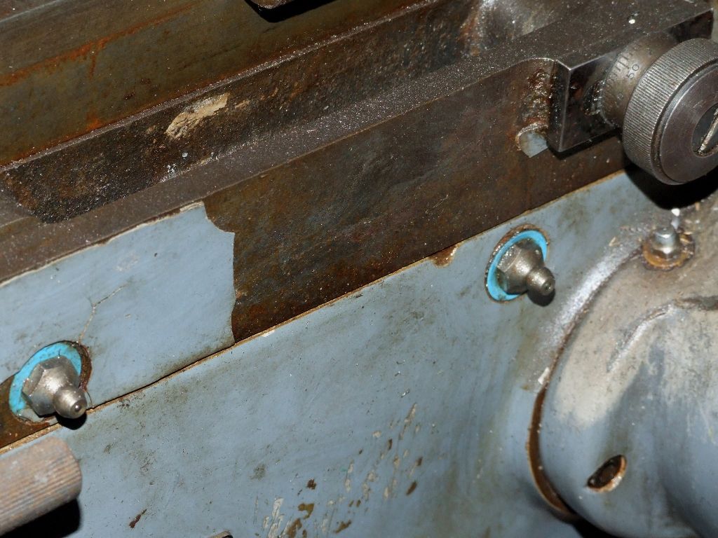

                          Andrew how are your grinder ways lubricated? Mine has grease nipples which naturally someone has pumped full of grease instead of way oil, hence the advert stating that the motions were a bit stiff.
                          It would be nice to find a lubrication chart. If not i'll be going for ISO60 way oil and BL10 for the spindle drip oilers.

                              Posted by Pete Rimmer on 25/05/2020 06:13:35:
                              Oil nipples:
                              The nipples are colour coded, although I'm not sure if that relates to the oil type or simply the size of the nipple. If you PM me an email address I can scan the relevant pages in the manual and the sheet I have from Myford listing lubricants for their machine tools. There are some inconsistencies between the manual and sheet. I bought ISO15, ISO32 and ISO68 slideway oils from Myford when I first got my grinder.
                              Andrew

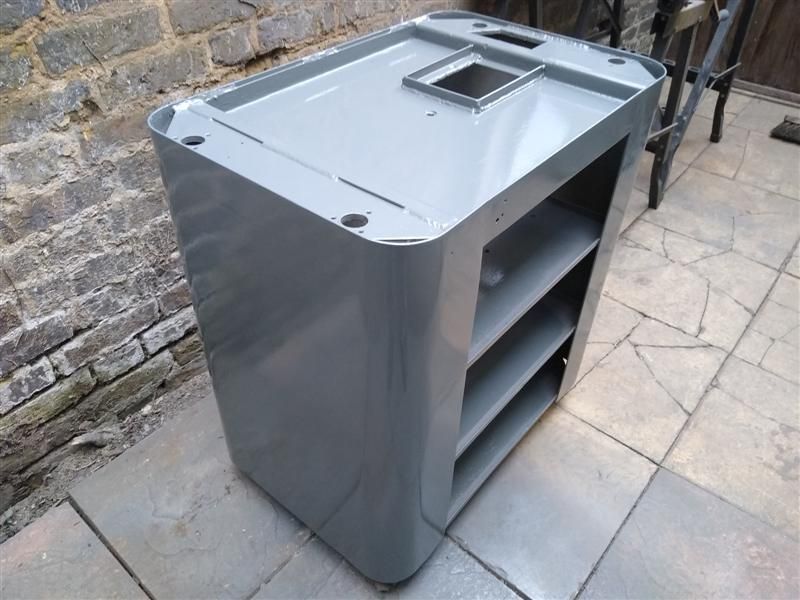

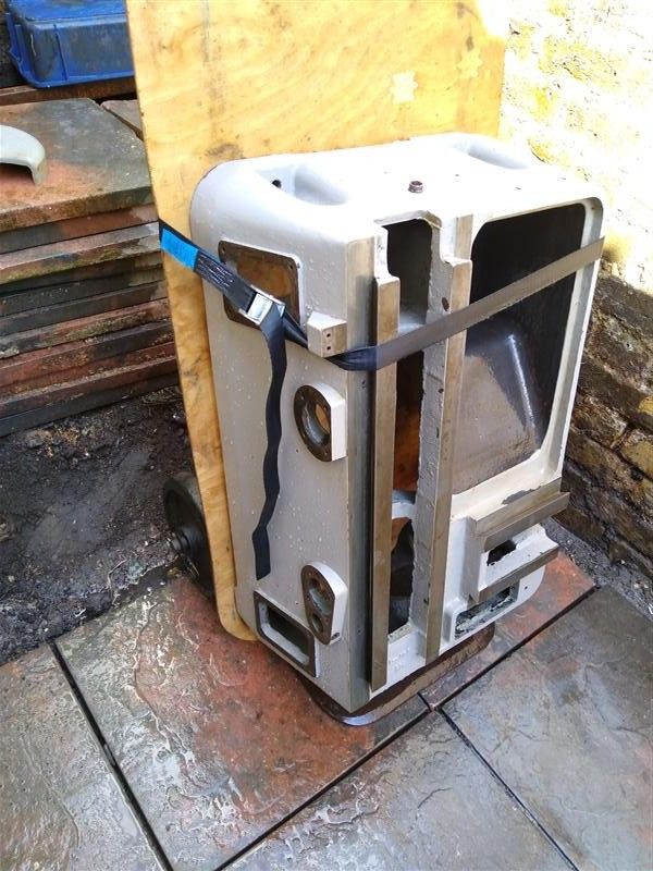

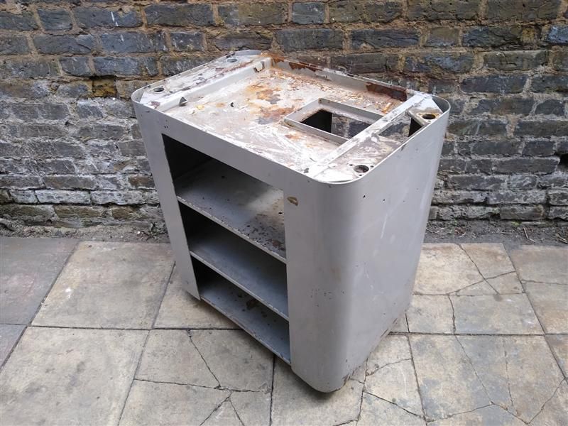

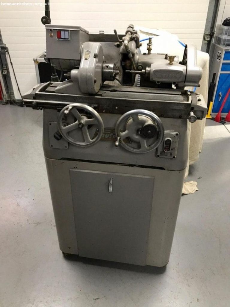

                                My thanks to Andrew for sending me some lubrication info. He is correct in saying that the machines are actually quite different as regards lubrication and it's clear that the MG12 is a more advanced machine but it at least gives me some pointers.
                                Anyway, here are some pics for anyone who is interested.:
                                Advert pic:
                                The seller remove the top from the base for me to load it and that exposed some hidden flaking paint. So right away the cabinet was sanded, primed and painted.
                                Before:
                                After paint:
                                I also gave the main casting a damn good clean with jizer and a jetwash

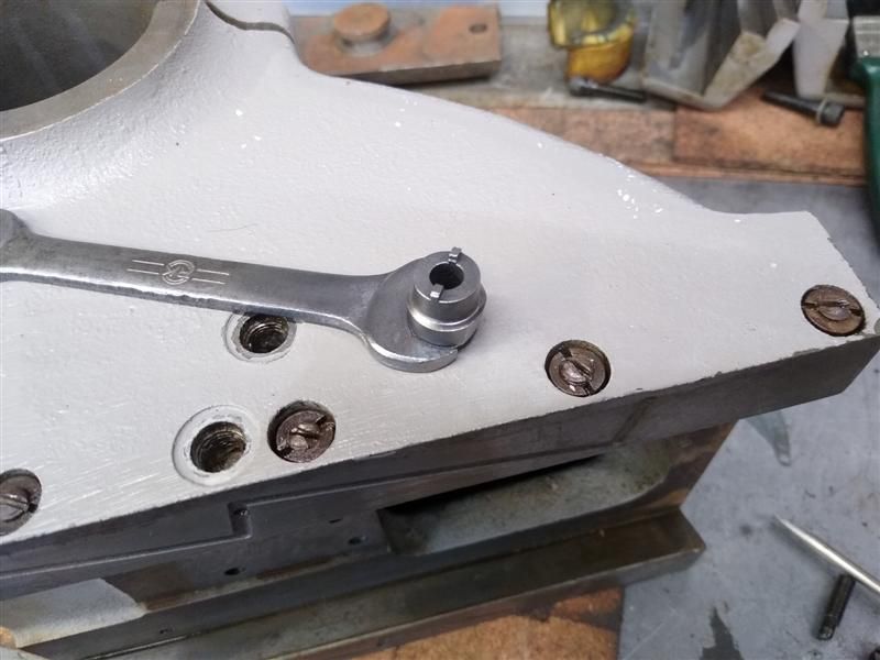

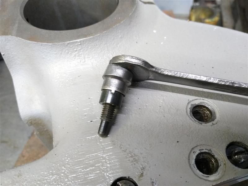

                                Whilst that was drying I set to making a tool for adjusting the gibs. Someone had tried to adjust them without a proper way to turn the locknuts and made a mess of the screw slots, This tool will help me to adjust them properly.
                                A nice snug fit.
                                Looking forward to getting this machine rebuilt so I can use it. I have a number of jobs that will be so much nicer with a ground finish.

                                  Lucky boy, that looks like a fantastic little machine.

                                    Good grief, that's excellent work, and fast too. I'm now embarrassed to have posted pictures of my MG12 with its tatty paint. embarrassed
                                    Andrew
                                    Edited By Andrew Johnston on 26/05/2020 22:23:14

                                      Thank you both. No shame in showing pics of a well used machine Andrew – I'd rather see a machine put to good use than a show queen.
                                      By the way I have four unused holes in the rear of my base casting and something missing that should be on the rear of my wheelhead slide. Looking at your album pics I see a counterweight on your machine. I don't have that, I wonder if the MG 9 came without one or if it's missing?

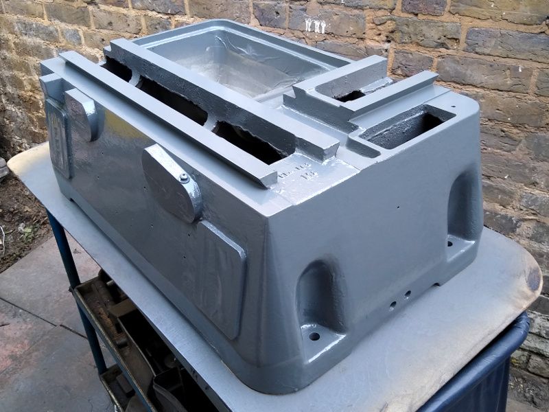

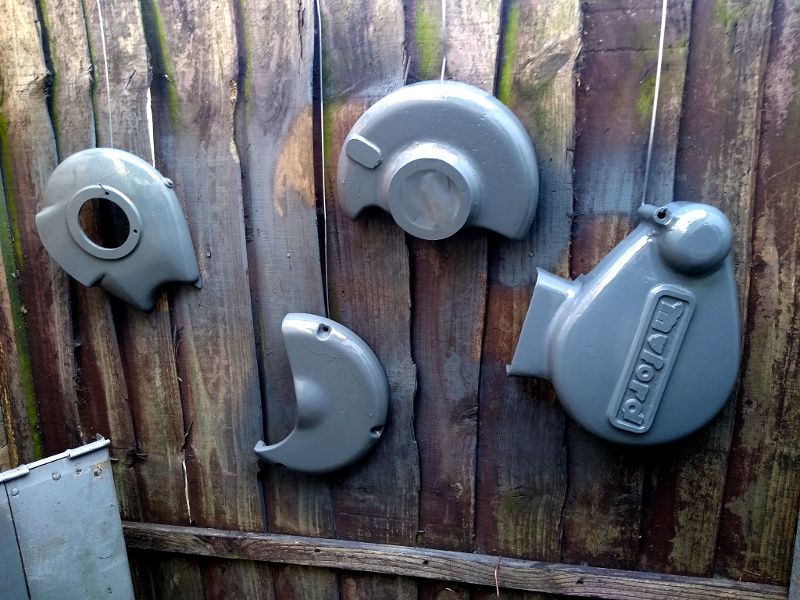

                                              Painted the base casting and covers today. I hate painting and I'm not much good at it so I was satisfied with just a couple of runs
                                              That's not my garden fence by the way – it's a knackered old panel I stood up for something handy to hang the bits off.

                                                Are you intending to re-align/re-scrape the ways after the painting?
                                                #475474
                                                Pete Rimmer
                                                  @peterimmer30576
                                                  Posted by Mark Rand on 27/05/2020 23:26:29:
                                                  Yes for sure. It has some wear but not too much and the long ways are worn the same all over so the geometry should be preserved. I do have to find a long enough dovetail straight edge to borrow though. Also I am going to have to figure out how to support the table for scraping. The profile is too long and thin to stop it from bending under it's own weight. Perhaps I will lay it on top of a large surface plate and let it over-hang 6" either side, or I might just send it for grinding, not sure yet.
