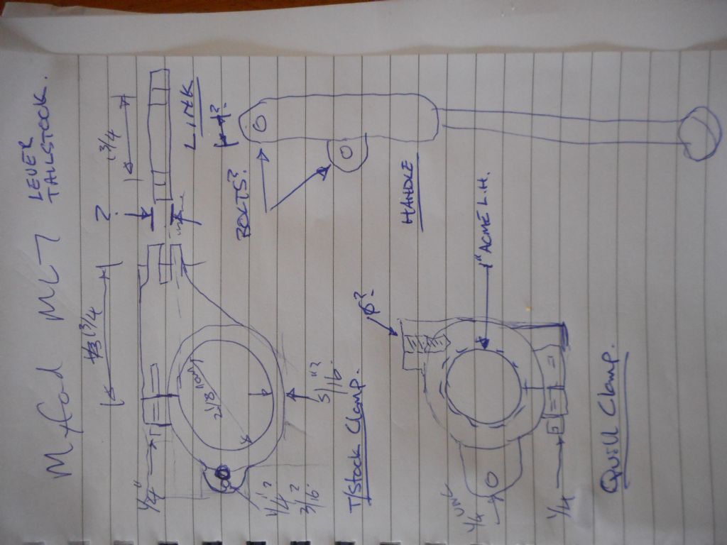

        Following on from this thread here LINK I am in the process of making both a 1929 sensitive drilling attachment plus my own copy of the original Myford ML7 lever action tailstock attachment. I am reverse engineering the latter from pics of the Myford original on the internet.
        The plan so far: (Can you tell I once worked in the drawing office for three months?)
        (Sorry once again about sideways image. Can't seem to fix it. Perhaps the mods once again could fix it, pleeeze?)
        But I am short of a few critical dimensions. What I can't measure from screen pictures is the thickness of the link that goes between the tailstock body clamp and the main hand lever. I am guessing it would be a piece of flat bar about 3/4" x 1/4" (20mm x6mm) but not sure.
        Also, I am unsure what size the pivot bolts in that link would be, and the third main pivot bolt that connects the hand lever to the tailstock quill clamp. I am guessing 5/16" but not sure. And are they just plain bolts, or are they shoulder bolts with a plain shank and smaller diameter thread?
        If some kind person who has an original Myford lever attachment could measure the link's width and thickness and those bolts and let me know I would be forever in your debt. So far it is the only remaining stumbling block.

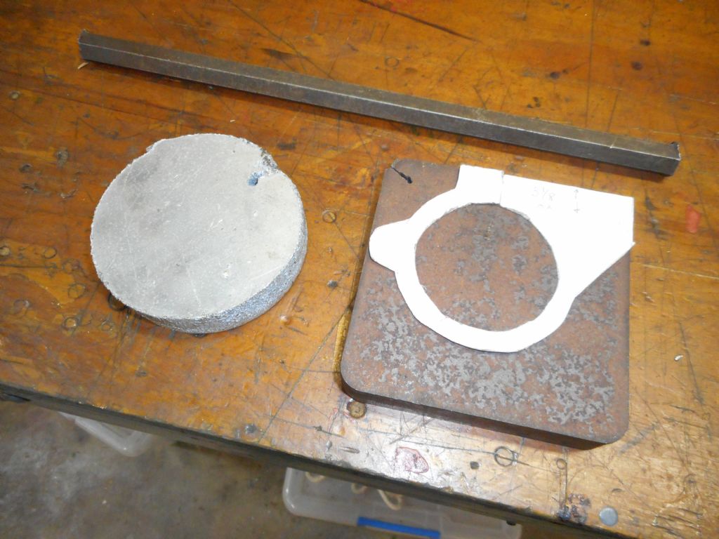

        I have made a start already, digging a piece of 3/4" thick steel plate and similar alloy plate out of the scrap box and making up a couple of paper templates just as "proof of concept" so I know the material will be big enough. Turns out they are so have carried on making better drawings and laying out.
        Both pieces are scabby old offcuts from the metal yard where they have cut these holes out of plate, hence the laser/plasma starting hole in each. The hex bar is to make the pivot bolts if they are not standard bolts.
        Will be a bit of working cutting these out on my new horizontal bandsaw and doing the rest in the lathe as I have no mill. Happy days.

        noel shelley
          @noelshelley55608
          Be patient, I will measure the one I have later today and get back to you. I will have it in front of me and will be able answer the question. The earlier ML7 is different from the later ML7 and Super 7 tailstock. Till later, Noel.

            Thanks Noel. That sounds great.No rush. I am off to bed here shortly in Upside Down World.
            I think the Super 7 link and pivot bolts are somewhat similar dimension, from looking at a million pics on the net. This, below is the one I am copying. I am also trying to work out what sized square bar to use to make the handle. The square where it attaches to the link looks to be about 3/4" square to me, but again not sure. Of course I have half inch and one inch square in stock (the scrap box) but no 3/4"!
            And is the round part of the handle 1/2" diameter?
            I have thought about putting the Super 7 type offset handle on it but that may have to come later.

            Also am I right in thinking the adjustable stop bolt at the front would be 1/4" diameter?

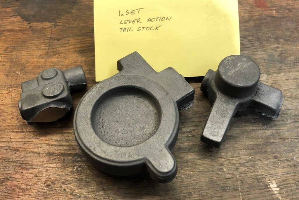

                Hi Hopper into Drummond Myford group we are having a few castings remade and tailstock lever feed is one of the products being 're-cast
                https://groups.io/g/drummondlathe/topics?p=recentpostdate/sticky,,,20,2,0,89675718
                Just thought it could be useful for you.

                  Thanks David. Very handy. Yes I think it would fit a Myford. The ML7 tailstock is 2-1/8" diameter where the clamp goes, and the Drummond is 2 -1/4". I have been a member of the group since Yahoo days but still have trouble navigating it to find specific things. I see a post by Rob Gough that castings are available and at a good price too.
                  But shipping to Australia has gone stupid since Covid. It's now 30 quid for a small item, and 60 quid and upwards for anything with a little weight, like castings. Plus there is now a 2 month backlog of parcels sitting in customs in Sydney. A parcel Myfords dispatched to me on Feb 7 got to Sydney Feb 9 and tracking now says it's in Customs and expected delivery date is April 7! So I have made a start on my fabricated version as I would like to be using it next week.
                  Are drawings available anywhere for the Drummond lever action? Could not see any in the .io group's Files section. And looked up Geoff Walker's article in MEW a year or three back but it was for a different type of lever action that keeps the handwheel in place, an ancient Ian Bradley design I think. It might be helpful if I could see the drawings just to double check what I have surmised from looking at pictures.
                  Shame about the postage. I really would like a set of those castings and the apron mod ones too.

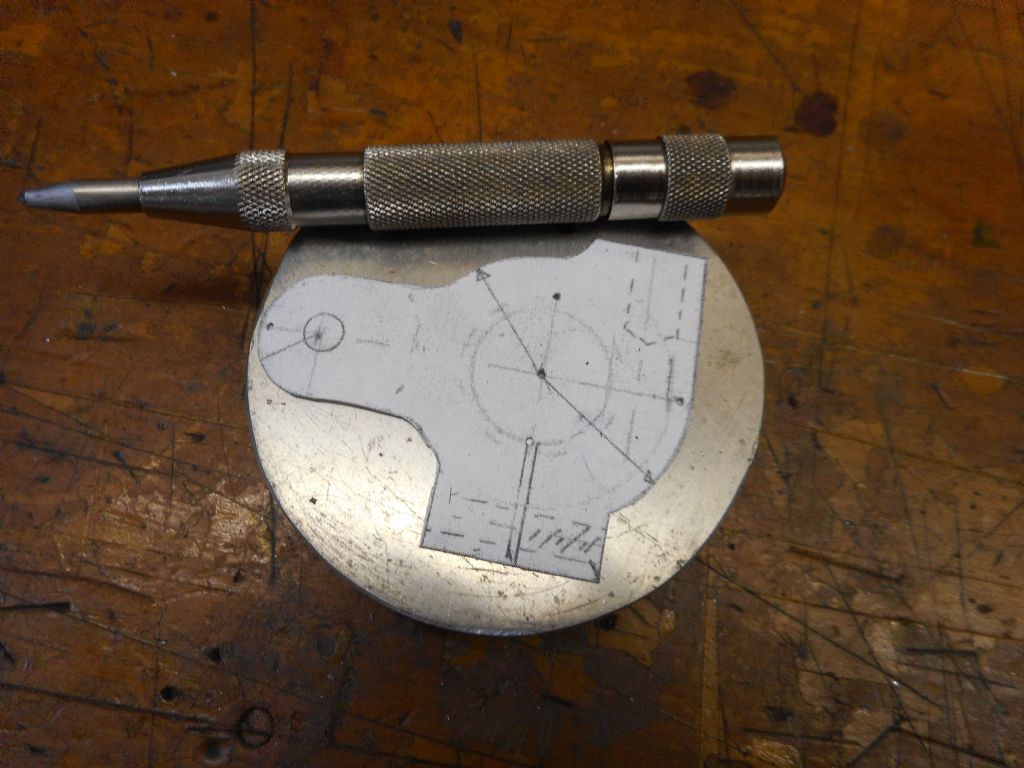

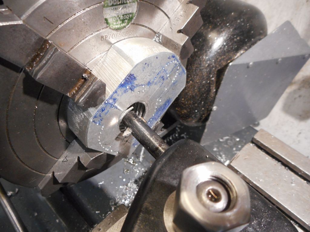

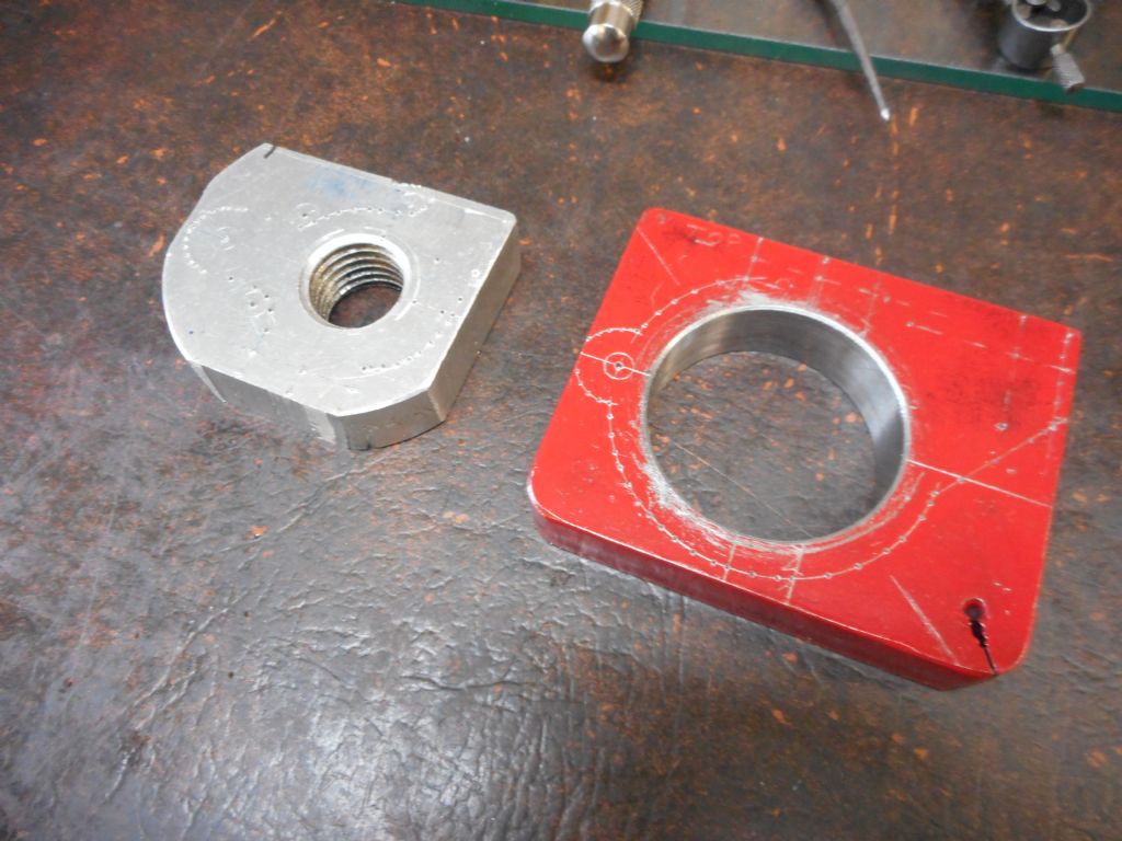

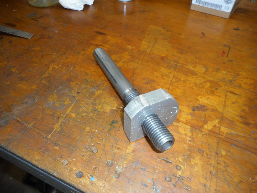

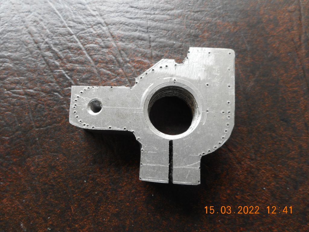

                      I have made a bit of progress since yesterday's post.
                      Marked out the quill clamp, bandsawed the circle of ally roughly square so I could grip it in the chuck and screwcut the 1" LH Acme thread to clamp on to the quill. Good thing I centre popped the outline as the blue marker pen does not stand up to heat or swarf at all.
                      Came up good though. Screws right on the quill like a bought 'un.

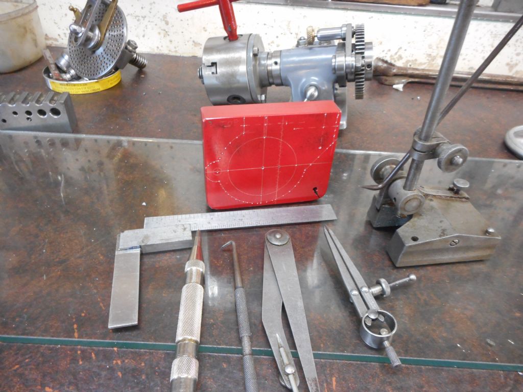

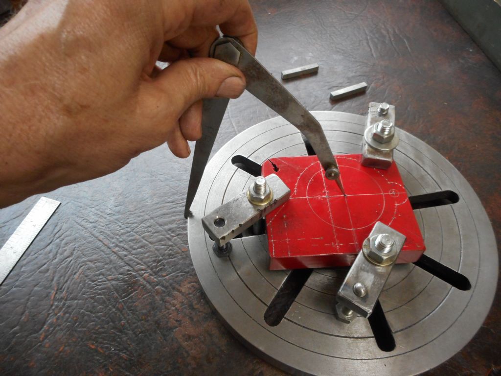

                      So not being willing to pay $50 (25 Quid) for a small spray can of Dykem layout blue, I used "marking red" on the tailstock body clamp. Aka a bit of leftover spray can paint. Marked it all up in the traditional manner with a sheet of plate glass and marking gauge plus the usual dividers, square etc. The only problem with the paint is if you make a mistake, as I did of course, you can't just quickly paint over it and carry on!
                      Set it on the faceplate on parallels all done on the bench so the parallels don't slip out all time and cause bad words to be uttered. And found a super easy way to make sure the job is set up well centred before mounting the whole thing on the lathe. A pair of jenny leg (hermaphrodite) calipers measuring from four points around the perimeter soon got it dead nuts on.
                      Well, within six thou or so anyway. Two little taps wiith a brass bar and it really was dead nuts on. Not that it's particularly critical in this instance, just whiling away some pleasant time.
                      Edited By Hopper on 14/03/2022 10:38:31

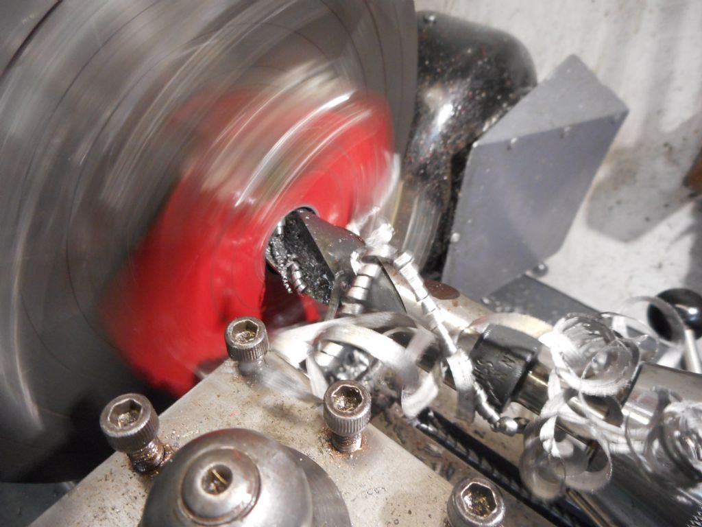

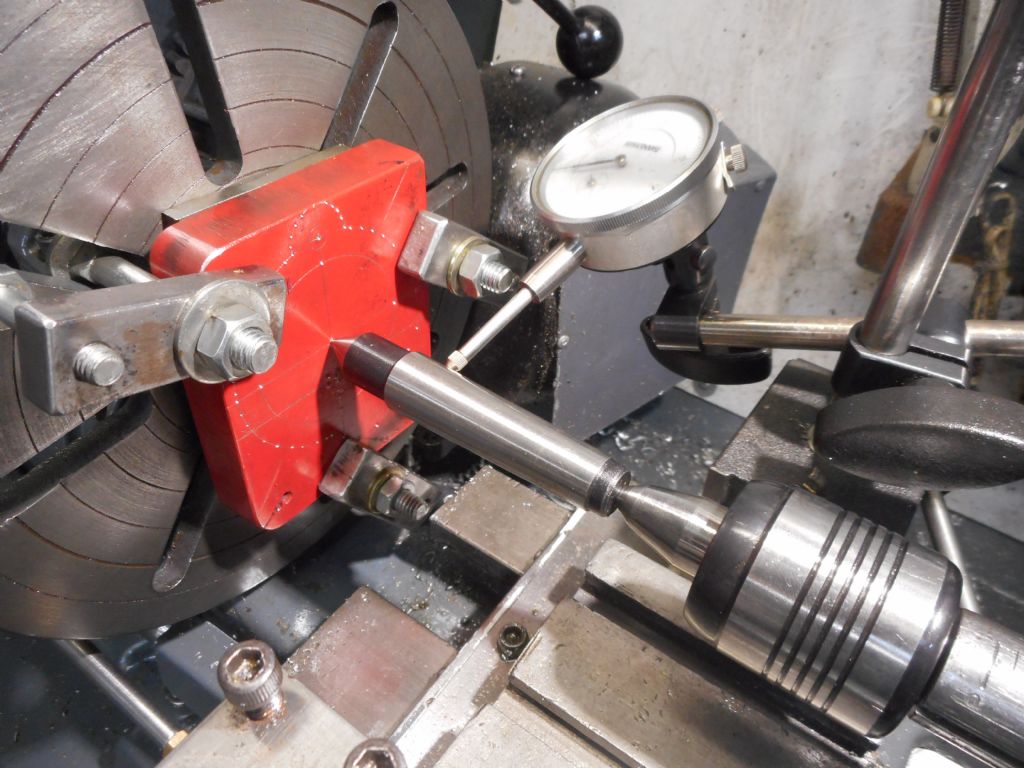

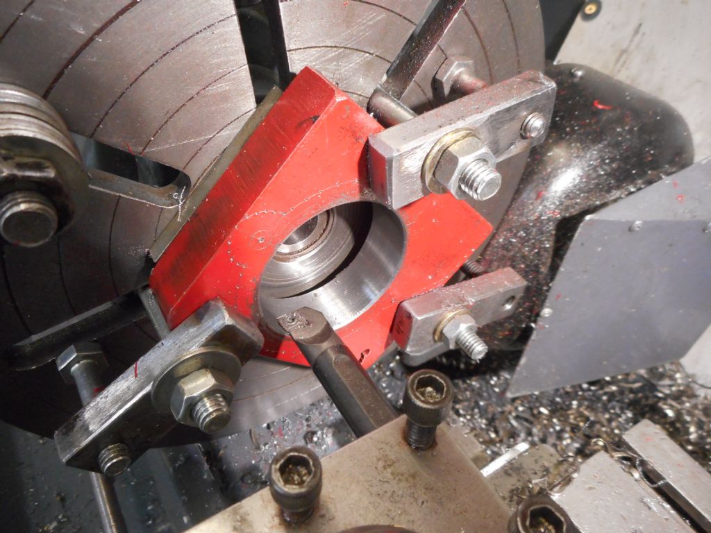

                          And spent a boring afternoon.
                          This was when I wished I had a lever tailstock. Punching a 1' drill through after a 1/2" pilot.
                          And the boring bit: opening the drilled 1" hole out to 2-1/8" with repeated 70 thou deep cuts. Any more than that and the whole thing carried on like a pork chop.

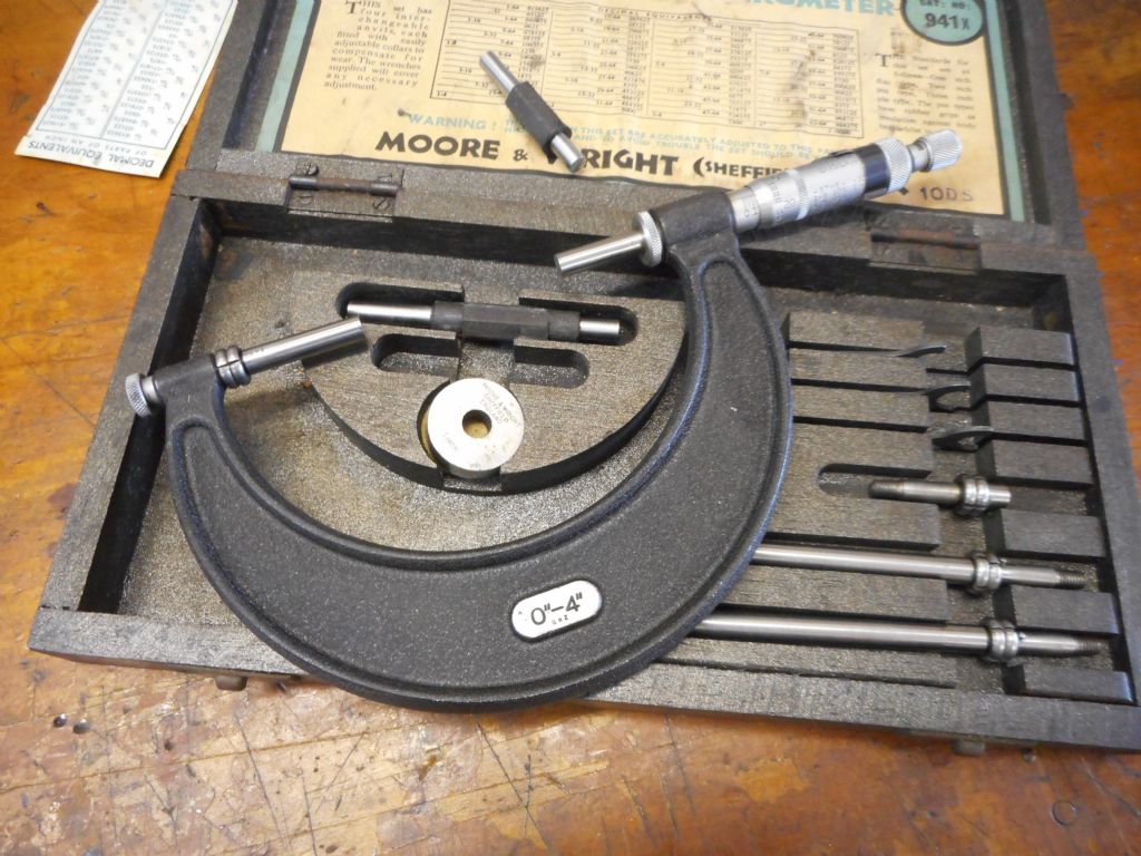

                          And an excuse to use my latest garage sale treasure, an M&W 0 to 4" micrometer, still in its original box. Used with a telescopic T gauge it got the hole spot on. The tailstock boss slid right in as if it were designed to do that. Good measuring tools are so nice to have.
                          So that's the easy part done, the two round empty spaces in the middle. Now on to the tedious bandsawing and grinding and linishing of the complicated outside shapes. (Wish I had a set of those castings!!!)

                              It's unnecessary to screw cut the clamp, all that is needed is a good fit to the threaded section – per my original Myford ML7 lever feed tailstock which is still in the workshop. The clamping screw does the rest.

                                Beat me to it Robert the original Myford one was just a well fitting plain bore and pinch bolt

                                    I have the exact same 4 inch micrometer here, picked up at a club auction more than 20 years ago. A really useful bit of kit. It is complete with all the little spanners and calibration pieces too.
                                    I've just come inside from a similar piece of work on the lathe, but the hole I needed was 75mm in a funny triangular shaped piece of inch thick alloy. I had to reverse rwo jaws of the four jaw chuck to get it into the Myford.

                                          Hi Hopper, The lever is 9/16 dia 12"long + 1/2" for thread, can't unscew Knob that is 1.25" dia. The link is 3"long, 3/4" wide and 1/4" thick 2 holes 2.25" apart, 7/16 dia. Pivot bolt 1.385" long over all, head .6"AF, .2" Deep,pin 7/16"dia .715" long and thread 5/16" BSF.470" long., 2 OFF The 3rd pivot bolt is like the others but the pin is .7" long and thread slightly shorter.at .375" The depth stop is 3" long, 5/16" dia with a .040" deep flat milled on. pinch bolt is 1/4"BSF x .5 long. These dimentions are from a unit for a Super 7. Just looked at you last pic My unit has no thread in, the lug on the bit that goes on the tailstock is drilled 5/16" with a pinch bolt and flatted rod.  If you need more then get back to me. Best wishes Noel.

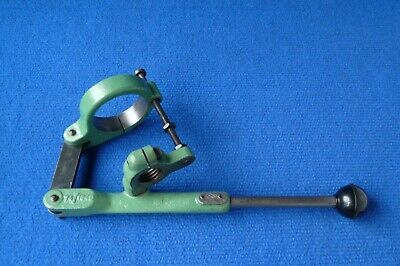

                                                PS, Noel, is this the type of lever tailstock you have, below? With the offset handle rather than the earlier straight handle? If so, one more question: What is the centre distance between the two pivot pin holes in the handle?
                                                And is the handle shaft parallel to the line between those two pivot holes or is it angled back slightly? Cant tell from pics for sure.
                                                I am thinking now that I might make this type of handle rather than the straight one in my earlier pics. Looks like the pivot bolts are closer together so more leverage given, and the long handle can be slid in out of the way or for less leverage on small jobs. There must be some reason they changed from the straight handle to this one??  Bit more of a fiddle to make, but I reckon I could fabricate it from two pieces of square bar welded together.
                                                Edited By Hopper on 16/03/2022 01:41:17

                                                  The type in the picture above is the one I fitted to my ML7, I bought it secondhand and was never sure if it was a Myford made item or third party. Never seen another one that I can remember, I left the operating arm loose in it's bore ( I think there was a grub screw) and it could be slid in and out to vary the leverage and keep it out of the way.
                                                  Always found it a useful addition to the lathe, would make a good project for fabrication, following this thread with great interest.

                                                    Hi Hopper, Pivot pin holes are 1.625" apart. The pinch bolt is 1/4BSF. YES there is a small angle between the pivot bolts and the handle, I will measure when I get home protractor is at work !
                                                    Dave, Yes this is a genuine myford part. The made 2, I have the other one ! Myford did in fact use third parties to build a lot of their parts. If the one you have is as the picture then there should be a 1/4"BSF clamp bolt to lock the handle.
                                                    The one I have is new, bought with the longer S7 tailstock barrel missing, one day I will get round to making one !!!!!

                                                      Here is the other type, presumably the earlier model, with the straight handle. It looks to me to have about twice the distance between the two pivot pins, which would give half as much leverage on the quill. Strange. But I believe this one too is a genuine Myford product as it is all over the net as such.
                                                      Compared with the later/Super 7 type Noel has
                                                      Will post an update on today's progress when I can upload pics. No wonder there are few in depth build threads on this forum. The pic process is painfully tedious, or tediously painful. Not sure which.
