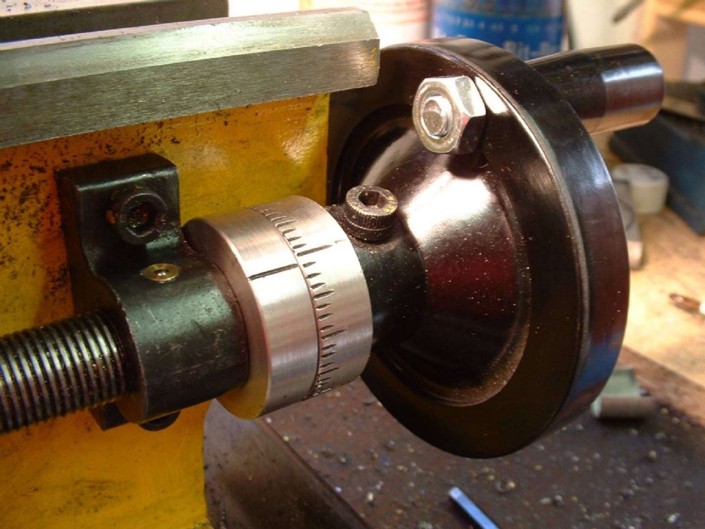

                            #186859
                              Hi Eric,
                              I've made both mods to my mini-lathe. Details of Alastair Sinclair's mini-lathe leadscrew handwheel mod, including plans, are included in an article which is being reprinted in the 25 Years of MEW special.
                              For comparison, my leadscrew handle is graduated in 1/1024" steps (rough 0.001&quot the apron handwheel dial is graduated in 0.01" steps. They have complementary uses.
                              Edited By Neil Wyatt on 18/04/2015 17:44:53

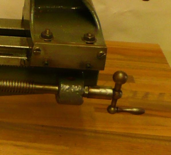

                                          Georgineer
                                            @georgineer
                                            Posted by Colin Cutts on 10/10/2017 17:06:37:
                                            … My question is how do you fit a lead screw handle there doesn't seem to be much room on the right hand end of the lead screw only enough for the nut. …
                                            Colin,
                                            Here's a photo of an original Myford leadscrew handle, which was available as an extra. The leadscrew normally had a pair of nuts at the end. The handle has a threaded barrel and simply replaces the outboard nut. There is no scale or graduation, as normal for the earlier ML4.
                                            George

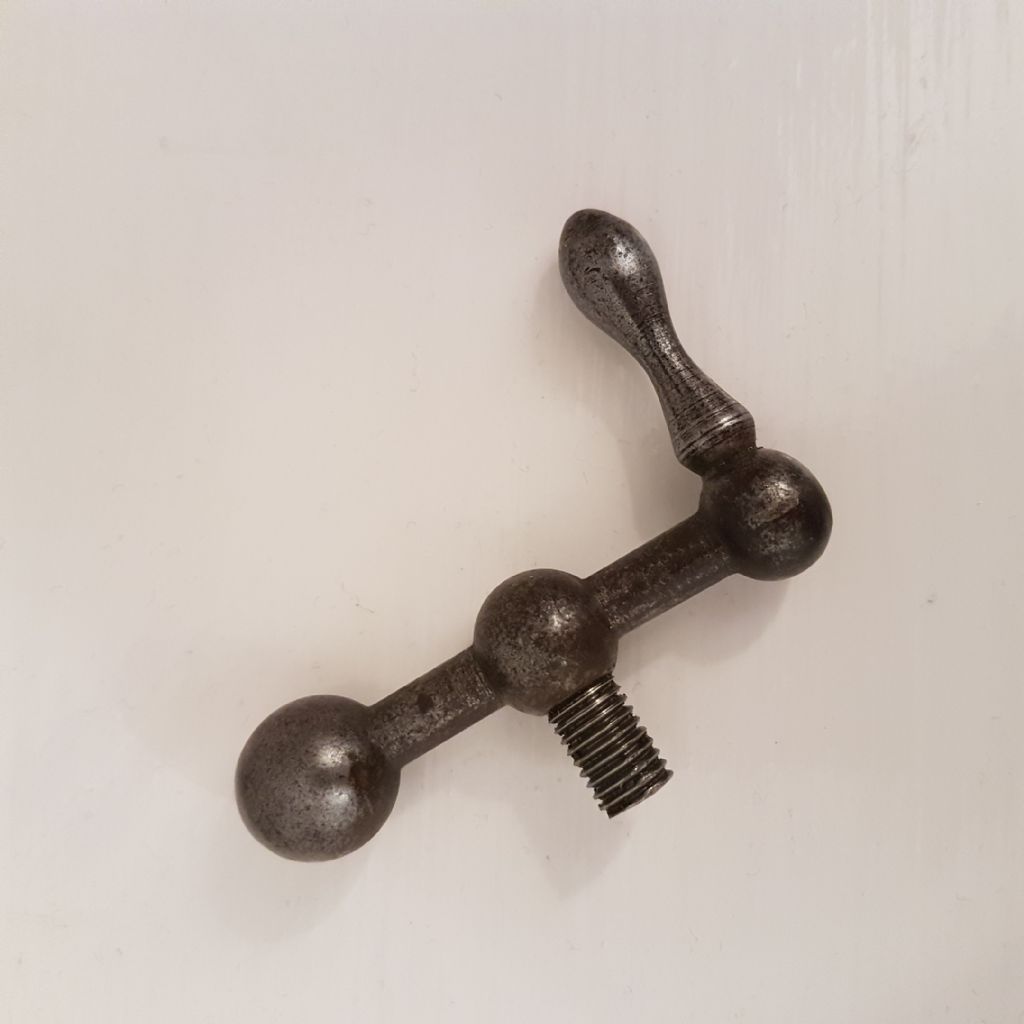

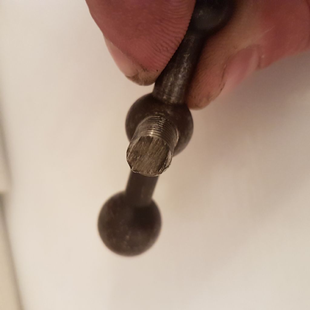

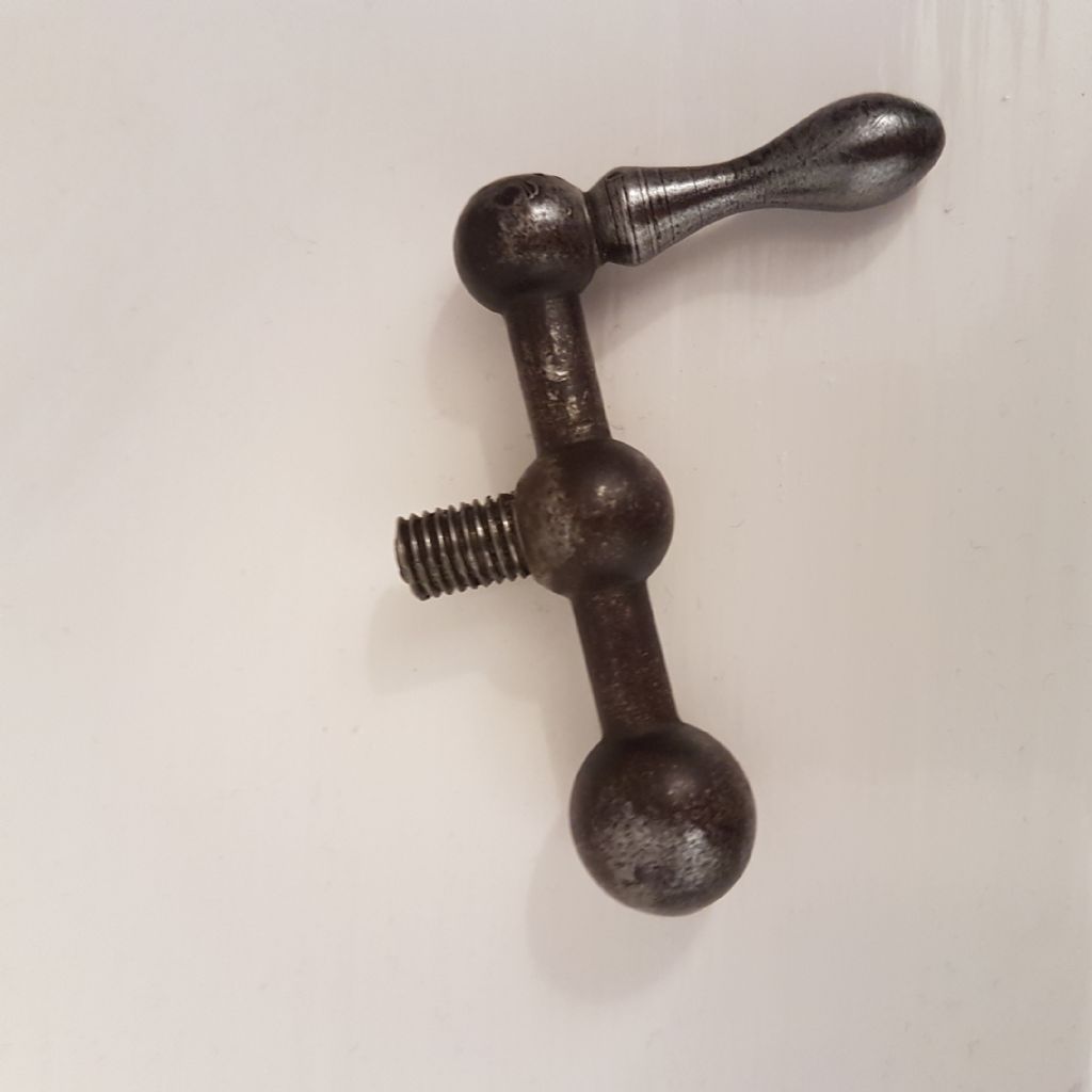

                                              Jon Cameron
                                                @joncameron26580
                                                Colin Cutts, these pics are for you, if interested make me an offer, postage on top.
