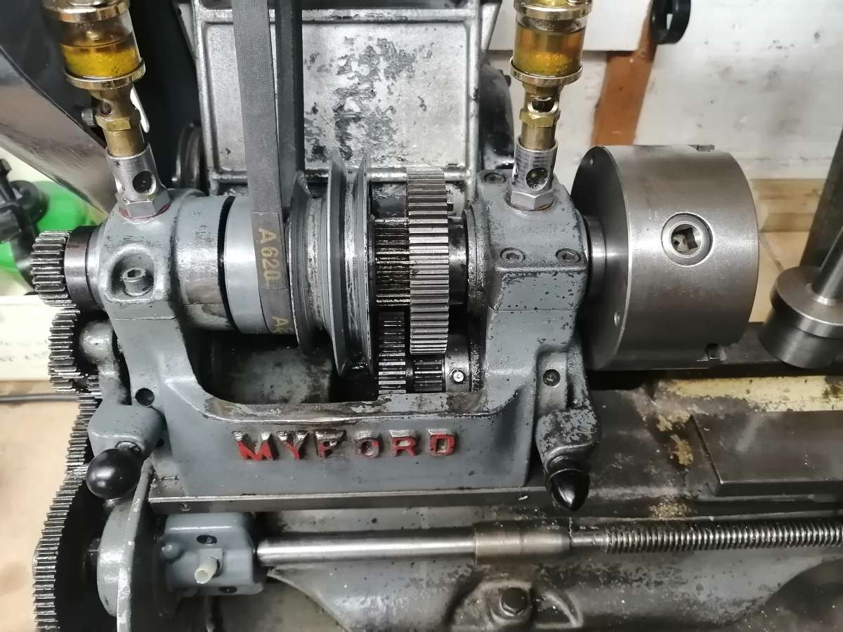

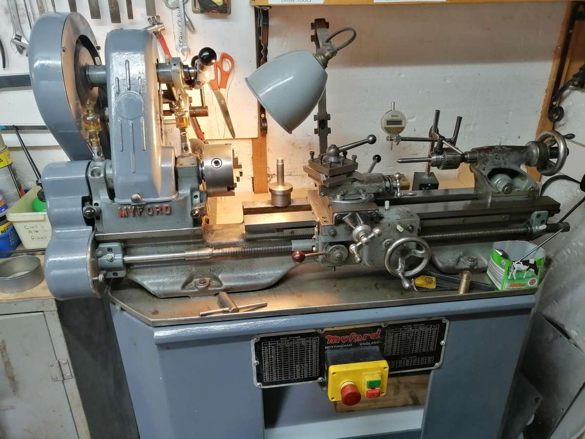

      Hello All,
      I acquired an old Myford lathe, most components appear to be ML7, but I am unsure about the exact model I have, i.e. The headstock on my lathe is not stock ML7.

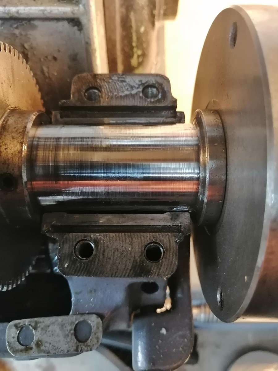

      I have looked for a serial No, but it appears it does not have one in the normal places, but it looks like the bed has been changed at some time.
      The front spindle bearing cap has 4 fixing screws, not 2 like on ML7, the bearings are the white metal type.
      I have attached some images for reference, thought it might interest some of the members
      IMG_20240604_122655IMG_20240604_110314IMG_20240605_075838IMG_20240611_104850.

        Strange, an ML7 but not as we know it, might be a very early head. My 1948 version is two bolt.
        Have you looked for a SNo. or remains of,  on the back of rear shear, right up at the tailstock end? If the bed has been reground more than once, SNo. might have been ground out! v. faint on mine after 1 regrind.

              It has helicoil inserts in the main part which is not standard. It also looks like a hole in the center may hve been filled. I wonder if it is a repair for badly stripped Threads? The top cap being machined to provide space for two bolts each side. The cast boss for the oiler looks standard. Any sign of filled holes in the cap?
              It’s a very neat job if it is.
              Robert.

                  The Bullwheel has 65 teeth, I needed to change it, teeth missing, managed to pick up the gears (ML7) from the Stafford Classic Motorbike show in April, that’s what made me curious about the model. The bearings are in good condition but the 4 front bearing cap screw holes have helicoils fitted. I cannot see any signs of a replaced hole in the center of the two screws front and back of cap.

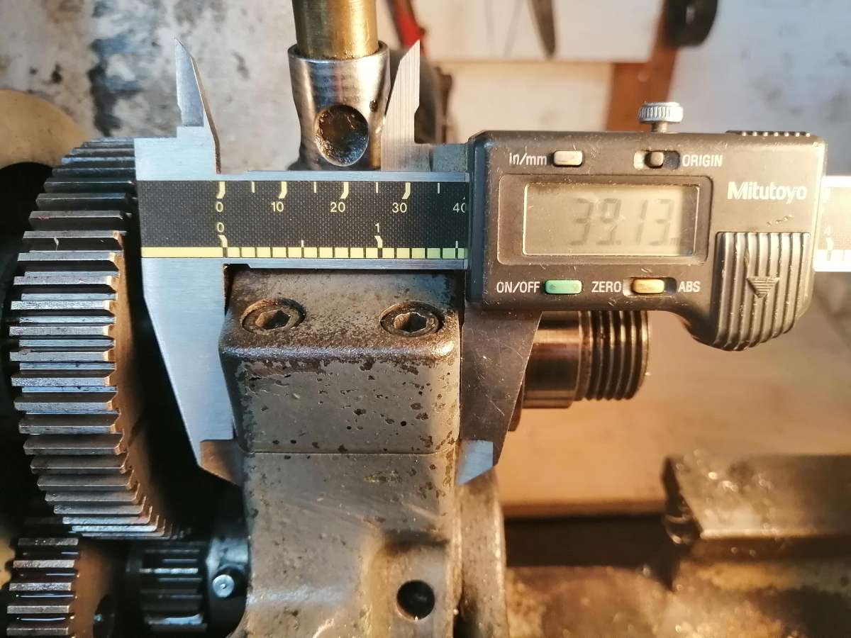

                        Definitely a different headstock casting to standard ML7, the measurement of the front bearing carrier is shown as just under 40mm. On my ’48 vintage, the measurement at the same location is 35mm.

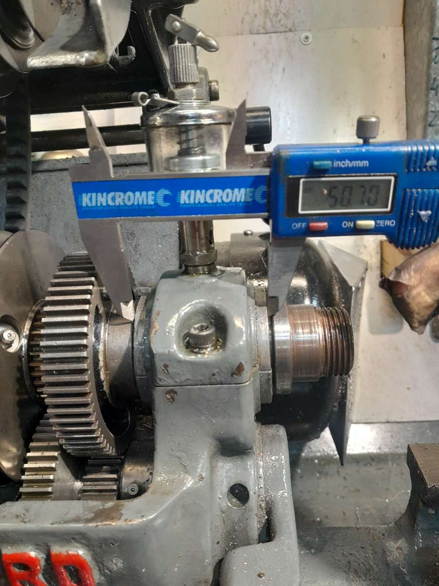

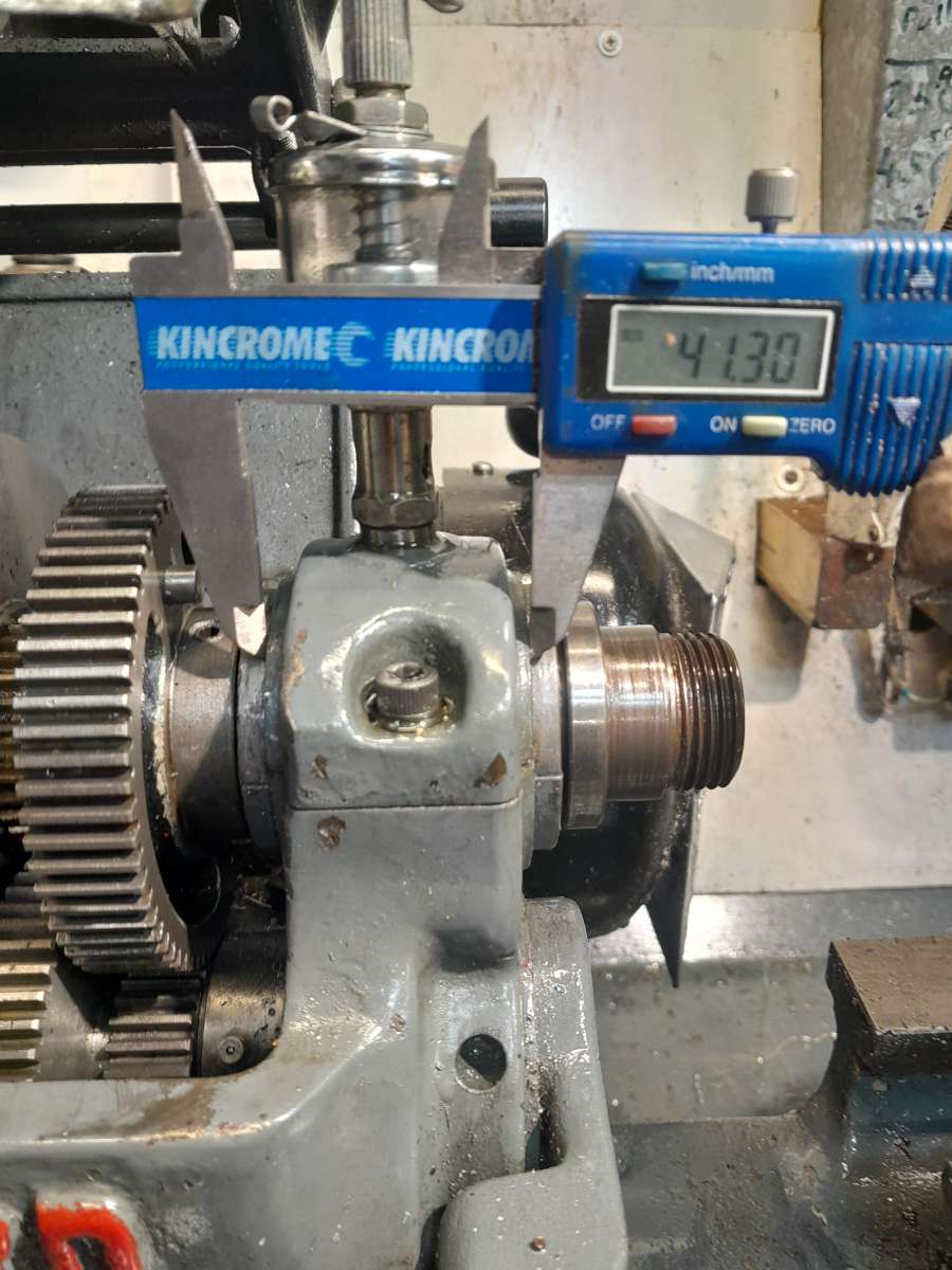

                          My curiosity got the better of me while I was fiddling in the shed this afternoon. Measured up my 1957 ML7 by comparison.
                          It measures 41.3mm (bang on 1-5/8″) across the raised bosses that stick out from the bearing cap, which puts it pretty close to what your whole cap measures.
                          20240718_173458
                          My bearing shell itself measures 50.7mm (2.00″) from end to end. Maybe you could measure yours and see if it is the same. My bet is that it is the same bearing, but your headstock casting and bearing cap extend out to the full width of the bearing, rather than being a narrower cap like mine with raised edges to meet the bearing width.

                            Yes my bearing measures 2in, cannot see any signs of filling in the base casting, suggesting it never had 2 fixing so I guess it left the factory with a 4 screw cap, but other than that it’s all standard ML7. Thanks for all the comment. Glen.
