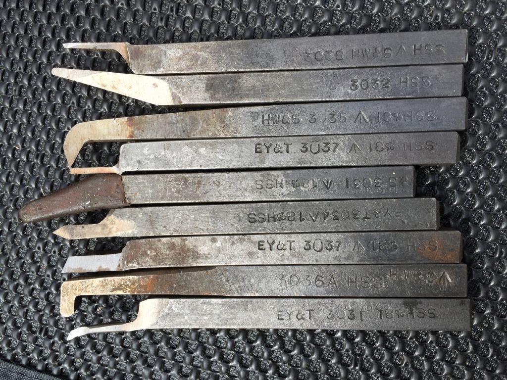

                        Robbo and Neil: Thanks guys I did grind some more top rake into it. I don't know if it came with the lathe originally, I suspect they might have been bought afterwards though it is from a Myford set of tools, photo below. I wonder if they are carbon steel as I am having to regrind that tool quite often. I suspect it may have been overheated in a previous life as I am very careful with grinding only taking light cuts and cooling in water after every pass. I do have another collection of tools which are definitely HSS (second photo) but I think you are right Neil, a ready ground set would get me started, thanks for that tip
                        and the other 'set'.
                        Any comments on this second set, which would be good for what sort of cut would be welcomed please

                        Anonymous
                          Posted by Nige on 31/07/2017 10:47:11:
                          That's a pretty bizzare set of shapes. There's internal and external threading, but most of the rest seem off the wall shapes. Probably specials.
                          You'd be better off sticking with the Myford set, or buying some new HSS blanks and starting from scratch.
                          Andrew
                          #309597
                            Cripes. Antiques…
                            I would put them aside, buy a new, affordable HSS set to learn with.
                            The Myford ones may be brazed on carbide tips, I would need to see a close up. If carbide they would be difficult to grind. Cheap ones like this are troublesome on small lathes, these may be better quality, but need a different approach to HSS to work, if they are carbide, save for later.
                            WD marked (the arrow), so ex-services.
                            Top to bottom:
                            • Fine parting
                            • LH finishing and reverse facing
                            • Internal threading (probably 55 degrees)
                            • Internal boring
                            • Light parting
                            • Fine LH finishing (looks like it's upside down)
                            • Threading
                            • Knife tool (probably intended for facing/RH corners)
                            • Getting into very small corners tool.
                            My guess is they were a collection used for making screwed fittings, probably in brass/gunmetal due to the apparent lack of top rake.

                            thaiguzzi
                              @thaiguzzi
                              Ca'nt see from the first photo exactly, but that blue set "may" be butt welded HSS, in which case, persevere with that set.
