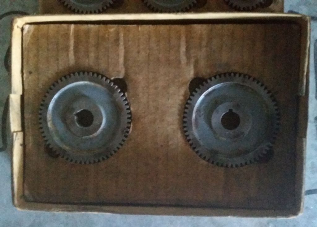

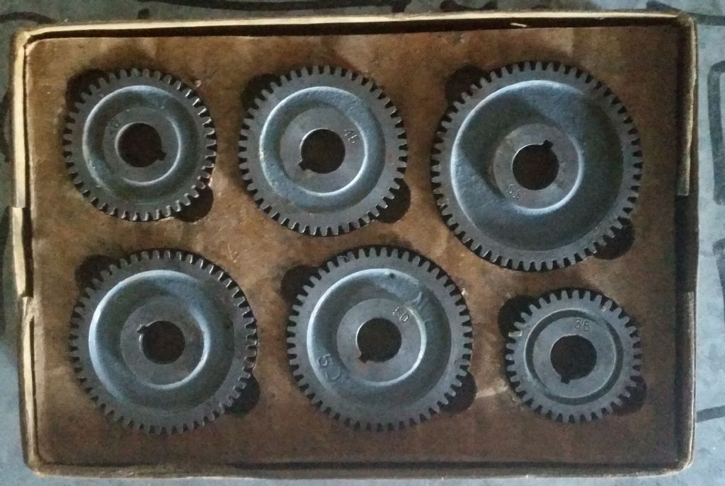

      Yesterday I wanted to cut a 1mm pitch thread with my Myford Guick Change G/Box, Metric Conversion Set.

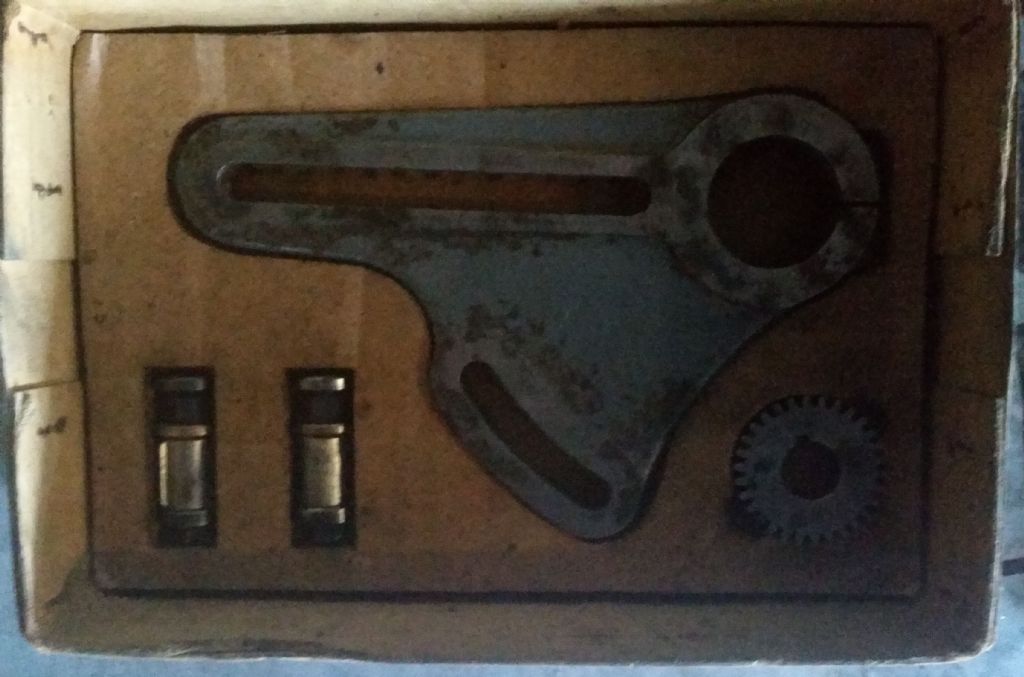

      To my horror I discovered I did not have a 63 tooth gear needed, however in the box containing all the parts every cavity had a gear in it, and when I purchased it second hand I thought it was complete.
      Also strangly enough the Myford G/Box booklet mentions "12 changewheels",
      I have twelve plus a 30T with the quadrant?
      I have shown my gears in the photos included.
      Could anyone please advise me which ones do not come with the set and what are the ones missing from the set.
      I realise from the charts in my booklet I do need extra gears to cut
      Diametral Pitches, Module Pitches and BA Pitches, which I will acquire as I need them, however I would like to make my box set complete as sold new.
      40T, 45T, 55T
      50T, 50T, 35T
      60T 60T.
      60T 65T
      45T 28T
      Quadrant 30T
      Thank you for looking.

          Brian Wood, author of the excellent book Gearing Lathes for Screwcutting posts on here regularly so can probably tell you exactly what is going on when next he checks in. But a quick look at my copy of his book shows no mention of a 63T. He lists for a 1.00mm pitch a 34T mandrel wheel with the gearbox set to 36tpi. Probably no easier to obtain than a 63T though!
          Myfords website lists teh following for metric conversion gears. Looks like your set has had a 65T substituted for the 63T.

            Thank you for the vote of confidence Hopper; I am afraid the missing 63 tooth wheel jiggers up the whole suite of metric ratios that the conversion set aims to achieve. As Hopper says, the use of 34 tooth wheels and other gearbox ratios provide another route and these are listed in my book.
            To get over your immediate problem fit the 65 tooth gear in place of the 63 on the Myford quadrant assembly picture on page 6 of their booklet on the gearbox and use a 35 tooth gear as the mandrel driver. Set the gearbox up to give 14 tpi [ settings 8 A] and you will get a pitch of 1.032 mm. It isn't perfect of course by a fairly large error but if you have a die to run down it at the closing stages it may serve for your purposes.

                have you counted the teeth on the 65 gear ? maybe it is a 63 with badly punched number – assuming the box is original then would seem to be the correct one in a made to measure holder?

                  My first thought, I checked that from the photo Frances, it is 65 T, It would seem to have been badly packed at the factory. Myford used a 65 casting blank to cut the 63 T gears into it and whoever packed the kit got it wrong.

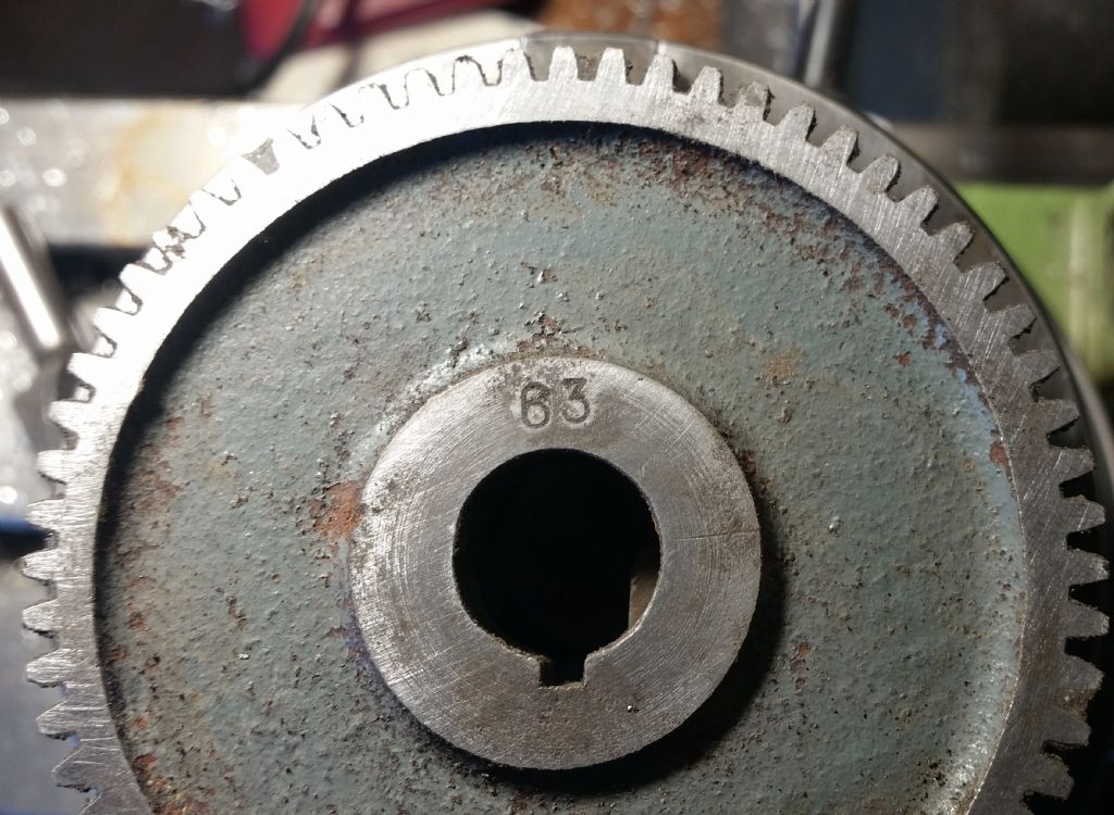

                    Just ran out and counted the number of teeth, counted 63.
                    You are right Brian, it is cut from a blank with 65 cast into the relief. It has 63 stamped on the reverse, I didn't take it out of the box as I was in thread cutting mode…
                    I will have to clean them up, the set was never used and have some corrosion on the faces.

                      All's well that ends well then, the patches of corrosion and poor focus made it less easy to follow a tooth count on an expanded view. I thought I had it right.

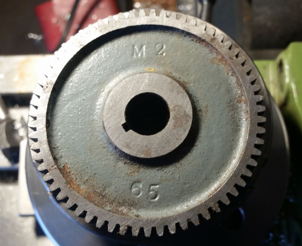

                            Here is a pic of the 65 casting used to cut the 63 tooth gear.
                            A trick I am now aware of.
                            This is the 65 casting used to cut the 63 tooth gear.
                            This is the other side of the gear which was face down in the box.
                            Next time I will count the number of teeth.

                                Some while ago we had another puzzle of this kind, caused in that case by a wheel that had been stamped 54 but was in fact 45 teeth, or was it the other way round, I don't remember the details now.
                                It caused all kinds of confusion until pictures were posted.

                                  Noel,
                                  Thank you for sharing that perfect example of 'Make From' … and the risks associated with it.
                                  By failing to prescribe a suitable '2nd Operation' to obliterate the cast-in number [or by ignoring such an instruction], great confusion was caused.
