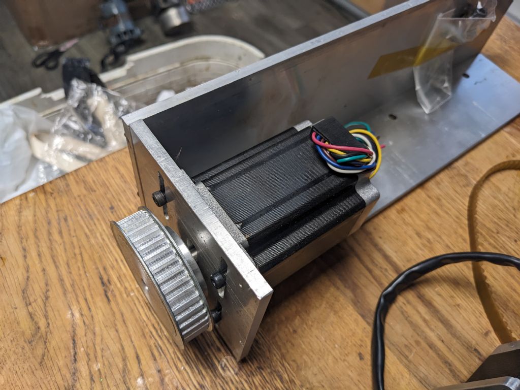

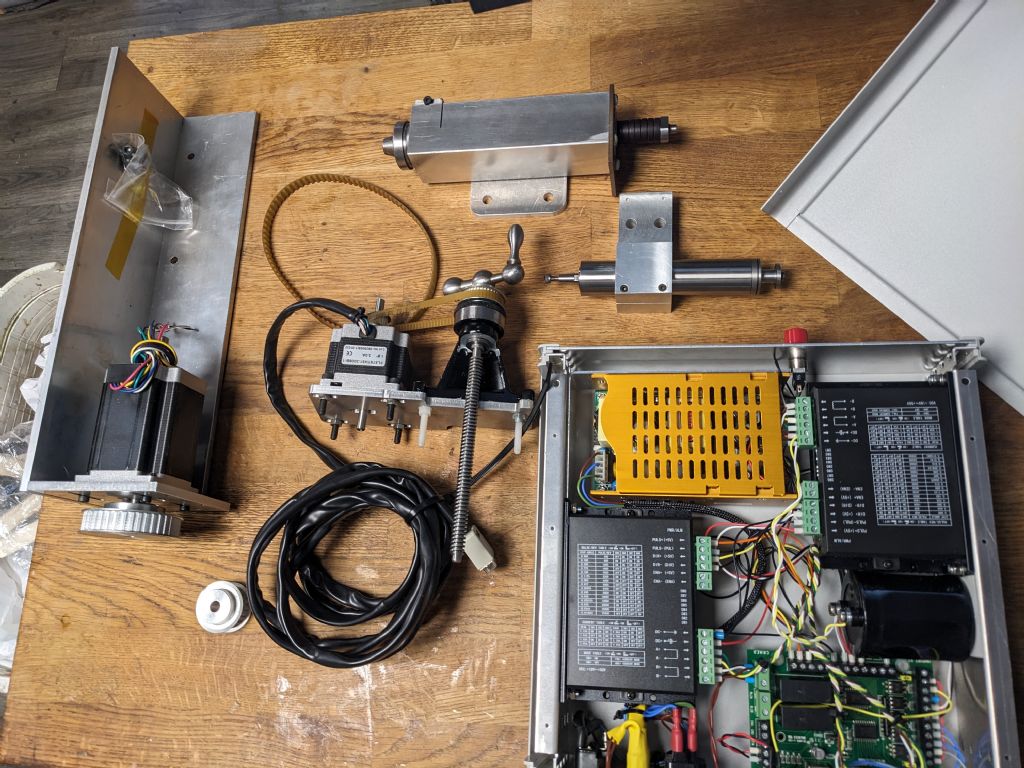

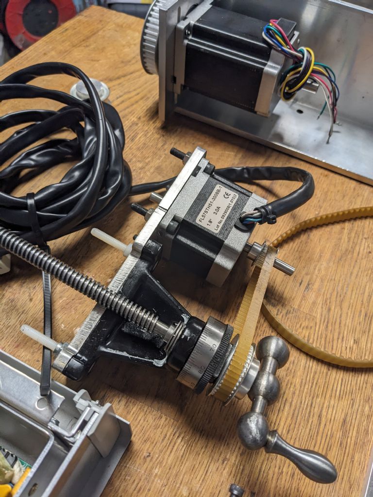

      I've recently acquired a Myford ML7/Super 7 CNC conversion kit from Tony Jeffree's design. From what I can tell, it's partially completed and only needs the actual leadscrew modifications ('part 1&#39 and Mach3 setup, of which the pulleys and belts are there. The cross slide pulley, leadscrew motor box, and controller are complete.
      The CNC control box is from DIYCNC.co.uk and within is their Uniport V2 controller. I couldn't tell you much else about the full controller setup. There are two other parts contained, top right in the pictures, which are internal grinding spindles placed into a housing with bolt fixing locations on the Myford cross slide. My guess is that the original user was going to convert it into a 2 axis milling setup, well capable with this Uniport controller.
      I was wondering if there's still demand for this sort of thing to be sold on as currently I've not got any interest in converting my ML7.

          Mach 3 is still about as far as I am aware, the steppers look like nema 23s 3amp jobs which are ok
          a couple of controllers a power pack and a board all wired up and ready to go
          Bound to be a few who would fight over it on ebay, especially since the build files are still available
