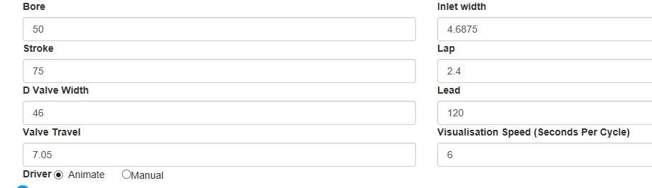

            I had a play with your simulator, I quite liked messing with that.
            The settings I got were,
            Bore = 50, Stroke = 75, D valve = 18, valve travel =4, inlet width =4, lap = 0, lead =90.
            I'l see what Jason comes back with as he has much more experience in design than I do. Though the settings above made for little lag in the cylinder, meaning the cylinder had steam admitted or exhaust, but no overlap of the two.

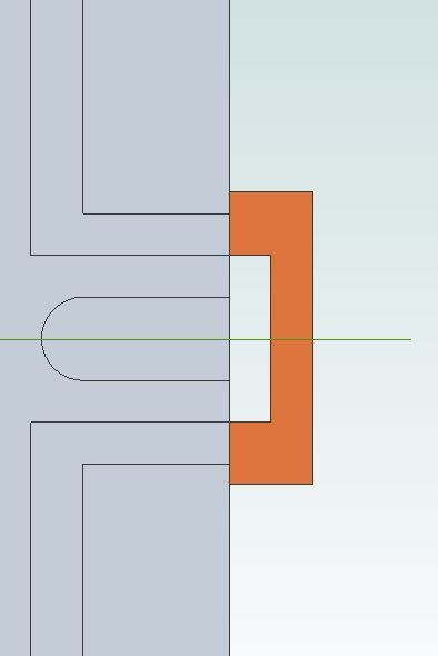

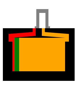

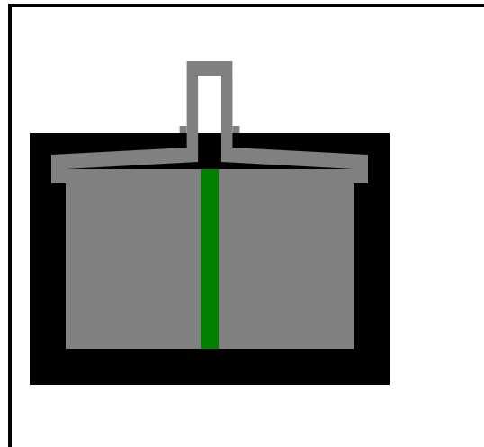

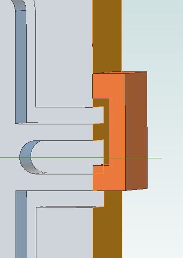

              Something does not look right on the simulator. This was with the valve width set at 12.7mm and the inlets at 3.125. yet the valve only looks to be half the width of the inlet
              Should look like this mid point
              full ecc throw
              Try these details
              Valve recess 12.7mm
              Eccentric throw 4.7mm which you call travel though travel is twice throw although simulator allows for this
              Inlet 3.125mm
              Lap 1.6mm
              Angle 120deg
              Inlet is fully open at full ecc throw
              This is from the 2" Fowler A7 1.375 bore x 51.00 stroke and capable of pulling two people around all day. so a design that works. Just multiply by 1.5 to get some figures for your engine.

                After spending the morning mucking around with my code (that or an unheated shed….), I've come to the conclusion that the code is fine, but the documentation is poor!
                The Valve width is the width between the insides of the D valve. The no lapped D (so the outside of the valve width) is the same as the width of the inlet and then I add Lap..
                I've plugged your numbers (at least I think I have), except that m DValve is wider, which i don't think will affect this.
                What I'm seeing is that the cut-off is about 80% whereas my reading would expect about 25%.
                Making these changes produces something a little more like my reading expects, but does not open the valves much
                travel => 2.5
                inlet => 4
                Lap =>2
                Lead => 140
                So I could better see what's happening there is now a manual mode where you can set the crank angle. You may need to Ctrl F5 to refresh the browser to see the new version.
                Iain

                  Ok I've entered my figures and get full opening of the inlet which you would expect as opening plus lap = eccentric throw ( 4.7 + 2.4 = 7.1)
                  The 4 values you list will give very little opening as your eccentric throw is so small so you only open 0.5mm once the lap has been subtracted from the travel. I'd expect that sort of eccentric throw on a 3/4" to 1" bore engine
                  Your lead of 140 deg seems very large too, for the display engines I usually set the lead to be 100-110deg and the Fowler that does work is 120deg

                        I would not enlarge the inlets, more a case of increasing the small eccentric throw to open more of the inlet, not much point in having your 4mm inlet any lorger if you are only going to uncover 0.5mm of it.
                        I know earlier you said you did not want to do reversing gear but it does have the advantage of making it very easy to alter the valve travel. The figures I gave for the Fowler would be a full notch and would be used when the engine is having to work hard eg going up a steep hill with a waggon full behind but if the engihe were not towing a load and just running along on flat ground the driver would notch it back maybe to 1/3 the movement to save on steam. You can do the same with your engine, allow it to fully open the ports when needed but then notch it back when under less load or when just running for display.
                        The Fowler figures are for a traction engine and as I said that will happily pull two adults about so doing real work not just a display case model. The Fowlers ports are quite wide 1" x 1/8" inlet, 1/4" exhaust and scaled from full size though as they have drilled passages they won't flow as much steam as the full size could and therefore you get more losses
