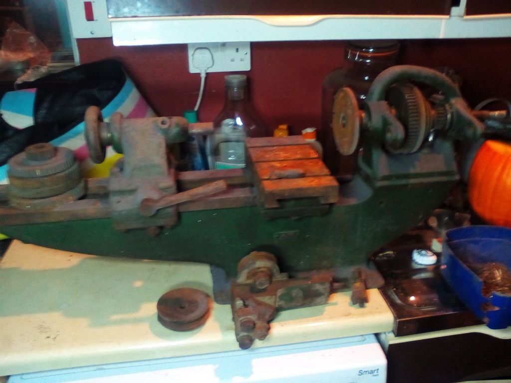

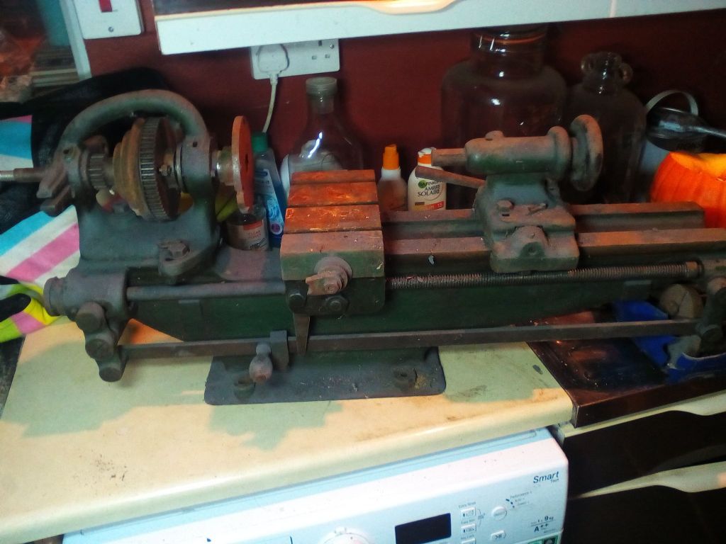

      Hey all
      Finally managed to pick up most of a lathe today after a few months of looking for something cheap, managed to get this for the solid price of free. I was aware it was not complete when i went to get it but its better than i expected, very dirty but looks to be ok under the muck and very substantial for the size, i really struggled to carry it down the hallway.
      I don't know metal lathes, yet, i'm not sure what it should have to be complete so no idea what might be necessary but missing? i can see I need to replace the faceplate, replace a bit of metal that holds one of the crank handles, get a motor and give it a serious clean up but can anyone see anything else ?

        #505906
        Martin Kyte
          @martinkyte99762
          I would say that is Drummond B type 1912-1921
          details here
          **LINK**
          best of luck.
          regards Martin

                Well it's a Drummond B-type so plenty of information in the Drummond Yahoo at groups.io and on Lathes.co.uk.

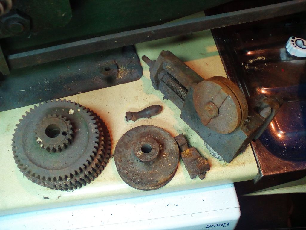

                Looks like you need a counter shaft for the motor drive, a layshaft and gears for the back-gear, and later a banjo to hold those changewheels. The 'faceplate' may be a catch plate for between centres turning or a chuck backplate (the fact that it fits the nose thread puts you one up) 1/2 hp motor will be enough as it was originally treadle powered.
                Don't rush to buy bits until you understand what you actually need rather than trying to make it 'complete'. Lathes were sold with fewer bits than you have right up to the eighties.

                  Hello Liam. Your lathe looks to be this one; http://www.lathes.co.uk/drummond/page5.html
                  At a quick glance you seem to have most of it so you are off to a good start.

                    Thank you for all the quick replies, will definitely come back to keep progress updates and probably ask for advice. In regards to the backgear gears i was hoping it was the gears that came with it, it looks less in the photo of the accessories but they are 5 in total, looks like the same 5 in the pictures on lathes.co.uk. I should have a motor laying around, if not i might just run a belt straight from the wood lathe for the time being; maybe even make what i need and can from wood to get it running and replace them with better bits as i go, i mostly work with wood, or an anvil, so i just want to get this in running condition far more than a factory restoration.

                      Just give her a good clean and check out the bearings/leadscrew nuts
                      A good project to get for free, don't mess with the headstock bearings until you have some detailed knowledge, some of them have little fiddly bits lurking in hard to see places, shims/loose bearings etc
                      GL

                          The gears you have are not the back gears. Those two holes you see at the top of the bearings – they need oil, lots of it, and a bung to stop your sawdust getting in there. You can make adequate pulleys out of ply and use plummer blocks for the layshaft. Instead of backgear you can slow it down with a large wooden pulley like 18in dia, just carve out some spokes ot lighten it.
                          When cleaning off the rust don't use anything coarser than 00 wirewool on the smooth machined surfaces, think of it as a Chippendale chest.

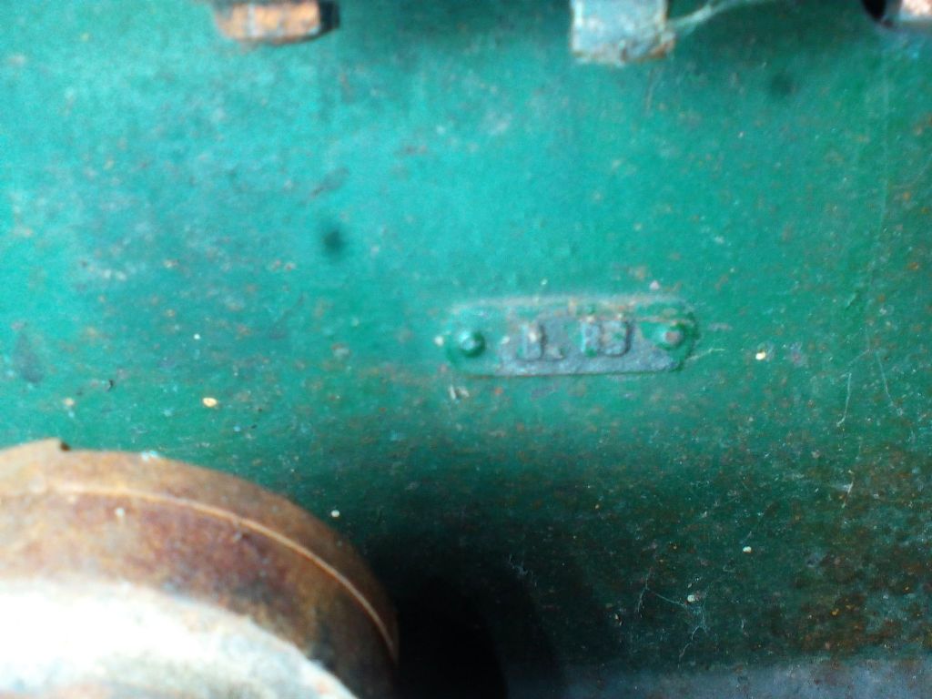

                            Having had a read over lathes.co.uk, a picture i initially took but ignored made more sense and it looks to be the b-type BS model made for naval use. not sure how clear the picture will be from my phone but ill get a better one when clean123939170_827154544504041_3473735247318029280_n.jpg
