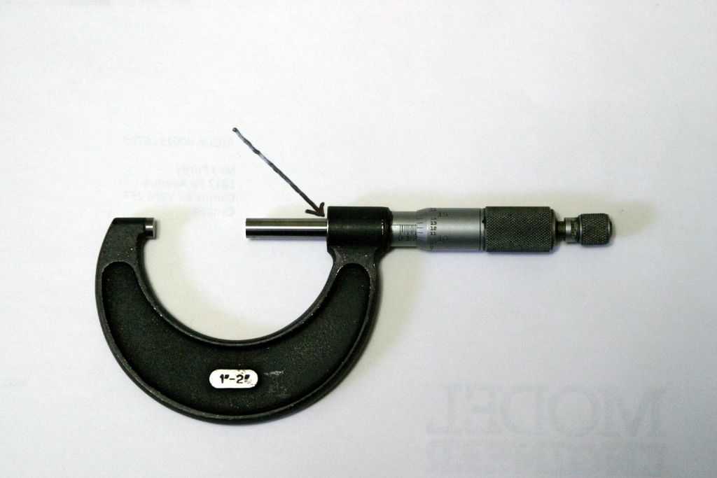

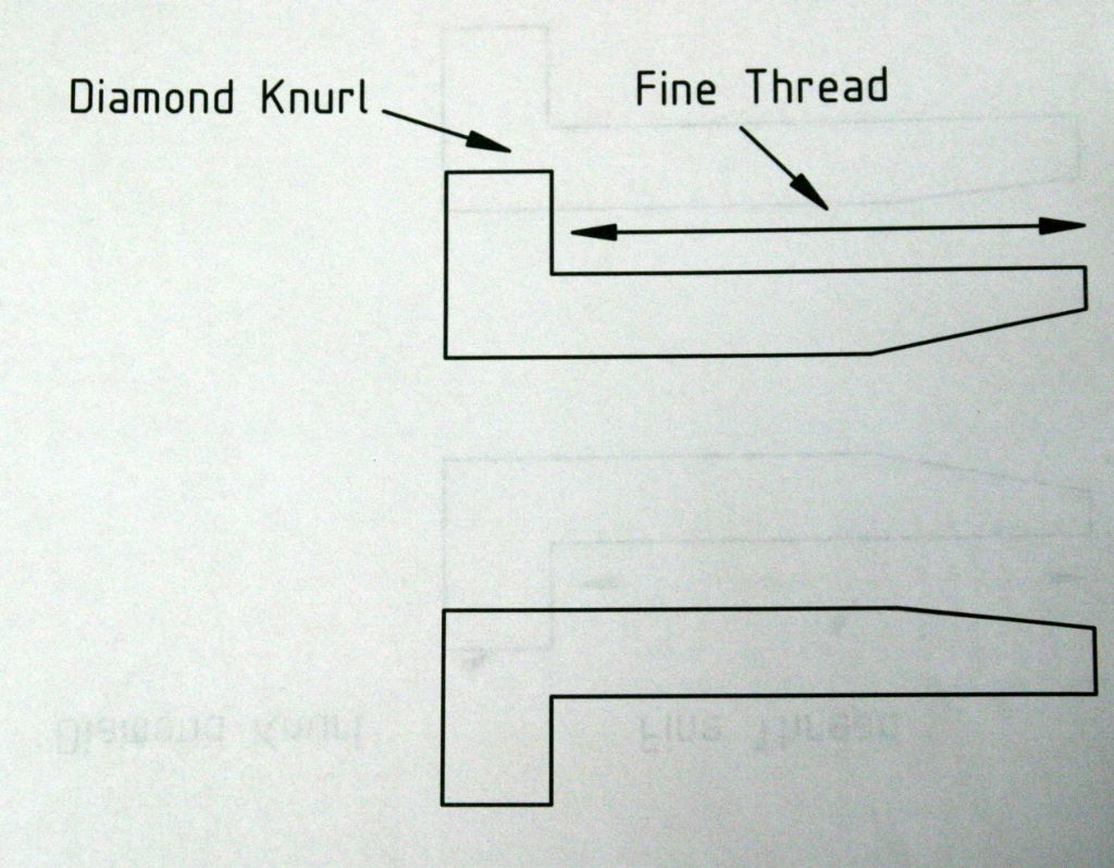

        I seem to have lost the locking sleeve on my Moore & Wright # 966/2 1-2" mike. It goes where the arrow is in the picture. If someone with one could measure up theirs so I could make a replacement I would be most appreciative. I need the OD and pitch of the threaded part and the dimensions of the bore. I suspect the bore might be tapered to compress the split sleeve around the spindle thus locking it. Below is a pic of the mike and a cross sectional drawing of what I think the locking sleeve looks like. I suspect the thread will be 55 deg.
        Thanks.
        If everything goes as normal, as soon as I make a new one the original will show up in plain sight!

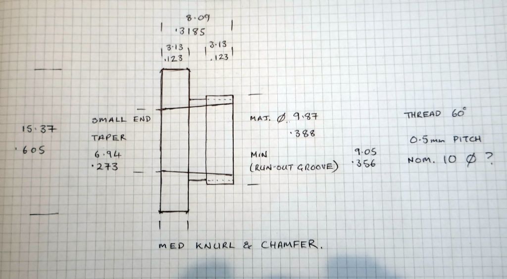

                  ..seems to be based on an 'Imperial'-sized part, but thread looks (under magnification) to be of 60* form and 0.5mm pitch with say 75% certainty – is the 9.87mm major D. intended to be a nominal 10mm?
                  The gauge was unbranded, but German-made.
                  Could it be 48tpi? ..possible, but I don't have the gauge to measure it..
                  I couldn't measure the large end of the internal taper with any certainty – the small end is given.
                  A spring steel 'wavy washer' is pressed over the thread and trapped in the groove behind, resisting all attempts to remove it.
                  I've described the knurl as 'Medium' – it looks somewhat coarse on the (small) component – for ease of grip, I guess.

                                The thread on the collar is noticeably, and with no doubt, finer than 40tpi and coarser than 60tpi.. ..there are no pitches between these in the only sets of Imperial gauges that I possess.
                                The thread we were discussing is the locking collar, not that of the thimble, apologies for any confusion

                                      I just received the locking ring from Paul. For anyone needing to make one I have measured it under high magnification (20X )and the thread is 55 deg., 50TPI, .388" OD. The bore tapers from .273 on the outside to .325 on the inside and the rest of the dimensions are as Paul has shown in his post I measured the angle by comparing it with my small 60 and 55 deg. threading tools which were ground on the Quorn so should be reasonably accurate.
