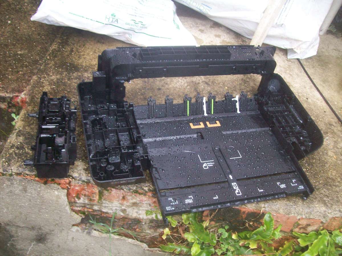

      So on Friday I paid the £50 for a “service”, and brought the dead machine home to dismantle for scrap and salvage.
      It yielded very little of any potential model-engineering use: a couple of steel rods, assorted moulded-plastic gears I’ll probably never use, and a collection of small screws. The rest is some electronic scrap, a few pressed sheet-steel bits with insufficient flat area of use, and two fertiliser-bags full of plastic mouldings.
      The latter made me pause for thought. The photo below (sorry about the ratty photography!) shows the largest and most complicated single plastic moulding, the base; but does not really show just how complicated it is. It is one-piece, some two feet wide by sixteen inches by six high and full of all sorts of features.
      Next to it is the bulk of the complicated print-head home-location and leaning mechanism, also nearly all plastic.
      These machines are made in China (MAGA?) but probably designed “at home” by the American company. Parts-making and assembling is all mass-production though, by semi-skilled labour probably on modest pay even for their country.
      These plastic parts are extremely involved items, with innumerable rigidity-webs, hollow columns, compound curves, clips for their mating mouldings etc; and all to very high accuracy and precision so the mechanical parts screwed directly with no adjustment to the plastic will work as intended, and the case assembles to similar quality, to produce very high-quality copies and prints to pixel-level dimensions and ink control.
      This positioning problem is compounded by the way the case is assembled: the mouldings are all clipped together by hidden tags that I’m afraid largely yielded to brute force and “higorance”.
      The other surfaces have to be of glossy finish, meaning very highly-polished mould surfaces. The webs and columns are very thin, perhaps 1mm, so have very low draught-angles. The various registers have to be just-so.
      Designing these machines must require a group of people representing many, very advanced skills indeed, to design the “works” as such and to draw it all together by CAD at levels I could only ever dream of.  Then across the Pacific, very skilled CNC machining-centre setting to make the moulds, press-dies etc. from the files. Considerable care too at assembly-line level even if the workers need not be especially skilled.
      And yes, it no longer worked but there were I, destroying it, yielding a few bits of electrickery for the WEEE skip, a load of thermoplastic our Council services likely can’t “recycle”, and two bits of steel rod for me.
      I actually felt guilty, not so much for breaking up an irrepairable, mass-produced piece of “consumer goods” (‘orrible word) but for what its design and manufacture had involved……

            That’s an astonishing piece of moulding, Nigel
            … it’s a fading memory now, but I still recall what a performance it was to even measure the critical dimensions on the little KODAK 110 cameras, never mind the difficulty of making them to spec. !

                  It certainly is – planning the moulding must be as much part of the design as the shape of the thing itself.
                  I have the utmost admiration and respect for the technical abilities of the designers of modern industrial products like these, despite unfriendly commercial pressure on them to produce “planned obsolescence” and non-repairable goods.

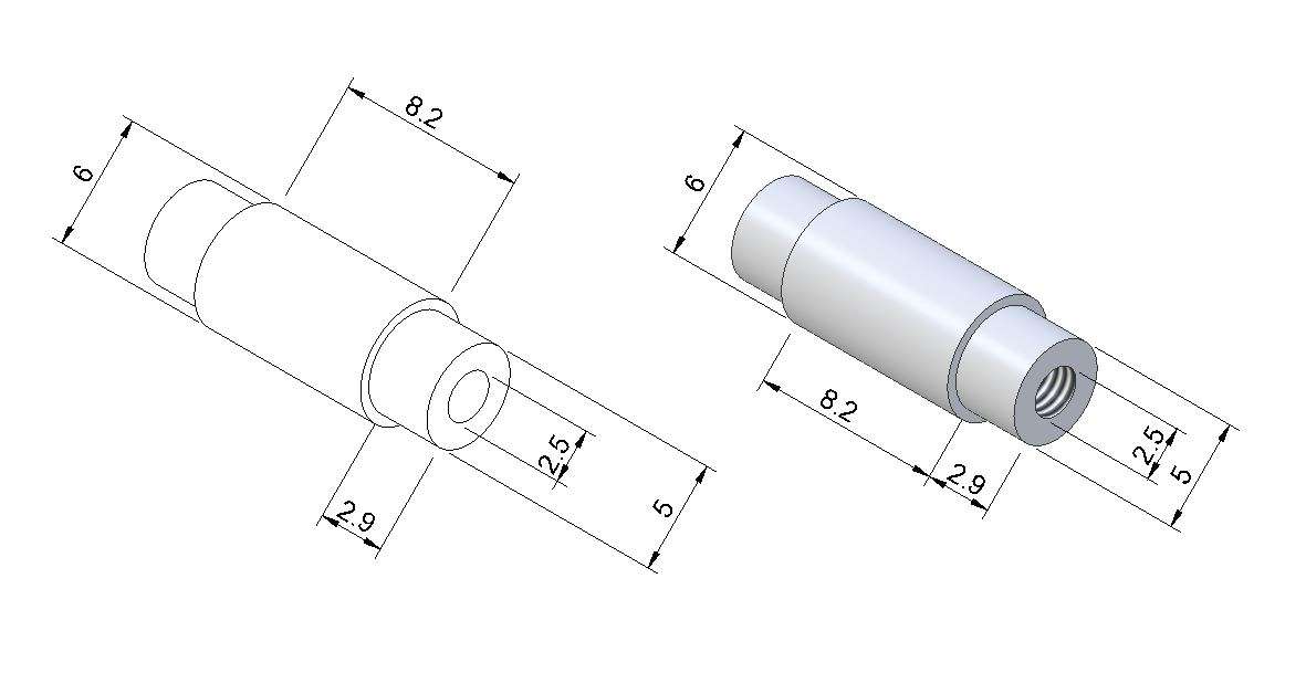

                                One thing that 3D CAD programs don’t seem to do is allow you to display selected dimensions on the model like you can in the drawings. This would further reduce the ‘need’ for complex 2D representations of 3D objects, with all their inherent compromises.
                                        Alibre Does

                                          That is exactly what I would like to do with Fusion

                                                  Regrettably, this is something that Fusion 360 cannot do. Dimensioning the standard top/side/front etc views is fine, but although it will allow you to add dimensions to an isometric view, they are not correctly scaled to allow for the rotation. Still, just having the isometric view on the sheet often helps understand the 2D dimensioned views. Not quite as good as dimensioning the isometric view, though…
