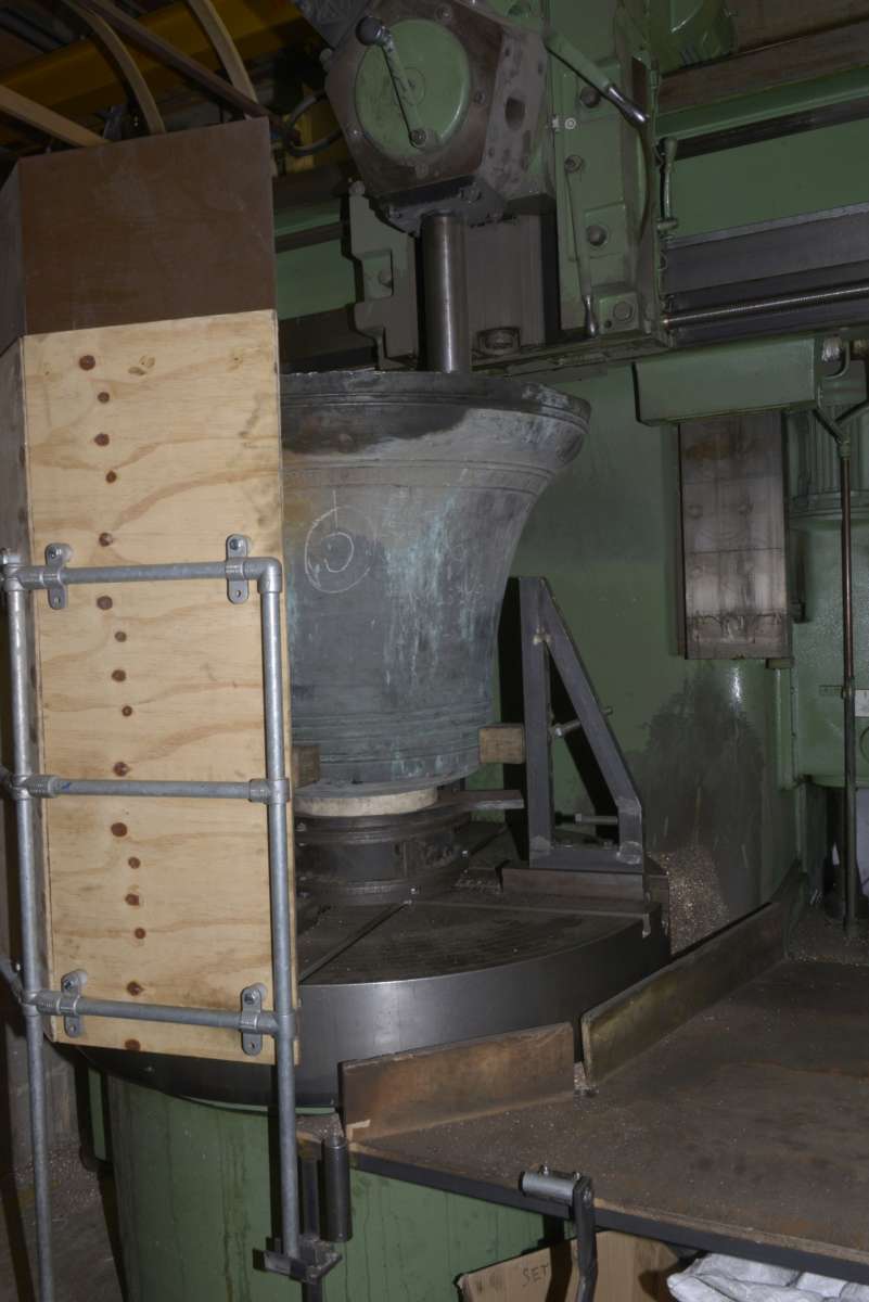

      Hi all, can anybody help? I have a book describing how to make a musical clock movement. It all looks within my sphere of ability except the many bells required. I don’t seem to be able to find anywhere to purchase these or any information regarding manufacture and tuning of bells for the amateur horologist. Does anybody have any information or can you point me in the right direction. It’s a shame but if I can’t solve the problem there is no point in even starting.
      Andy.
      #698510
      Peter Cook 6
        @petercook6
        Look for hand bells – or hand bell manufacturers. Depending on the quality and number you want a cheap set of children’s bells will be about £40 from Ebay. On up the sky’s the limit.
        https://www.bellsofwhitechapel.london/clock-bells/ will make tuned sets of clock bells to order according to their website.
        Cousins the clock parts suppliers do bells in various sizes, but I don’t know about the tuning. Real bell tuning is an art, but you may need a big machine depending on the size of the bell.
        Tuning Machine & Tenor Small
        You could also peruse Ebay or your local auction house for an old musical clock and  scavenge the bells off that.
