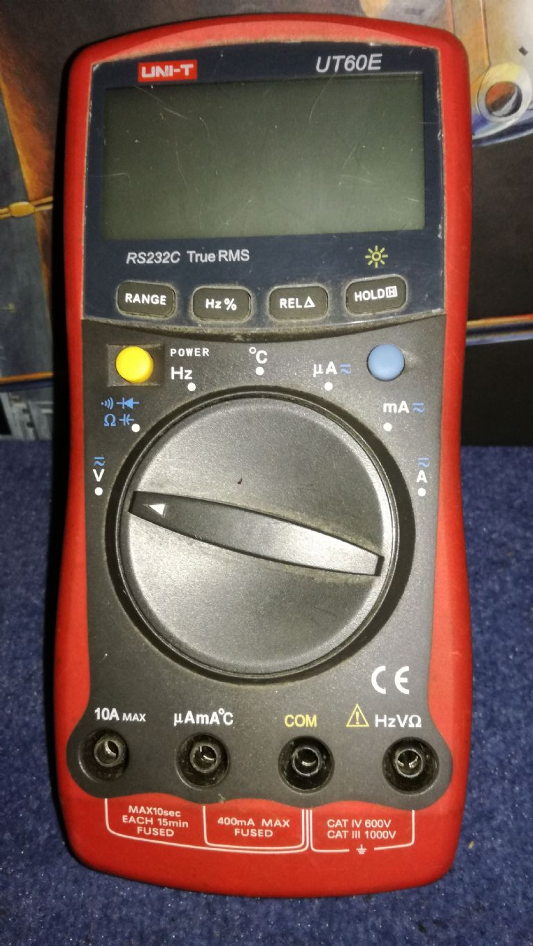

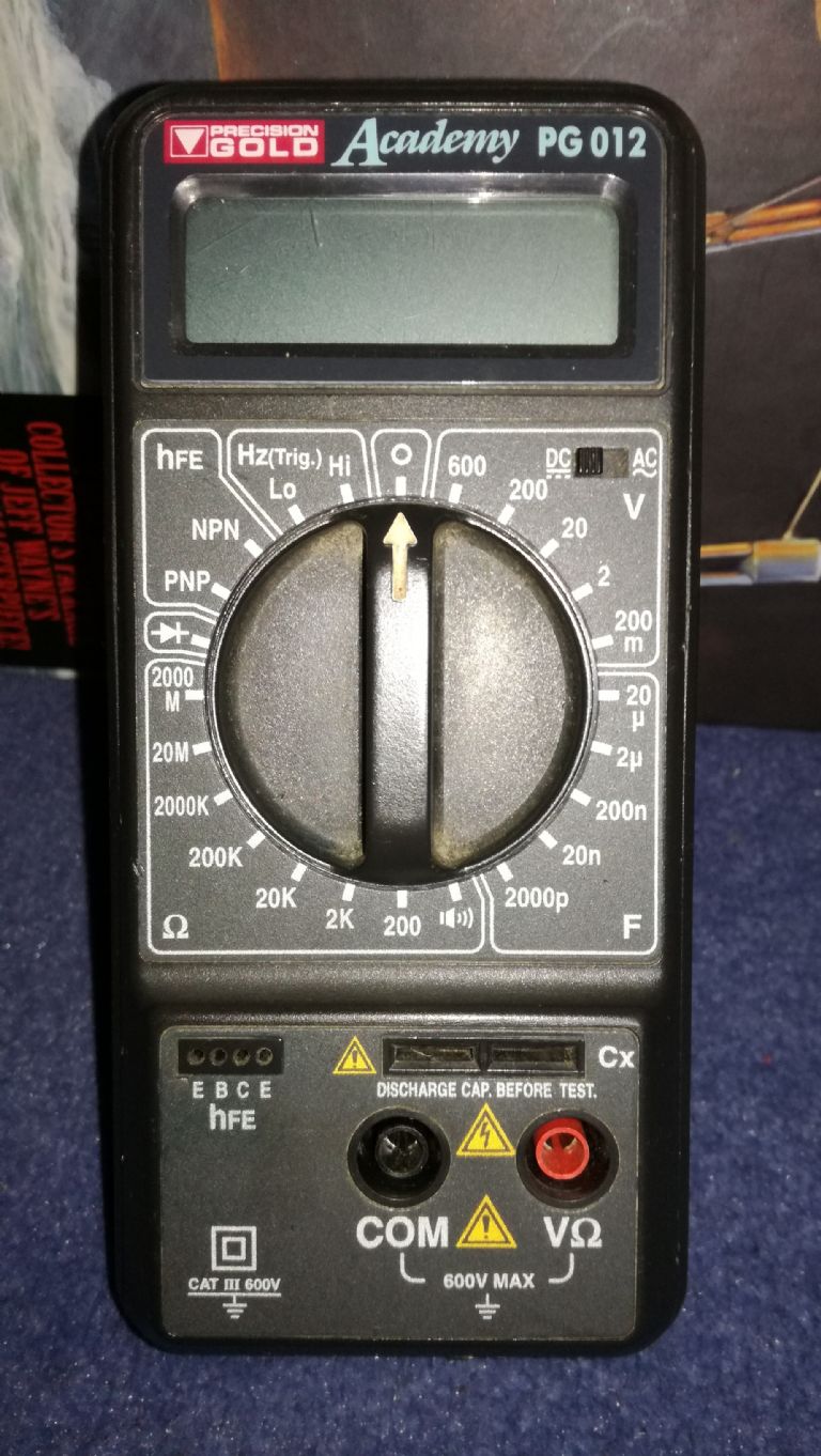

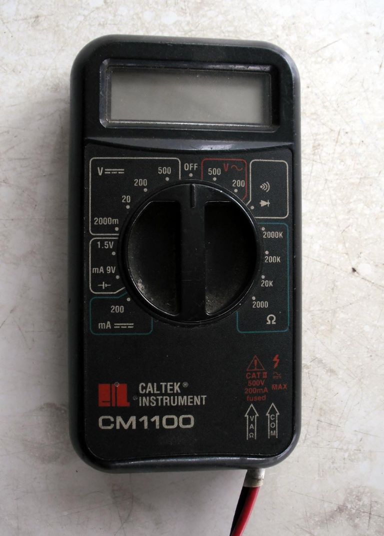

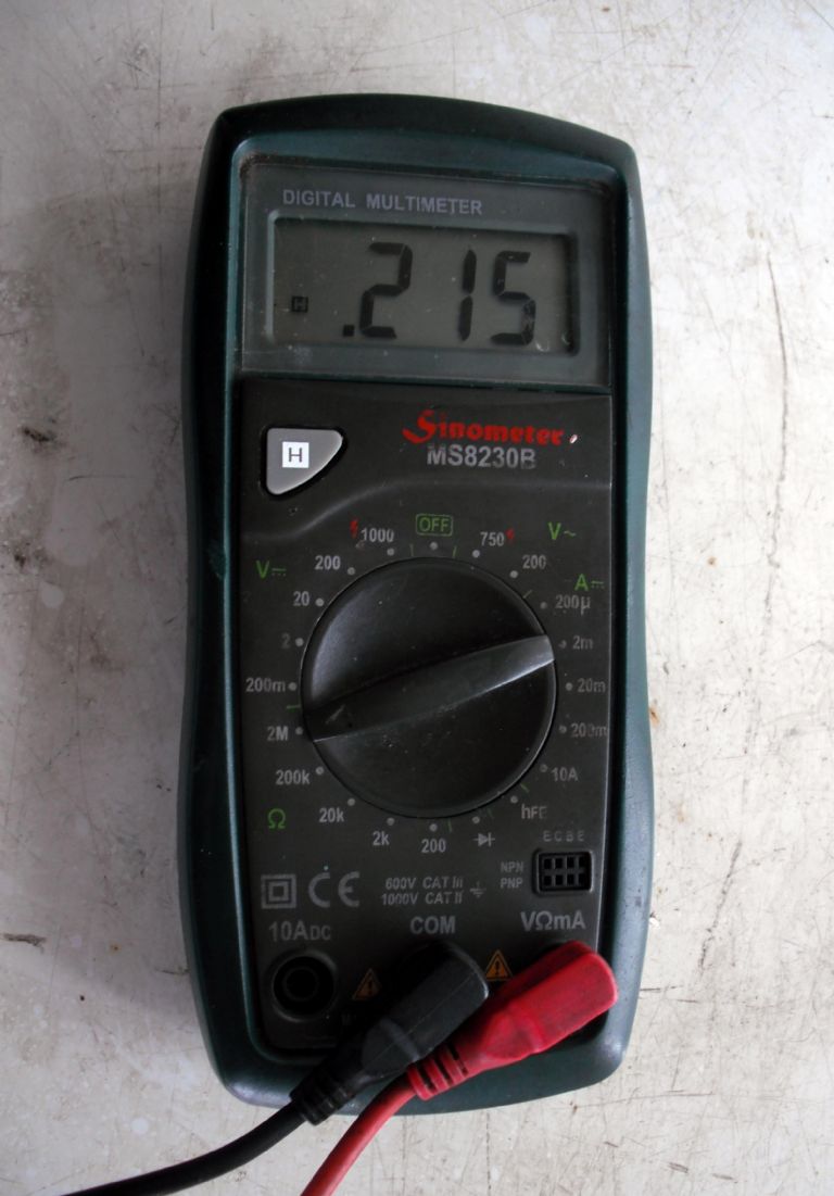

Hi, well here's my line up of digital multimeters, first one is Maplin's precision gold range and must be nearly 20 years or more old. It is cat III 600V and has measured the mains umpteen times without any issue, but there is no current measurements to worry about. I have compared it to a good known professional multimeter at one time and the results were not different enough to be concerned about. It can be seen that it has transistor and capacitor testing, I can't remember exactly how much it cost, but think it was in the £25 range at the time and this was my first digital multimeter I had, previous ones were analogue, which I do still have but rarely use them now.
This next one is a UNI-T which I bought from Maplin's for around £35-£40, a fair while before they closed their stores. It is auto-ranging, but the ranges can be set manually, it is cat IV 600V and cat III 1000V and does have DC and AC current in all ranges but no transistor testing, it has also been used to measure the mains. All the readings compare very well with the above one with no drift worth any mention.

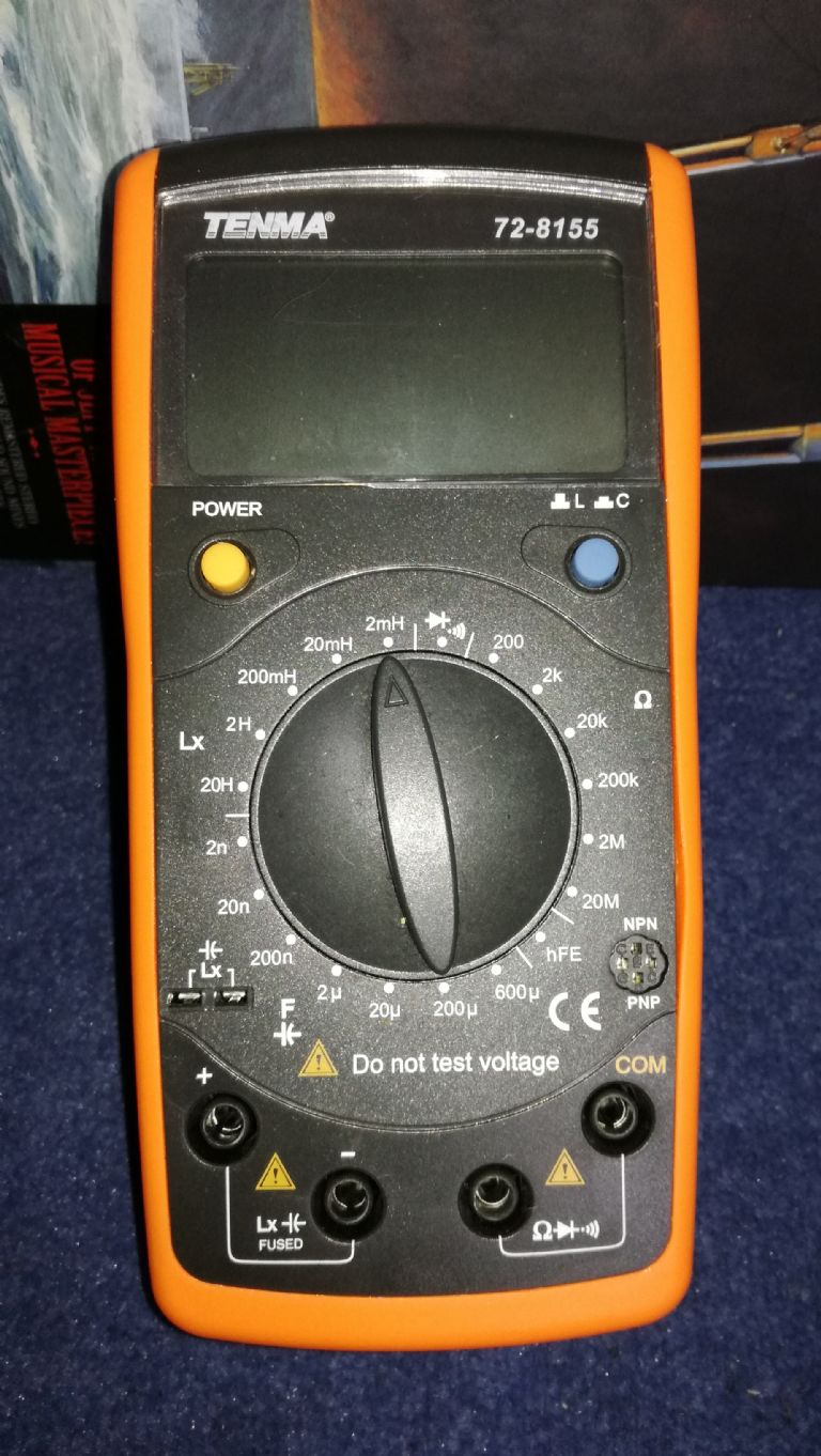

This next one I received yesterday, I really only bought it to save me paying postage costs on another two items, but I chose it really for the battery test function although it seems to be a good general overall use one. This is also cat III 600V and cost £11.94 from CPC/Farnell. Haven't use it yet, so don't know how it compares with any of the two above.
This last one is completely different as it doesn't measure volts or amps but it does have Inductance measuring, resistance, capacitance and transistor testing. I think I bought it about 18 months or so ago and it cost in about the £35 range, again from CPC and it was the inductance range that I wanted. I've measured a few commercially made chokes that have been marked with tolerances on and has been in the same ball-park close enough not to make any effect for what I would use it for. Just have to remember not to put it across any voltage, but it only has leads that are 170mm long including the crocodile clips, so I shouldn't really confuse it with any other meter.
Regards Nick.

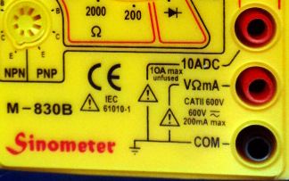

There is no way that the meter pictured is CAT II 600V compliant. This is a FACT. I can 100% from just one obvious feature – the 20mm glass fuse. No 20mm plain glaas fuse is capable of safely breaking the fault current on even a domestic electrical supply. Compare with the sand filled thick wall ceramic fuse in a 13A plug.
To satisfy yourself pull the fuse and see if it is rated for 600V AC. I bet it is not. For example Farnell do not list a single 600V 20mm fuse
https://uk.farnell.com/c/circuit-protection/fuses-fuse-accessories/fuses/cartridge-fuses?st=20mm%20fuse
The clearance and creapage on the input connector sockets and fuse also appears inadequate but I'd have t measure it to be sure.
The blob of solder on the 10A shunt is not a fuse. it's probably an attempt to calibrate the 10A range after they filled the notch in their first attempt too deep. It could also just be a random blob of solder, or a blind copy of another meter without knowing why it was there or any attempt at calibration.
Robert G8RPI.
note " The main criteria is that all inputs must be able to withstand the maximum CAT ratings in all modes of operation, connected incorrectly or not, without harming the user. Current measurement protection must meet the CAT voltage rating as well, in other words fuses used must be rated for the maximum CAT rating on the meter."
I forgot to include the unfused current range in my earlier post..
Your Maplin is on the list " Any Meter with the model number "830" All of these low priced meters are junk just waiting to blow up in your hand. "
Robert G8RPI.

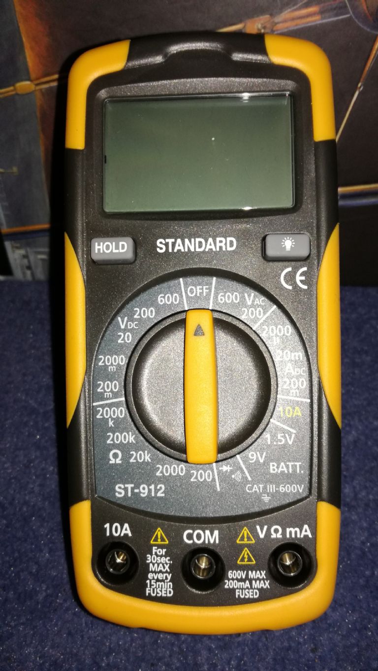

Hi Robert, I'm not disagreeing with you, however this brand new meter from CPC that I have, it states the fuses as being 250V fast blowing, which has been factory fitted with glass ones.
The instructions for my UNI-T say they must be glass fuse 250V fast type.
So have both of these manufacturers got it wrong?

Hi Nick,
Yes, either inadvertently or by deception, I can't tell which, they are claiming compliance with CAT standards that they cannot meet.
This may be because they misguidedly do their own analysis of compliance and get it wrong. Even Fluke don't do this, they send their meters for independent verification.
The requirement is that applying a high energy source at the maximum rated voltage to ANY combination of inputs in ALL switch positions will not cause a hazard. A hazard includes shock, sparks or explosion. The amount of energy appiled goes up with the CAT rating number even if the voltage is the same. This is bsed on the FAULT current the supply it is intended to be used on can supply. This can be thousands of amps.
There are two things to note:
1/ This is for protection against spikes or surges on the supply or mis-application of the meter.
2/ The meter does not have to work after the test.
It can be seen that unless there is a problem with the powersupply or the meter is mis-used not having a fully complinat meter has no effect. It's only when something goes wrong that you will find out the the meter is deficient in it's protction. By then of course it is too late.
The big issue is that there is no enforcement of compliance. Trading standards don't have a buget to send meters for testing.

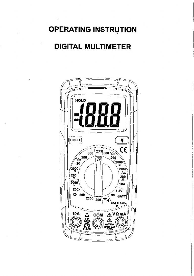

Hi Robert, for your information, this is the card that was in the packet that my new multimeter came in, which claims it's conformance of EN61010-1 CAT III. All I can do is accept what it says.
Regards Nick.
Edited By Nicholas Farr on 12/09/2021 13:44:31
Hi Nick, I assume that paperwork came with t "STANDARD" ST913 in your earlier picture. If that is the case I can say it is incorrect just from your picture. Theis is because there is no CAT rating next to the input terminals.
Additionally the paperwork does not reference a model number and the make of the meter in the picture does not ppear to be STANDARD. If you read the link I posted earlier there are ots of meters that dont meet the declared CAT standard. Did the suppliers catalog or web listing actually state it was CAT III 600V?
Likewise your UNI-T UT61 is non compliant because the rating has only been appled to the Volts/ Ohms terminals. A meter has to pass on ALL inputs and functions to be compliant. Current ranges are harder than voltage to make compliant.
Manufacturers and suppliers make all sorts of incorrect or plain fradulent claims.
Robert G8RPI

Hi Robert, this is the one that I purchased from CPC/Farnell.com TEN01061
This is the front page of the instructions, it doesn't have the standard or the ST-912 printed, but all the specifications printed inside match what is stated on the front of the meter.
The test leads supplied have CAT III 1000V CAT IV 600V and also the CE and the double insulation symbol and 10A with the Earth symbol, moulded into both of the probes.
Regards Nick.
