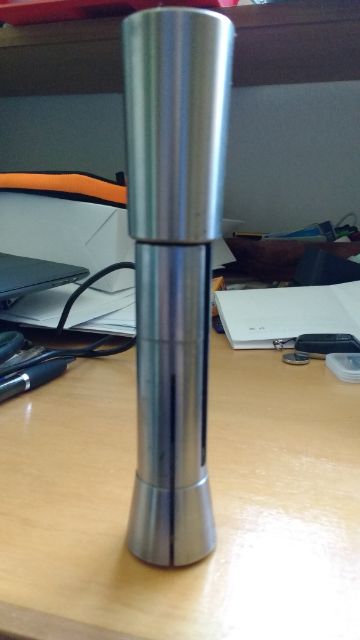

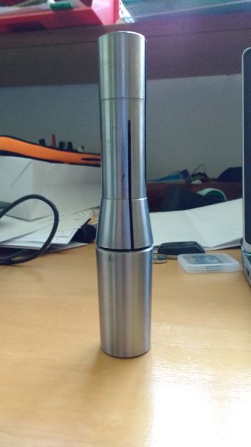

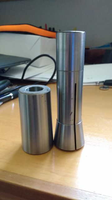

                John Haine
                  @johnhaine32865
                  I've got MT4 in my Super 7, R8 on my mill. I took some quick photos to compare the taper of an R8 collet with the MT4/MT3 adapter (which is of course larger than MT3.
                  I think you can see that there's no way to make an MT3 to R8 adapter that will fit inside the spindle and you would end up with an overhang probably the full length of the R8 collet.
