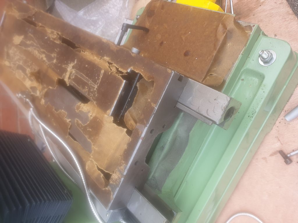

                                              Hello all
                                              I've taken the plunge and purchased the GH Universal. With much help you you all, especially howardt, i felt confident the move could be done.
                                              Now the mill is in my drive, and its a beast! I've managed to get the head off, but am stuck on something much less daunting (at first sight) – removal of the table. I've managed to remove the feed screw, but the table seems nearly immovable left to right without being aided by the screw. I've removed the gib screw adjusters but that didn't help. Do I need to remove the gib strip? There are two screws / plugs on either side of the table that look to keep this in place, but – if I need to remove the strip – how do I do this with the table in place? Is it a case of knocking it out with the assistance of a hammer / something narrow that can hit the side of the strip? Id really appreciate your help guys, I think I'm up against it with this one and the weather and its already spent a night in my drive without the head!
                                              Thanks!!
                                              #534832
                                              Jak2g
                                                @jak2g
                                                #534838
                                                  looks like a taper gib, try sliding the table off in the opposite direction as one way will tighten the strip and the other make it looser
                                                  If not a brass drift on the SMALL end of the strip should move it.
                                                  #534840
                                                  HOWARDT
                                                    @howardt
                                                    The gib once loosened should simply slide out. Make sure you have loosened the gib lock screws.
                                                    #534843
                                                    Jak2g
                                                      @jak2g
                                                      Posted by JasonB on 19/03/2021 09:41:31:
                                                      Tried that but unfortunately didn't make a difference. The table is quite tight / stiff even when using the screw.
