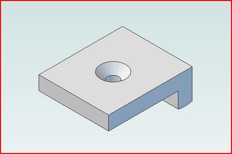

        One slight improvement to John Shepherd's clamp would be to CSK the hole and use a CSK socket head screw, this would give you a bit more room for things on the table and also allow the clamping pressure from the screw to be nearer the rotary table. Use a cut down allen key to tighten

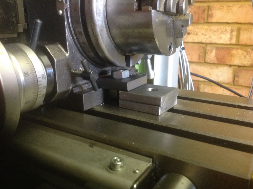

                  Like John Shepherd, I use a similar arrangement on the "business" side of the RT and an ordinary, heavy duty clamp on the back. See photo, below. For scale, the stud/nut are 10mmØ and the plates are roughly hewn from 8mm x 40mm black steel from the local B&Q. I've milled a slight step in the lower face of the clamping plate. Clearances are tight, but sufficient, unless there is overhang of the table. It looks, from your first picture, that yours is a smaller mill than my VMC, so you will presumably use smaller clamping bolts or studs, which, in turn, will provide you with increased clearance.

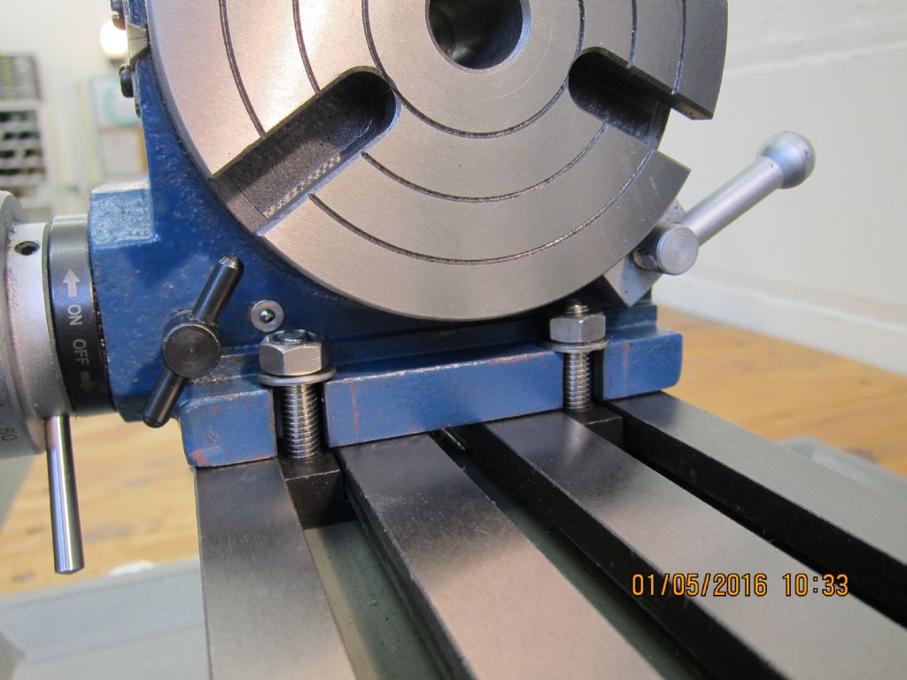

                    John, I think mine is smaller with less clearance and I've decided to go for what I think is the best solution in terms of a solid fixing, milling slots at the front with a clamp at the back, this gives a very firm setup and clears the locking screw and oiler – see photo. The downside is that the slots are suited only to my mill table, but I can live with that. Thanks for your interest and suggestion. Chrisimg_1127.jpgt

                      Chris,
                      Nice, elegant solution. Well done! I think there's not enough meat on the RT base for me to do the same, but I've had a sideways think and I might try making a Y-shaped clamp, the arms straddling either side of the table and the "leg" resting on the pillar. Goodness knows when I'll get around to trying it, though.
                      #237424
                        Excellent decision, Chris, and neatly done.
