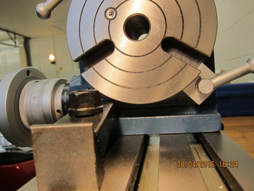

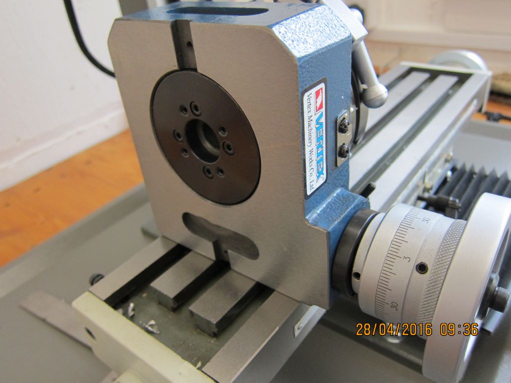

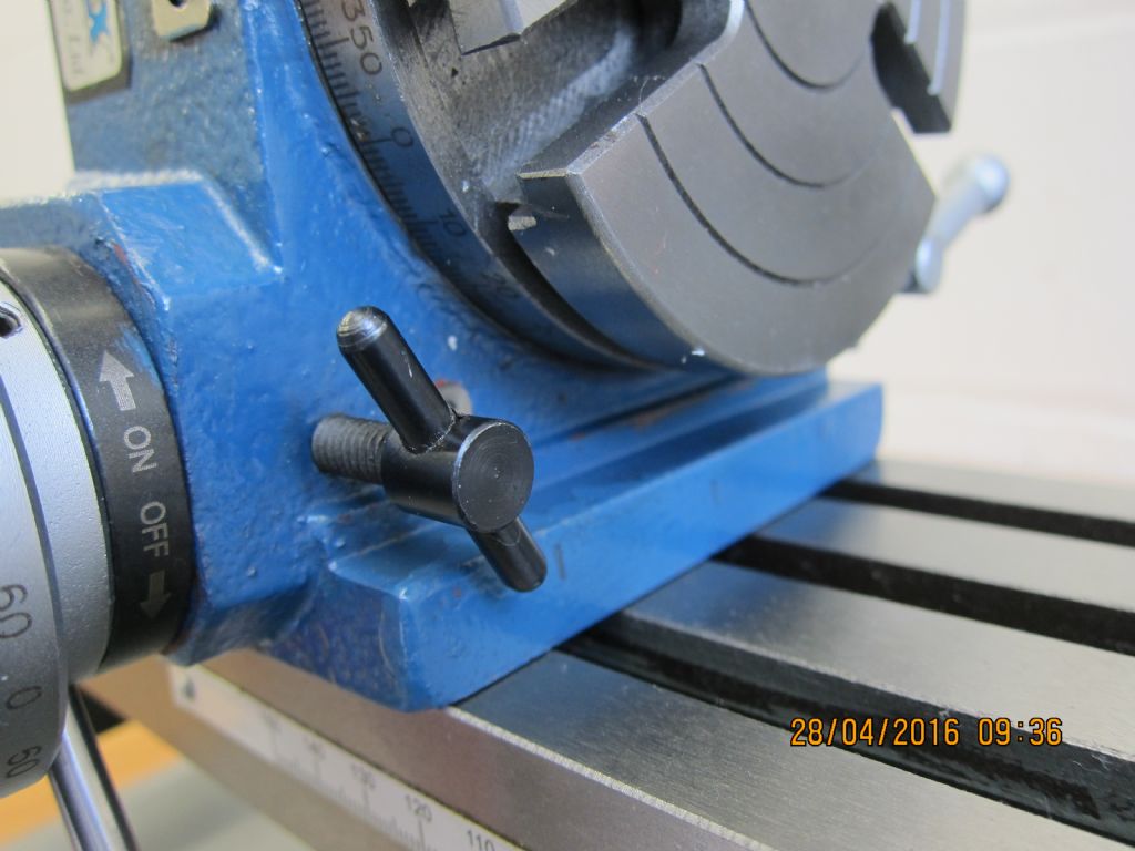

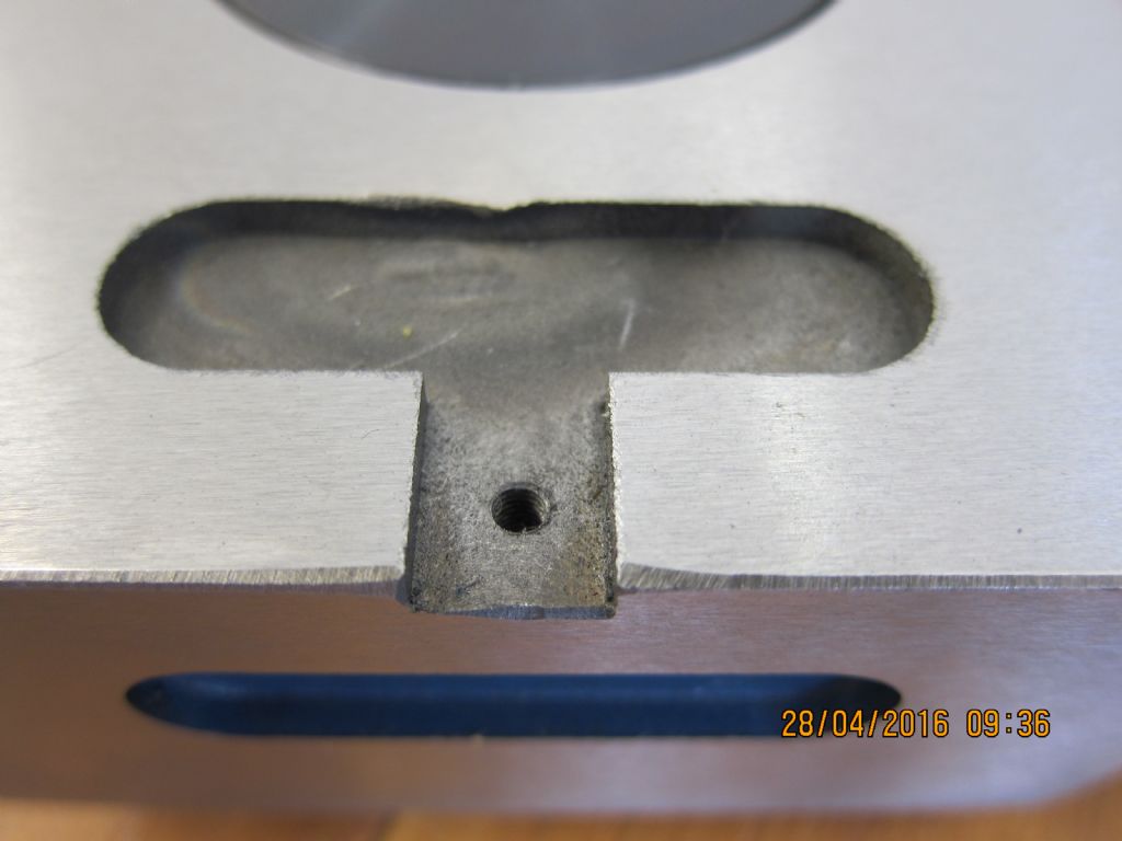

      Hello, I've recently bought a Vertex HHV 100 rotary table specifically to set up for cutting small gears on my small milling machine. The table has two ground faces to enable the spindle to be set vertically or horizontally and obviously I need it to be horizontal with the spindle parallel to the table. It can be fixed with the spindle vertical using clamps inserted into the oval slots, but I cannot see an obvious way of fixing it horizontally without milling slots in the lip on the front edge, see photo which seems drastic on a new machine.
      Front
      At the back of the casting, machined into the surface there are slots with tapped holes that may be something to do with clamping, but so far, the supplier can't tell me anything about them….
      Slot
      There's not enough room to clamp at the front below the chuck, so I am at a bit of a loss, can anyone advise?
      Rear

          Hi, I am just about to do the same job on my mill with a 6" rotary table, cutting wheels for my clock. I put a large angle plate on the left side to stop the table moving and on the right side 2 clamps which were held by the t slots and then clamped to the small flange on the bottom of the rotary table, it all worked ok. my table had a 4" chuck mounted onto it to hold a mounting plate so there was a bit more weight which helped it all stay still. I will try to put up some pictures later to show. I have a stepper motor driving the table to give all the divisions any body needs.

            The slots in the base are for fitting tenons. These are to locate it in a slot on a table.
            **LINK**
            I think you need to clamp it using long studs and tall packers to apply pressure on what is the top face when set up as shown in your picture.

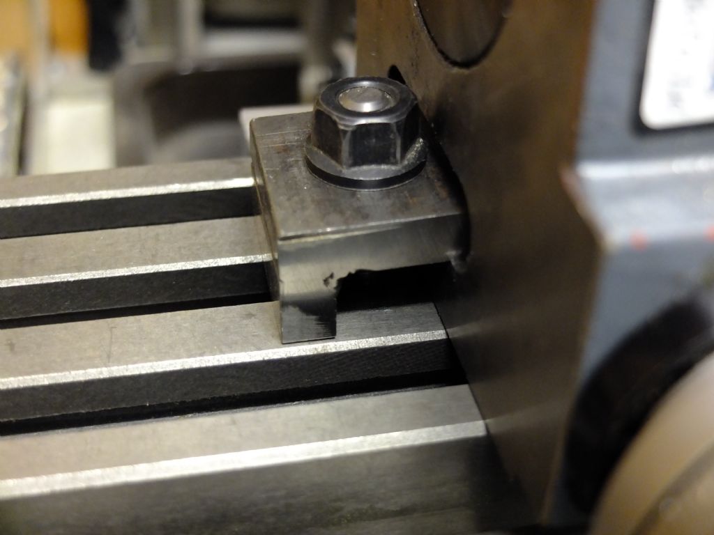

                Chris>>

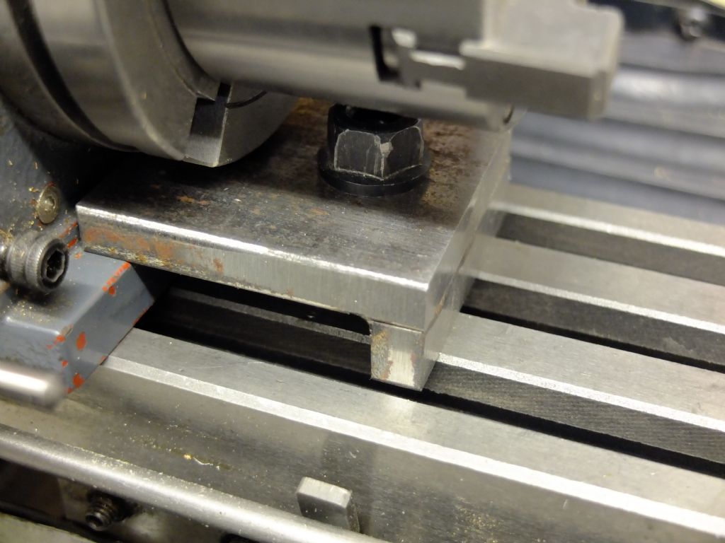

                Here is my solution for what it is worth. I also have another short version of the clamp like the one used on the rear for when the chuck is not in use. They work for both vertical and horizontal mounting.>>

                Vic
                  @vic
                  That looks like a threaded hole in your second picture Chris. Perhaps you could mill up a suitable "foot" to bolt in there? You could then put a clamp on it. Also, have you had a look at the Vertex website, perhaps they picture something?

                    Vic
                    That hole is only 4mm so useless for any form of clamping, it is useful for attaching alignment guides though.

                      John, those 2 special made clamps for the rotary table look fab. I shall have to make some for myself now, saves lots of set up time.

                        Thanks everyone, the problem is really the small size of the rotary table, I have tried standard clamps by there is no room on the front face and with a chuck fitted there will be less. I've taken another couple of pictures to show this:
                        It looks like John's suggestion of special clamps or milling slots will be the best solutions, I can find nothing on the Vertex site. I would be interested to know what the nornal use of tenons would be

                                            Chris, the idea behind the use of tenons is that you can fit a vice or rotary table to a slotted machine table and it will be aligned to the slots without having to be dialled in. The accuracy depends on the state of the slots in both the vice/rt and the machine and how well the tenons fit the slots.

                                                I think John Shepherd's special clamp solution is the answer, provided I can get a substantial enough one below the chuck, if not, it will be a clamp at the back and milling slots at the front. Martin – thanks for the info on tenons, and thanks to everyone else for their interest and advice – this is my first post on the forum – what a great introduction!

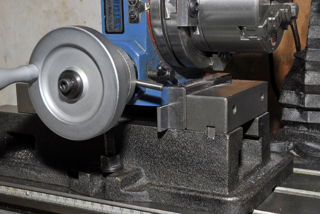

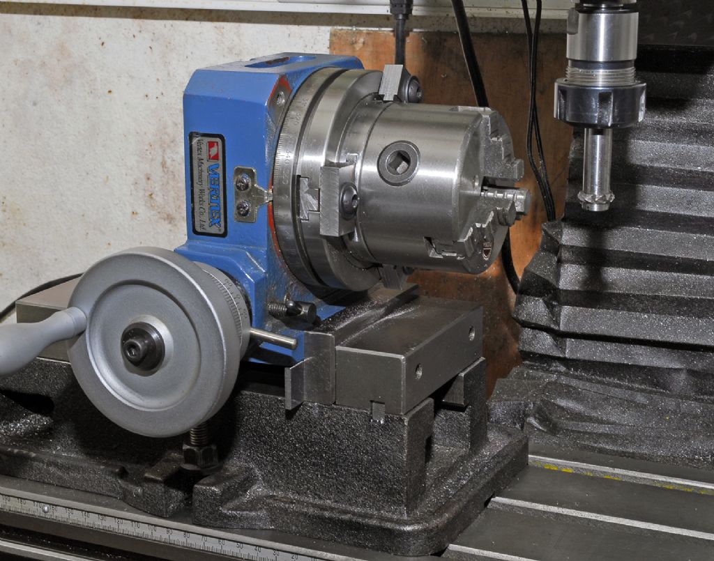

                                                Ed Duffner
                                                  @edduffner79357
                                                  I've been using my RT in this orientation and found I could clamp it in the milling vice and resting on parallels. Not sure if you have a milling vice Chris?
                                                  Warco WM-16 + VA4 + HV4
                                                  Although I know I have been using the RT incorrectly, ie not using the clamps whilst taking a cut and relying on the forward take-up of the worm, I have noticed that with one clamp tightened it throws the runout by about 0.1mm, so it's best to use both in a proper situation.
