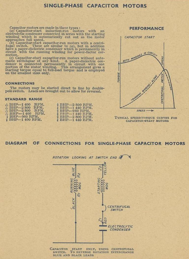

                      Hi, capacitor-start motors need a switch to cut the capacitor and start winding out when the motor has reach full speed. This is also normally done with a centrifugal switch on the rotor.
                      A split-phase motor or a capacitor motor will run without the start winding in circuit, if is is spun during start up, it will run in which ever direction it is spun in. Once these motors are running, the start winding or any capacitor play no further part.
                      Below is a scan of single-phase capacitor motors.
                      Hope this helps.
                      Regards Nick.

                          Hi Alan, you will probably find that the start winding is the one with the higher DC resistance. The best way to check which is which, is with a low voltage AC supply, say 12V @ 0.5 amps. Apply the voltage across each winding in turn with an ammeter in the circuit and a volt meter across the windings, the start winding should take the most current and have a lower voltage across the windings.
                          It’s all to do with reactance and inductance stuff in AC circuits. The running winding has a higher inductance than the start winding and will draw less current than the start winding. In contrast the start winding will have a lower inductance and will draw a high current during start up, which has to be switched off when up to speed, or it will overheat.
