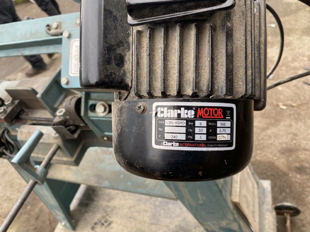

      I have a Clarke 6" band sawthat I use for cutting metal
      Last night the blade James and burned the motor out
      So I need a new motor however I would like to prevent this happening g again.
      Any suggestion what I could do?
      And before you say it, yes don't leave it running on its own

          You need a Direct Online Starter, rated to suit the full load amps as stated on the data plate ! Good ones are not cheap. On getting one it has to be set to the current rating for the motor. Fla = 2.8A You need a 2-4A unit set to 2.8A. A fuse WILL NOT help in this application. If buying secondhand check that the coil voltage is 240V not 415V. Good Luck Noel.

                  Not much info on the motor plate

                            Motor speed is 1450 shaft size 15.9mm

                                  The motor is 1hp

                                    The motor in the photo is labelled as 500 watts, that equates to .75 hp not 1 hp. Dave W
                                    #583674
                                    noel shelley
                                      @noelshelley55608
                                      Confusion between Ph 1 and Hp ? Noel.
                                      #583678
                                      petro1head
                                        @petro1head
                                        Posted by Samsaranda on 02/02/2022 19:53:15:
                                        What equation did you use?
                                        #583680
                                        Pete Rimmer
                                          @peterimmer30576
                                          HP = KW x 1.341 so a 500w motor is equivalent to about 0.67hp
                                          #583720
                                          petro1head
                                            @petro1head
                                            I think the confusion is its says pH 1. which is phase not hp. my pal has the same saw and his is 350w

                                              I expect this is likely an imperial motor. Actually 15.87mm? 5/8”?
                                              How mm might spec their motors is debatable  and possibly misleading. That 500W may be gross consumption, not real horse power delivered. That may make it only 1/2HP (or even less!).
                                              Ignore the temptation to fit a more powerful motor.  That is not a sensible option.  Something else would break or the motor would still burn out if/when a jam occurs.  Running improperly tensioned belts is just plain ridiculous.
                                              Fitting an overload cut-out is the way to go.  A fuse that would blow with a stall would likely blow when starting the motor.
                                              Follow the sensible suggestions, particularly that of the proper electricians.
                                              The post by Noel was all that you required.  Follow that advice.

                                                The motor plate says it's rated 240V and 2.5A which must be the input, about 660W. Therefore 500W is most likely the power output, and 76% efficiency is reasonable for this type of motor.
                                                500W is ⅔HP, not that anyone has any idea how long it takes a horse to cut a given quantity of wood!
                                                I agree it's generally inadvisable to fit machines with much bigger motors. Many negative effects keen bodgers might not notice, such as rapid wear. We rarely know what parameters a machine's designer worked to, but to keep costs down it's likely the frame is sized to match the motor. A big motor could flex the frame enough for a saw to cut inaccurately…
