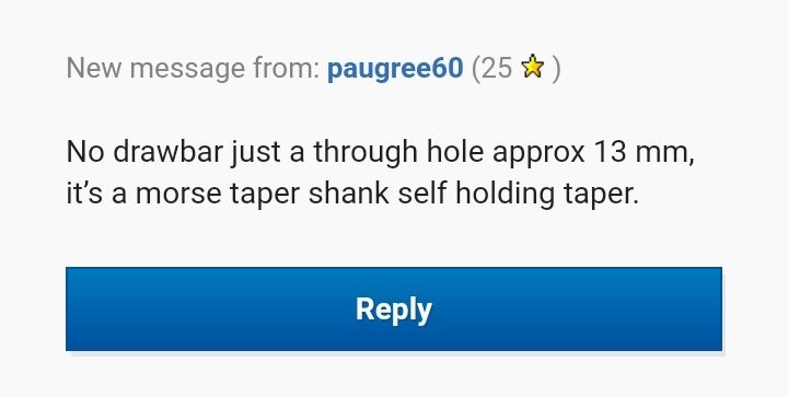

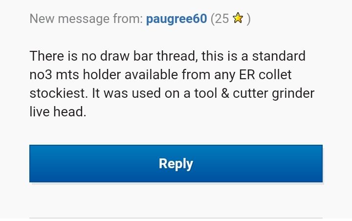

                            A few days ago I was bidding on a mt3 er32 collet chuck and collets, as the bids went up, i thought i better check it has a metric thread, so I sent the seller a msg asking this.
                            Below, a picture of the items i was bidding on, the sellers response to my first question, and the sellers response to my second question, which was, 'there should be a female thread inside'
                            The reply left me completely confused.
                            It has added those replies in wrong order, this website must have been designed for PC use, it's impossible to manipulate certain things from a tablet.

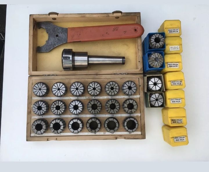

                            #470250
                            Pete.
                              @pete-2
                              This is the items in question.

                                He says it was used on a tool n cutter grinder. Light load so no draw bar facility. So not suitable for a mill, where drawbar is needed.

                                  What confused me was, he said it was the same as every commonly available mt collet chuck, I've never seen one for sale without a drawbar thread? I wasn't questioning his use, but the 'standard' collet chuck with no thread for a drawbar.

                                    Posted by Pete. on 09/05/2020 01:47:16:
                                    Technically, I suppose it is true to say that the collet chuck is standard ER32
                                    But the Morse Taper shank which supports it is not threaded for a drawbar.
                                    The statement was probably perfectly clear in his mind :
                                    The English language is sometimes difficult to use unambiguously.

                                      not done it yet
                                        @notdoneityet
                                        I’ve yet to come across a MT taper without either a tang or a thread for a drawbar. They say you learn something new every day!
                                        If it came with no thread, I suspect it came with the collets in the yellow packages.🙂 So I wouldn’t want to rely on that chuck being to specification.🙂
