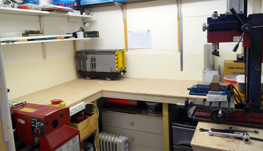

                                  Well I,ve changed workshops and moved in, its nice to have a bit more space and even nicer to have far more bench area. Still got bit of sorting to do under the benches and stuff to junk plus the electrics need moving around. I changed my mind re the position of the mill and lathe, placing the mill on the right hand bench as you enter and the lathe fitted nicely on a narrow bench to the left. This has left as much bench space as possible, still got to fit the vice and the back wall can take another shelf. So a bit more to do and I can get back to some engineering.

                                    Looks a very neat and tidy set up Ron. I could never keep it that clean.

                                      Just moved in Plasma, I doubt it will look like this for long.

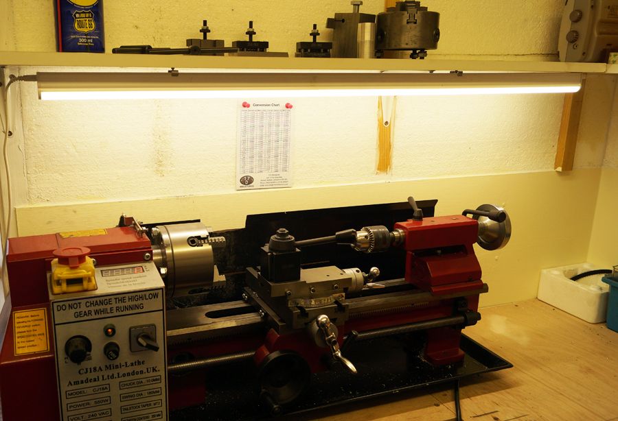

                                              LED strip lights: I know I have mentioned them before but seeing as I just put up a small shelf above the lathe with a light fitted to the underside I thought it may be worth another mention should anyone be interested.
                                              The lights are from Screwfix and supplied for lighting cupboards/cabinets etc. They are LED, 3ft long (range of sizes) cost £14 and come with a pair of mounting clips and a 20 inch connecting lead to connect one light to another end to end. Maximum 8 lights (I think) and the good thing is you only need to power the first light and the rest run in series via the supplied connection lead, good if you need to light a long bench or around a work area or dark corner.
                                              The picture doesnt show it that clear but one mounted above the lathe really does light up the length of the machine which I prefer over a single spot light or similar.

                                                I can support that way of lighting the machine.
                                                I fitted an l.e.d. array strip to the white-board shelf above the Myford lathe. The lamp came as two units you can connect by a short flexible lead (supplied), so I fitted them overlapped a few inches, to fit the full length.
                                                Plus a tubular l.e.d. lamp to underside of the upper of two narrow shelves above the Harrison lathe.
                                                However I found a disadvantage to the lights being as open as in your photo, in my workshop. The lights are slightly above my eye-height but were still shining at me, so I screwed a narrow edging-strip to the shelf edges to shade them without any noticeable effect on the machine illumination.
                                                While I was at it, I added a steel sheet (part of a scrapped server case) to the lower shelf above the Harrison, to keep the swarf in the chip-tray. It extends to slightly below the rim of the tray but without touching it anywhere, so it can't resonate. The Myford makes do for the moment with an offcut of building insulation-board standing in the tray and propped against the wall.

                                                  That's a nice and cheap way to put some light over your lathe. I have a fluorescent lamp over my lathe and an anglepoise LED lamp with a magnifying glass, a necessity for my old eyes.

                                                    Looks great Ron, a good move in more ways than one!
                                                    I'm very impressed with the LED lighting as my part of the garage is in need of more light I'll be investigating them so thank for the heads up on those…
